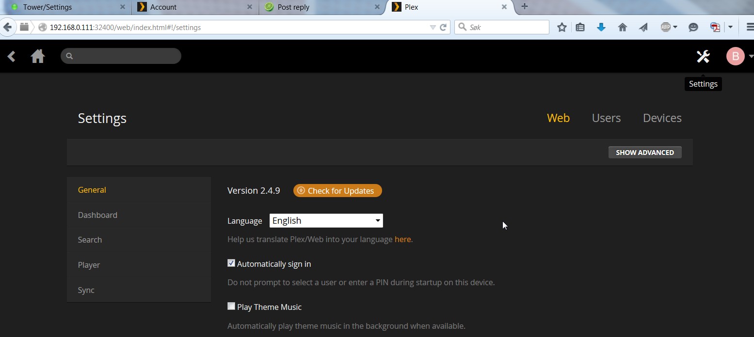

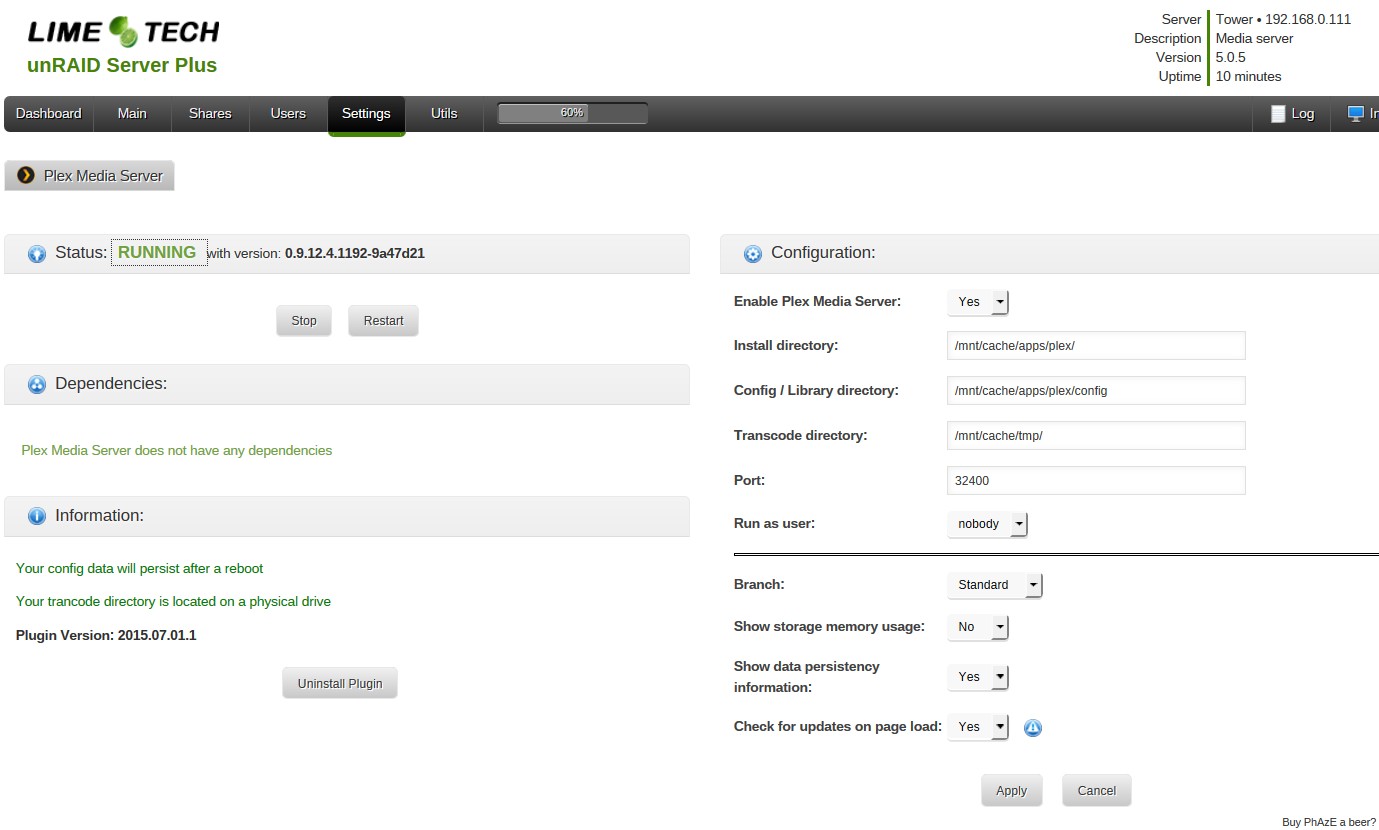

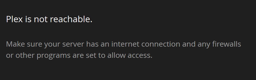

July 18, 201511 yr Hi, I have plex running on my server, but now I can't get it to connect. I have had it up and running for a long time, so not sure what is wrong. Plex is not reachable. Make sure your server has an internet connection and any firewalls or other programs are set to allow access. I have port 32400 open in my router to the server-ip. I also, after installing the newest Phaze plugin, also forwarded port 80, and changing the web-gui port of my unraid to something else. Still no luck. I see my friends share there, and I use the direct link to the server.. "192.168.x.x:32400" when trying to check the settings, but now I can not log in Hope some unraid/plex guru here can help me

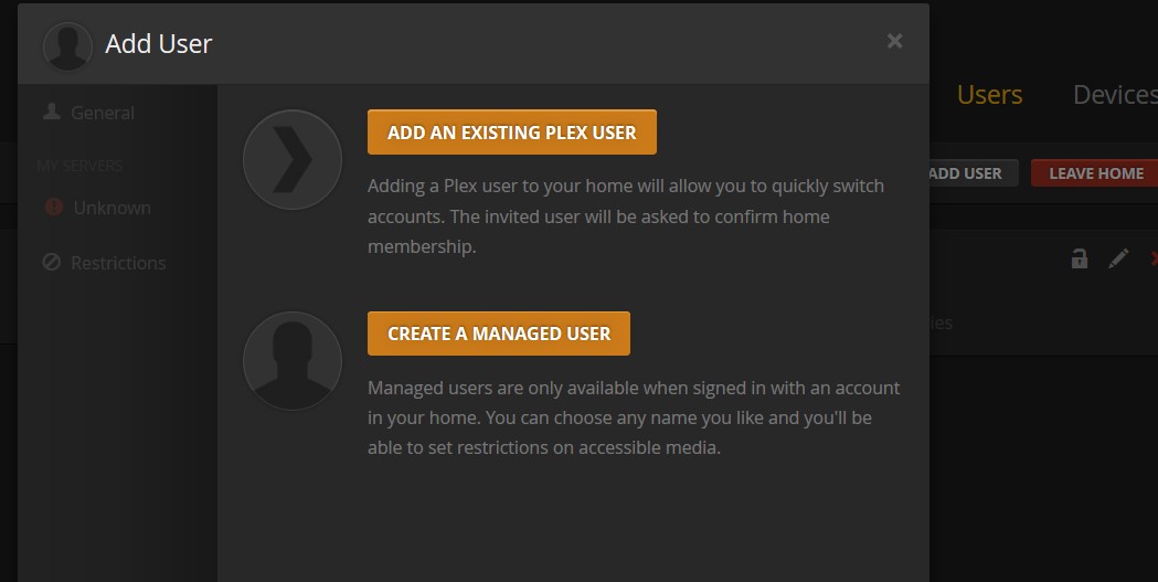

July 18, 201511 yr Author Now that Plex.tv is online again, I changed password, and home-pin. Still, the server-option is not shown... Now I am lost.. can't find the option to publish my server.. When i push "add user" I can see that there is no server in the greyed out area, and only a "not availible" sign there... Edit: I also can connect with my phone on 3G/4G (in other words, I am not connected to my local lan) and I see my plex, but no server-option, just "web users devices"
