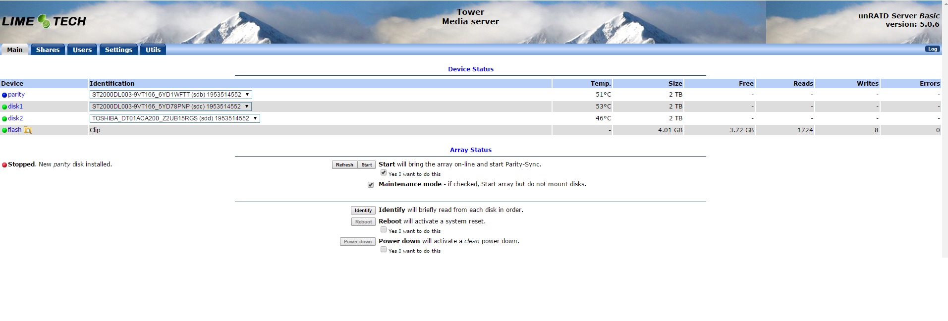

I experienced a power loss this morning, and when I went to restart my raid several hours later I noticed the parity drive color is blue and the message "Start will bring the array on-line and start Parity-Sync." appeared.  My understanding is UnRAID thinks the parity drive is new so it is going to rebuild the parity-sync. Is this accurate? This seems risky and rebuilding the entire cache is not desired obviously. Are there any other options?

I had completed a parity sync; its been running solid for a few years.
do a New Config and ONLY assign your data disks to the array => then confirm you can see your files okay
Whats the best way to do a new config?
Thanks!
In v5 go to the Utils tab and select New Config.
