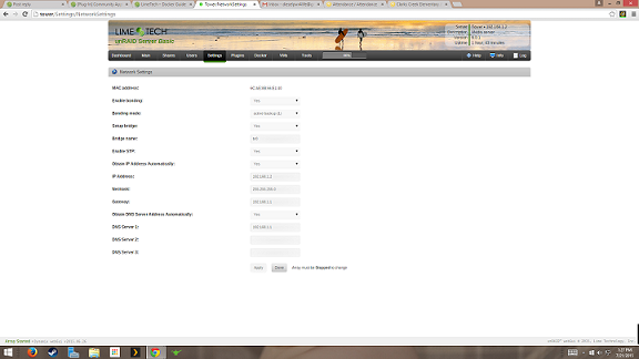

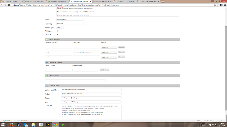

July 21, 201511 yr Author I've attached an image of my config for Needo's Plex Docker and my network settings.

July 21, 201511 yr Author I don't really have a place I can upload them to so I can just link to them, so I'm stuck with a 192k limit this forum puts on the total picture size, sorry. My Network settings are as follows: Bonding: Enabled (two cables are plugged in) Bonding Mode: Active-backup(1) Setup Bridge: Yes Bridge Name: br0 Stp: Enabled IP and DNS are all set to configure automatically. Docker is configured to a 147 GB 15k SAS drive, /mnt/disk1/docker.img. Size is 20gb Plex Docker settings are as follows: Container Page: https://registry.hub.docker.com/u/needo/plex Name:PlexMediaServer Network Type: Host Volume Mappings: /config /mnt/user/appdata/plexmediaserver Read/Write Access set /Movies /mnt/user/Movies Read/Write Access set The only thing I changed from the default settings was adding the /Movies mapping. I am not sure really what the issue is. Let me know if there is any more specific information I can get to make diagnosis easier for anyone looking at this. Thanks *edit* I don't have a cache drive/pool at all. Just 4 sas drives for now, all set up as pooled storage.
