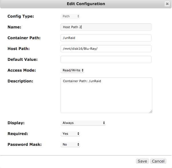

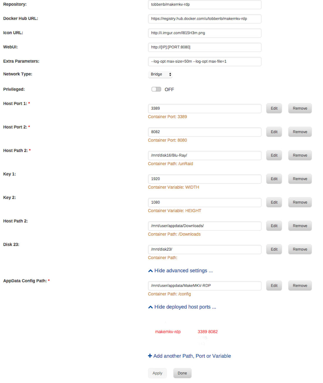

I don't know what you mean by Docker run command but here is a screenshot of my MakeMKV Settings

You have not specified a container path for disk23.
If you are trying to rip directly to a disk share, could you try instead to rip to a user share?
I will do that but the problem is ripping to a share, Disk16/Blu-Ray/, with SMB Security Settings at Secure.

Your problem is that you don't have any disk16. So change the volume mapping to a disk that exist and it should work.
I don't have a Disk 16?

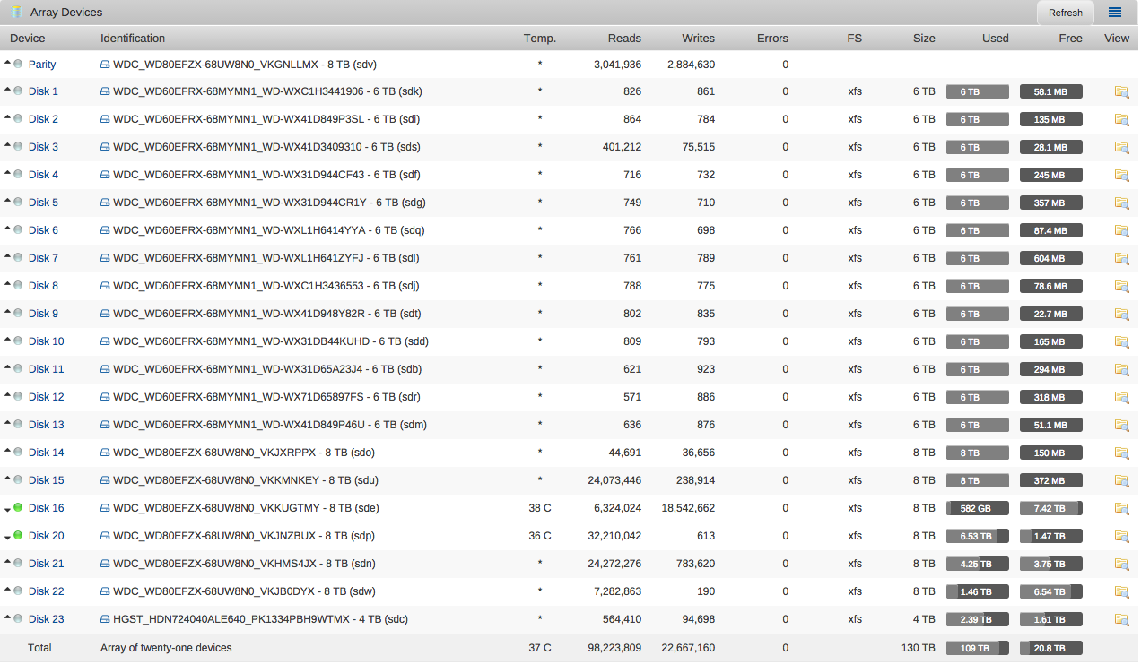

There are problems with your disk 16.
Feb  4 12:33:17 unRAID kernel: Buffer I/O error on dev md16, logical block 1953506608, async page read
Did you just recently add it to unraid and did not preclear it in anyway? That's how it looks anyway.
I'm not sure what the problem is, but it's not related to makemkv as far as I can see. It might be a disk problem or a permission problem.

Your cache drive has noting to do with it. Do you have an optical drive? If not remove the entry in the extra parameters box. If you have one, then look in your device list to find out the path.
I do not have any optical drive. I simply have my array of HDDs and an SSD for a cache drive. So you're saying just blank out this line? Why would this docker assume I have some sort of optical drive when I have never had one? Just because I'm curious in future docker installations.
EDIT: It worked after blanking out the additional parameters line. I'm just curious why it filled this out like that to begin with when I have no optical drive. Is it just the nature of MakeMKV that many people would use this with the actual disk instead of an ISO of BDMV index file? Or should I always check that when installing a docker? Also, where is my "device list" you mentioned?
