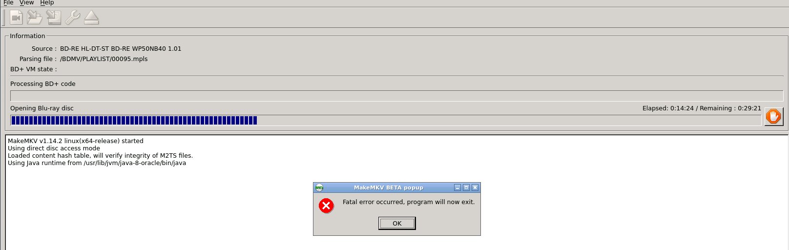

Hello Everyone.
I have installed the MakeMKV-RDP Docker everything shows up like it should but when i run the application and MakeMKV starts processing the Blu-Ray i get a Fatal Error Occurred, Program will now exit. I am wondering if any one has seen this issue or know to resolve it?  from the main screen looks like a Java issue. I am running Unraid 6.6.6.
Thank you for all the help.
11 hours ago, ok4ayl said:
Hello Everyone.
I think there are some issues with specific disc's and Java. I think it's a makemkv issue. I know @Djoss did some work on his container and was in contact with the makemkv author about it, but don't remember if there was a solution.
Try his container and see if it works.

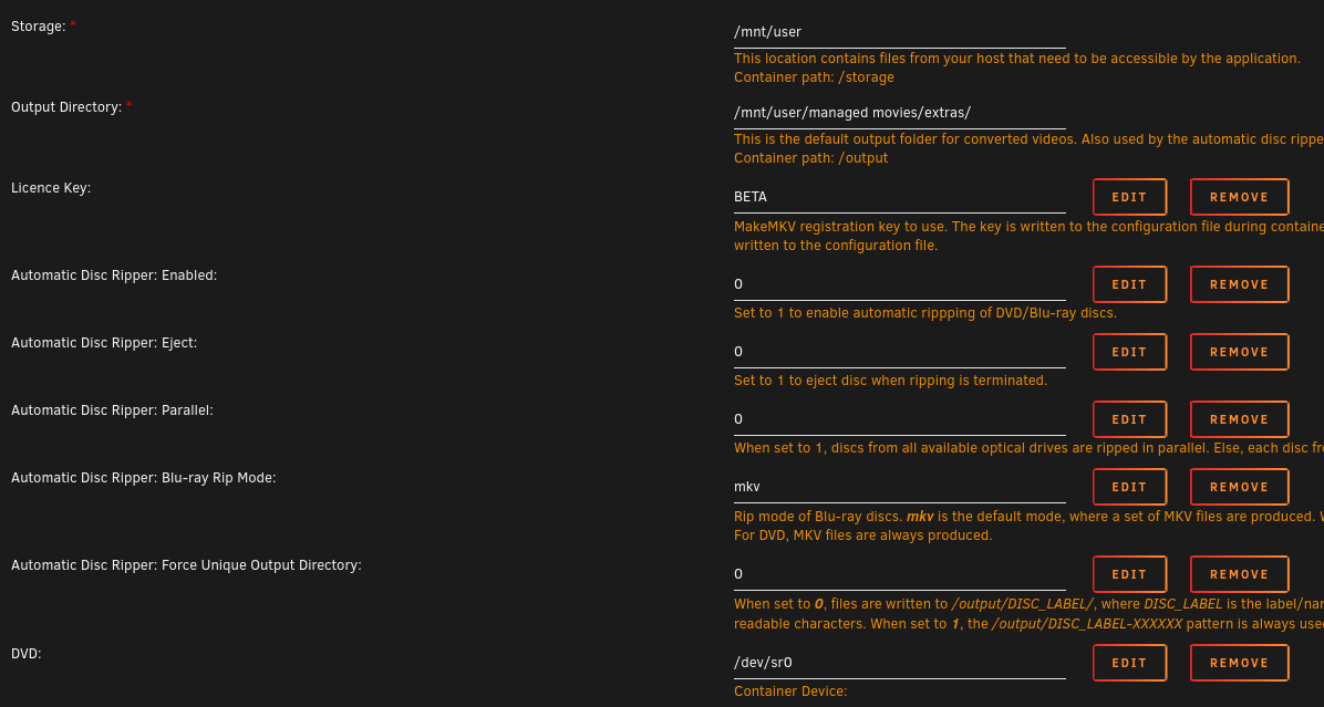

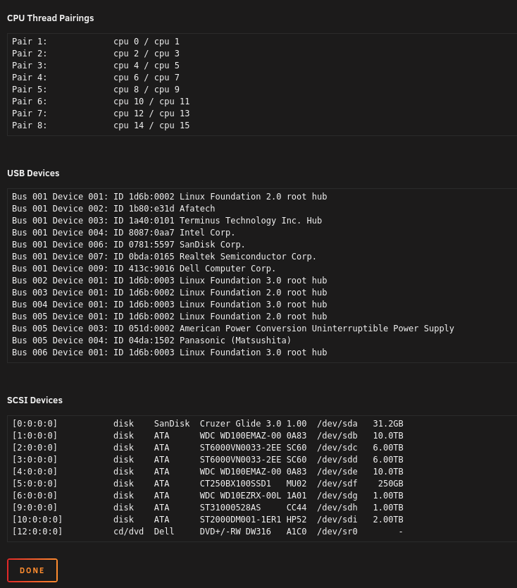

I'm not quite sure what I'm supposed to do. My USB DVD player was attached to a USB hub and to the motherboard, and not working, getting the the "The program can't find any usable optical drives." I'm on version 6.6.6.
1872233832_Screenshot2019-02-04at11_24_55.thumb.png.f4552b9a4e627506588de89c1c9e4ad9.png1895119397_Screenshot2019-02-04at11_25_32.thumb.png.4b1e211a5cea0773037e716a1ddcc780.png
I did try adding device and /dev/sg0 like mentioned before, and the container wouldn't start, giving error message.
Looks like you are using djoss's makemkv container, so wrong support thread.
By the look of it, you have only added one of the device names. You need both the /dev/sgX and /dev/srX.
