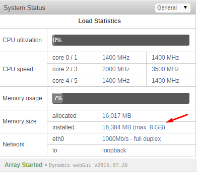

Just updated to 6.1-rc2 and the "Info" popup is right but still wrong on dashboard page.
Info popup:
Memory: 16384 MB (max. installable capacity 16 GB)*
pic for dashboard...
Info popup:
Correction also made for dashboard, thanks for reporting.
