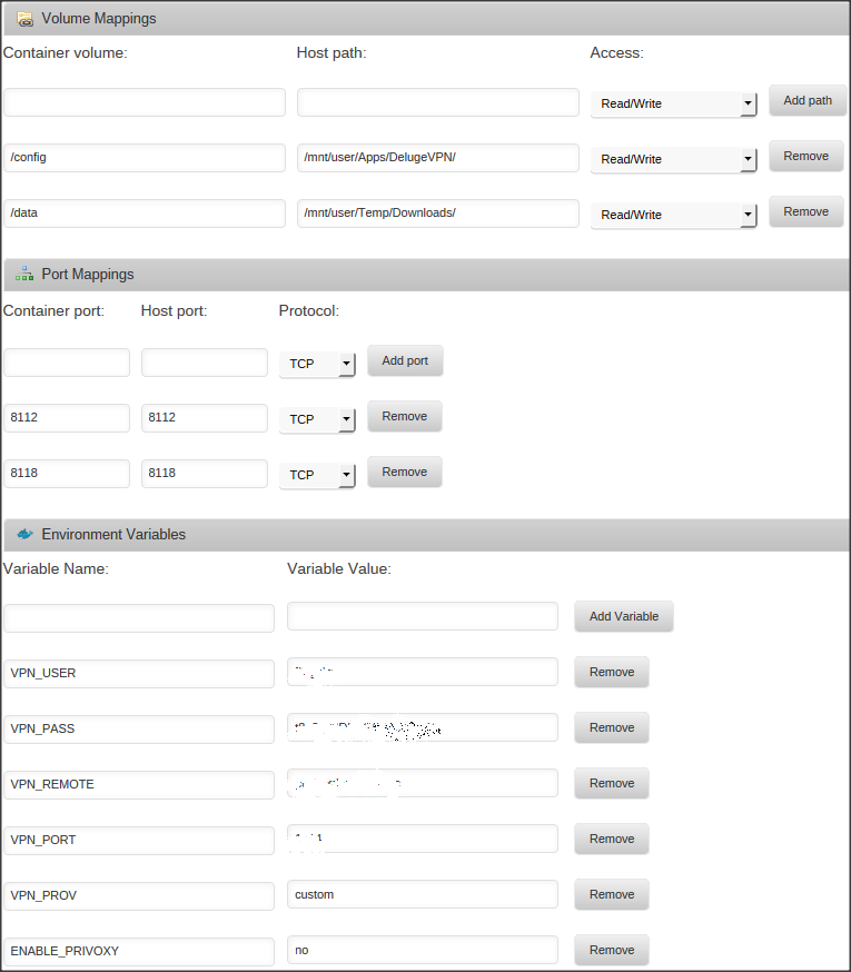

Your assumption for the use of Data and the Config mappings is correct. Have a look on my setup for DelugeVPN.
The mapping for
/config
is
/mnt/user/Apps/DelugeVPN/
and is pointing at a share named Apps on my cache drive that has a sub folder DelugeVPN that contains the configuration files for Deluge as well as my VPN parameters for my VPN provider.
The mapping for
/data
is
/mnt/user/Temp/Downloads/
and is pointing at a share named Temp on my array and a sub folder Downloads that is where Deluge store my downloads. In order for Deluge to store downloads there you need to go to Preferences (in Deluge) and set Download to:
/data
, this way it is stored where it should be and not inside the container!
