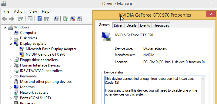

Got a step further... in addition to my GPU, also a generic display adapter shows up under the device manager, although I am not passing anything through besides my GTX.
When I disable the generic display adapter and reboot, the GPU goes from an error 43 to error 12: this device can find enough free resources ?! Anyone a clue how to resolve this?
I disables as much as I can under hardware. The only options I had was to disable the cd-roms...
Problem status is reporting: Conflicting Address Range. The specified address range conflicts with the address space.

Please share your xml.
Sure no problem:

Looks like you have been playing manually here, I'd recommend against that.
You have both VNC and a passthrough GPU assigned to the VM, which is not supported and in general a bad idea.
However, you also don't have any input devices defined to control the VM once you remove the VNC part.
So as much as my edits below may help you, you won't be able to DO anything but see a pretty picture.
I would delete this VM, but not the image.
Add VM from the editor.
Set CPU/resources (ram) as you prefer.
Map the disk image you already have for this VM.
No need to map virtio, or install path.
Select your GPU, and sound card (I'd assume you'd want this, it is not in your XML now).
Select a USB devices or two for keyboard/mouse.
Start VM
You should be good!
Manually this looks to be your issues, but note you will have no way to control it without USB peripheral.

The problem was indeed having both vnc with an additional GPU. Removed VNC and all is working. As for the original post, i am still having the Uefi boot problem. But hey, got everything working with Seabios.
