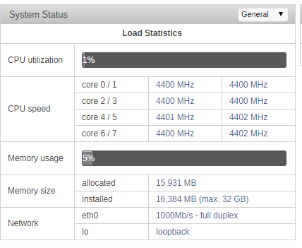

So, I figured a few things out that may be helpful to others.
I actually turned IMMU and all virt settings back on without issues.  The problem did end up being both sata add-on cards in combination with virt on.  On the new Mobo ( GA-Z97X-UD5H-BK) with the i7-4790k Devils Canyon CPU, my old PCI sata cards with cause these hangs every single time and sometimes system crashes.  I tried both cards independently while only hooking up one drive and would still get the issues.  Since these cards are so old and only support 3.0Gbs it was probably time for an upgrade anyway.

I am currently rebuilding parity and only have 1.5 hours left.  In the meantime, I thought I would brag about my new system. :)
Before I was running anywhere from 70-100% cpu load depending on if the server was sitting idle.
Memory (2gb) was around 60% when idle and 100% when doing anything of note.
Check out this screenshot of the new system. :)
