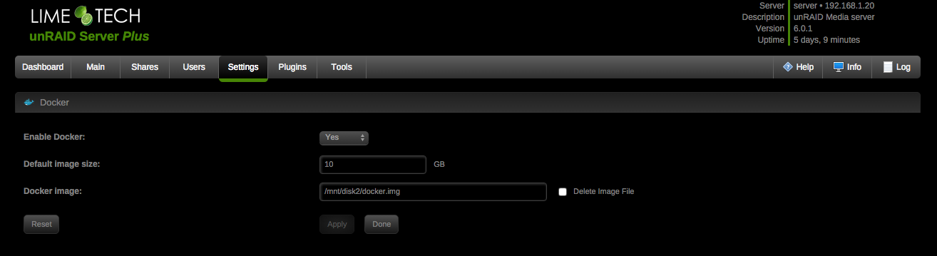

July 30, 201511 yr Hi! After a power failure at home and the unRAID server restarted, my dock is missing. I had Plex, logitech media server with spotify and some more working. I'm running the latest 6.01 version, payed version up to 7 disks. Under settings-dock, it says yes that i have docker enabled. But no apps shows. Can someone understand why by checking my log? Very thankfull if i could get docker working again, my music in the house needs logitech to work (using squeezeboxes). Attaching syslog. syslog.txt

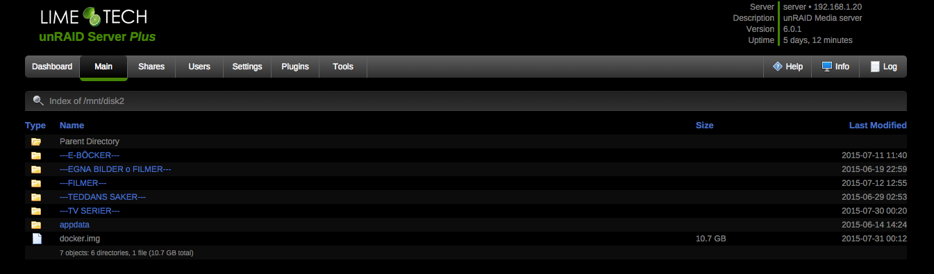

August 12, 201511 yr Author Thanks for reply ! I can't find 'scrub'...se picture. Where is it? But if i go to Tools-Diagnostics and download the files. I get this in the docker log. Warning: '--restart' is deprecated, it will be removed soon. See usage. time="2015-08-11T16:44:05+02:00" level=info msg="+job serveapi(unix:///var/run/docker.sock)" time="2015-08-11T16:44:05+02:00" level=info msg="Listening for HTTP on unix (/var/run/docker.sock)" time="2015-08-11T16:44:08+02:00" level=info msg="+job init_networkdriver()" time="2015-08-11T16:44:08+02:00" level=info msg="-job init_networkdriver() = OK (0)" time="2015-08-11T16:44:08+02:00" level=fatal msg="Shutting down daemon due to errors: Insertion failed because database is full: database or disk is full"
August 13, 201511 yr Author I do not understand, neither my array or my usb with OS is full. Database is full??

August 20, 201511 yr Community Expert You might try going to Settings - Docker and delete the Docker image. Then recreate it with more than 10GB.

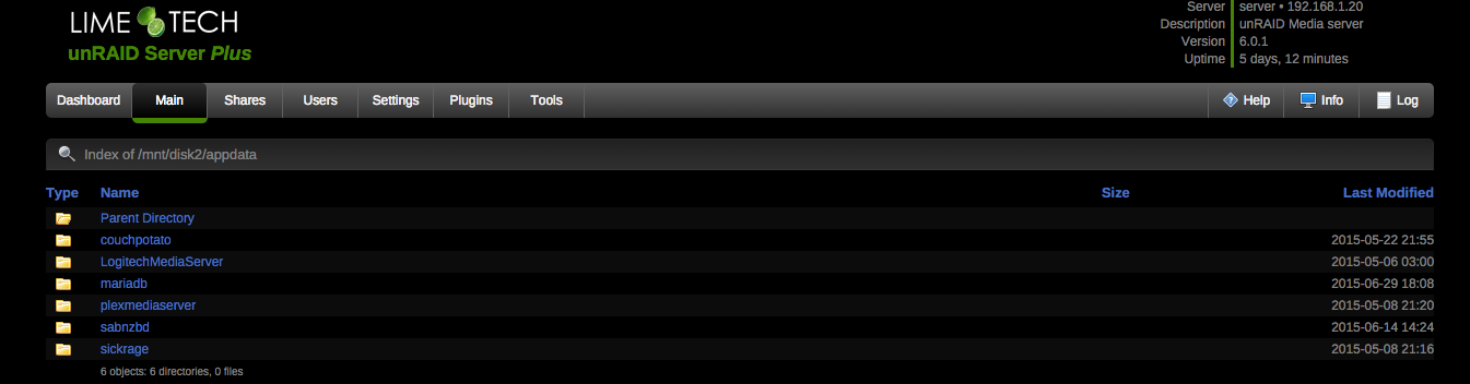

August 22, 201511 yr Author Ok, i deleted the docker image i had. Then i made a new image (same size) but at another location. After that it started working. Then i installed the same application i had earlier, logitech server. And it worked, all my settings got back. I read it in this thread https://lime-technology.com/forum/index.php?topic=38323.0 So now I can play Spotify again with my squeezeboxes :-)

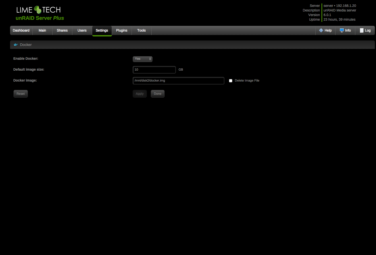

August 31, 201511 yr I'm having the same problem and error message in the log file. Aug 31 13:30:43 UnRaid2 php: Starting Docker... Aug 31 13:30:43 UnRaid2 logger: starting docker ... Aug 31 13:30:56 UnRaid2 php: Updating templates... Updating info... Aug 31 13:30:56 UnRaid2 php: Warning: stream_socket_client(): unable to connect to unix:///var/run/docker.sock (No such file or directory) in /usr/local/emhttp/plugins/dynamix.docker.manager/dockerClient.php on line 505 I noticed I was having problems with OwnCloud not working so I tried to Start/Stop it, however it would not start. I decided to reboot UnRaid Server and that's when the Docker settings tab disappeared and I can no longer start docker. I am using Unraid v6.0.1
August 31, 201511 yr I deleted my docker.img however still having the same problem. Aug 31 13:40:00 UnRaid2 php: Warning: stream_socket_client(): unable to connect to unix:///var/run/docker.sock (No such file or directory) in /usr/local/emhttp/plugins/dynamix.docker.manager/dockerClient.php on line 505 Aug 31 13:40:00 UnRaid2 php: Couldn't create socket: [2] No such file or directory Done. UPDATE: After disabling and enabling Docker, it now started and the Docker tab is now displayed.
