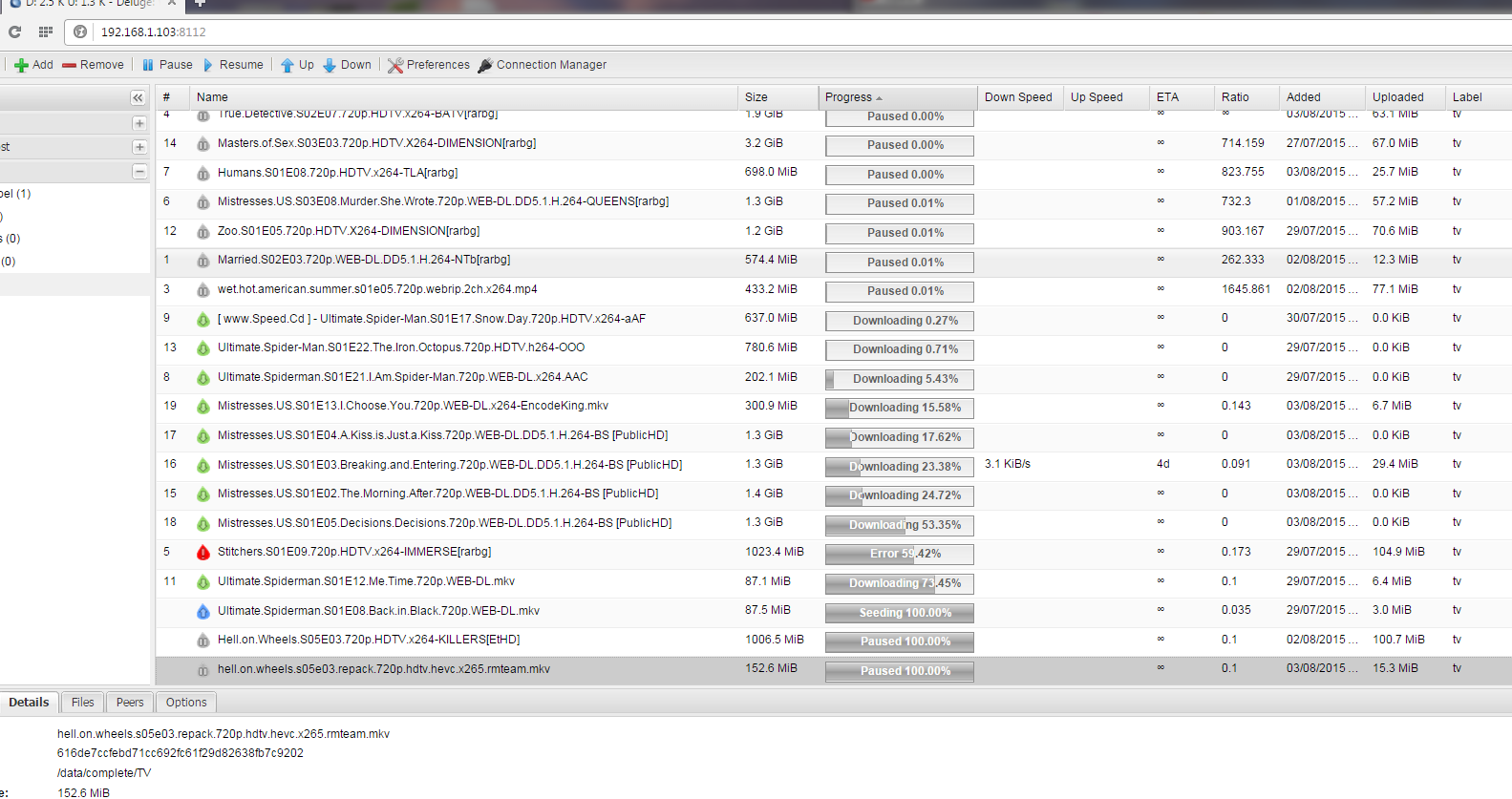

Hello, I have Sonarr, and Deluge.  Sonarr looks for torrents, and passes it to Deluge.  I have Deluge download it to a temp folder, eg. /data/deluge.  I also have Sonarr categorize it as tv, therefore, when it goes to Deluge, it's labeled as tv.  I have tv moved to /data/complete/tv.  Whenever My Sonarr's drone factory is set to this folder, /data/complete/tv.  I also have Deluge set to upload a ratio of 1.5.  Whenever I go out and return, I'd always see some files being shown as 100%, Paused, or sometimes, error.  When I go to /data/complete/tv folder, the file can't be played.  When I restart the docker container, oftentimes, it will download all over again.
My understanding is once's it's completed, it's moved over to /data/complete/tv, therefore, the file is perfectly playable.  Oftentimes, it isn't.  My suspicion is it didn't completely download.  Although some files are working.
What about those errors?  I would run a force recheck, then it will start download again, then give an error once again after a while.  Upon restart of docker container, those error files, or sometimes 100% Paused torrents will download all over again.
Hope someone can explain this strange behavior.

My preference in deluge is:
In docker
Deluge
/data= /mnt/cache/.downloads/
In Deluge docker app
Download folders:
Download to:
/data/deluge aka /mnt/cache/.downloads/deluge (docker mount point)
I previously set move completed to: /data/complete/tv before I found out about labels.  I have since then unticked the check box, but /data/complete/tv is still greyed out, but is present.  Does this even happen?  How do I remove it so as to be sure it's not happening?
I have ratio set to 1.5, to stop.  Deluge doesn't seem to have stop, but have paused?  And Pause happens when it's successfully shared the ratio?  But I see torrents in /data/complete/tv, and yet, they can't be played.  I assume it's download wrongly?
A lot of torrents not
Labels:
tv goes to /data/complete/tv
Sonarr's drone factory is set to /data/complete/tv
Sonarr's final media location is /media or /mnt/user/Media/TV/
Hope this helps others understand, so can provide help.  Thanks

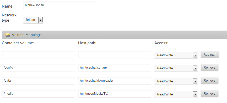

What are your Sonarr mappings?
The Sonarr container won't see "data" unless you've mapped it
These are my mapping on sonarr.  Hope this helps.
OK so /data is mapped to /mnt/cache/.downloads in both containers.
Is there anything in the Sonarr logs?
It should move stuff from the drone factory to the final media destination, so maybe the files are no longer in /data/complete/tv and therefore you can't play them and they get paused.

Hello CHBMB, it's supposed to move from /data/deluge to /data/complete/tv only when it completes downloading. After which, drone factory moves it to /media,  the final destination. My kodi has /media mounted as the source for TV. The thing is,  when it appears at kodi,  it's playback of some files are oftentimes garbled. When I go and look for the physical file in /media array,  it isn't playable too. This leads me to think that the file was transferred to /data/complete/tv even before it was completed.
Don't know why this happens. Also there are several files that pause just when it started,  or halfway. Upon restart,  it will once again start downloading. I think it has something to do with this behavior and some files are considered complete even before they are downloaded full. These are then moved to /data/complete/tv

I am using both sabnzbd and deluge.  All those downloaded by sabnzbd are also moved to /data/complete/tv, by category.  Sonarr's drone factory is set to watch this folder.  deluge downloads are set to move to this folder too when completed.  There are some deluge downloads that complete, and move to this folder properly.  I feel there are others that is partially downloaded, but the file is shown as complete, and moved to /data/complete/tv folder, which in turn is moved by drone factory to /media (being watched by Kodi).
