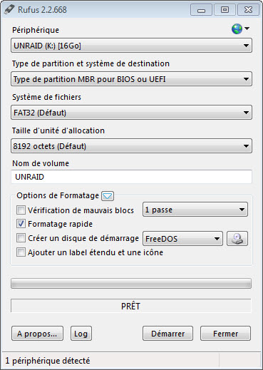

I found the way to boot on my flash drive finally! I use Rufus to format it after strait forward the normal procedure
Here a screenshot (Sorry for frenchy dialog) what preset I use in Rufus.
Hope that can help someone else.
