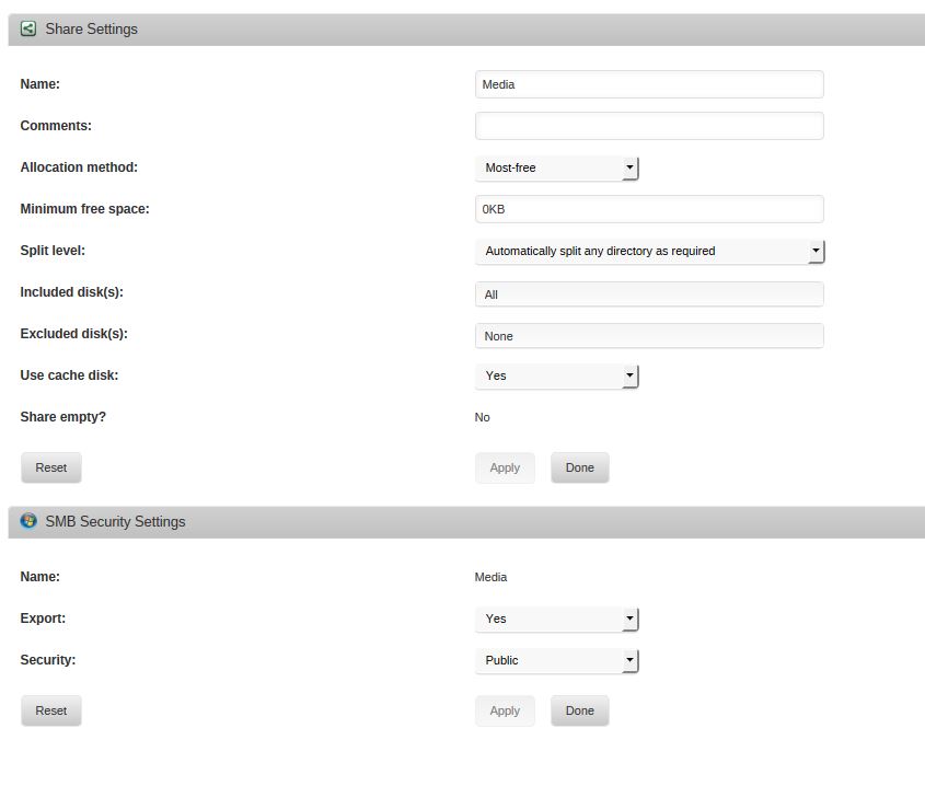

August 8, 201511 yr I have a share on disk 1 called Media, that is set to include all disks and the cache disk.. But I am xfering my entire DBase and it doesn't seem to auto split across other disks ? What am I missing ? I attached a picture of the setting ? I thought that Unraid would allocate and move the data via the cache disk automatically ? This is a consolidation of 12TB of my old plex server on Qnap so I have sub directories for Movies, Media etc.. all under the same Media directory on Disk 1

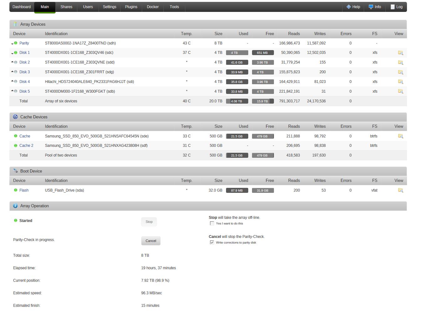

August 8, 201511 yr Community Expert Perhaps you can include a screenshot of the Main tab so we can see how much space is free on all the disks.

August 8, 201511 yr Author Ok the problem is if I dump into the SMB shares, then Plex doesn't see it ? I tried going to the SMB share Media/Movies ? I attached the main tab pic as well

August 10, 201511 yr Community Expert OK then how do I set up a share that does spans across all disks ? clearly I have set up my share incorrectly ? Your screenshots look OK. Sometimes if you make changes to share settings you will have to stop and start the array before they will take effect. unRAID won't move anything already on a disk. It only moves from cache. If you write a new folder to the share it should put it on cache. Then if you run mover see if it gets put on a different disk. You can also see which disks already have data for a share. Go to the Shares page and click on Compute... for the share.

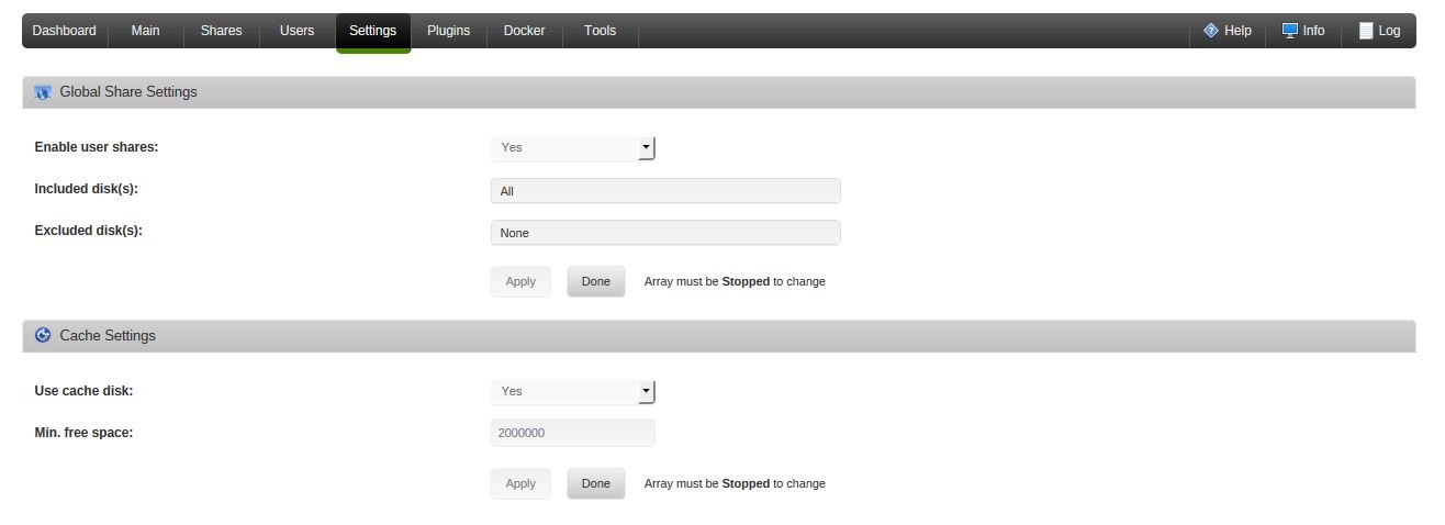

August 11, 201511 yr Author "Unraid will never move data from one data drive to another, only from the cache drive to the data drive that fits the criteria for that particular path. If you write to \\tower\disk1\usershare\path to files\ the data will always stay on disk1 until you manually move it. If you write to \\tower\usershare\path to files\ and usershare is set to use the cache drive for new writes, then you should see the files show up first on \\tower\cache\usershare\path to files\ and then after the mover runs they will go to \\tower\disk??\usershare\path to files\ where ?? is the disk that fits the split level, included disks, free space, and allocation method chosen for usershare. The files will always show up at \\tower\usershare\path to files\ regardless of which physical disk, either data or cache, that the file is on at that particular moment." OK.. I get that.. I have Global Shares set to Cache drive.. So the only thing I can figure out.. is either I am pointing to the wrong directory to dump files This is the abstraction that I am missing.. and further I can only seem to get Plex to pick up the files when they scan the user share versus the specific disk/dir ?
