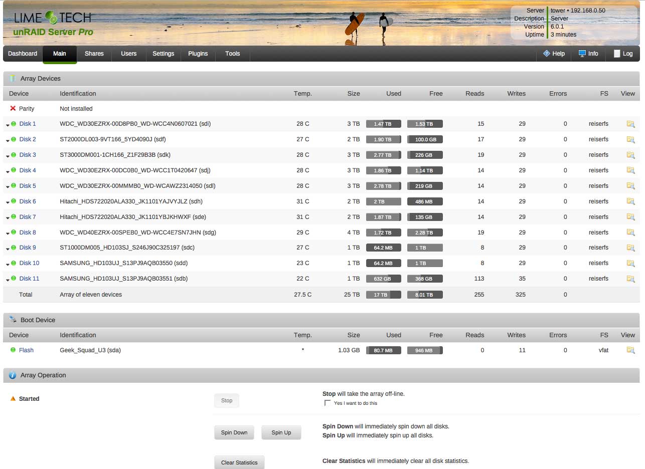

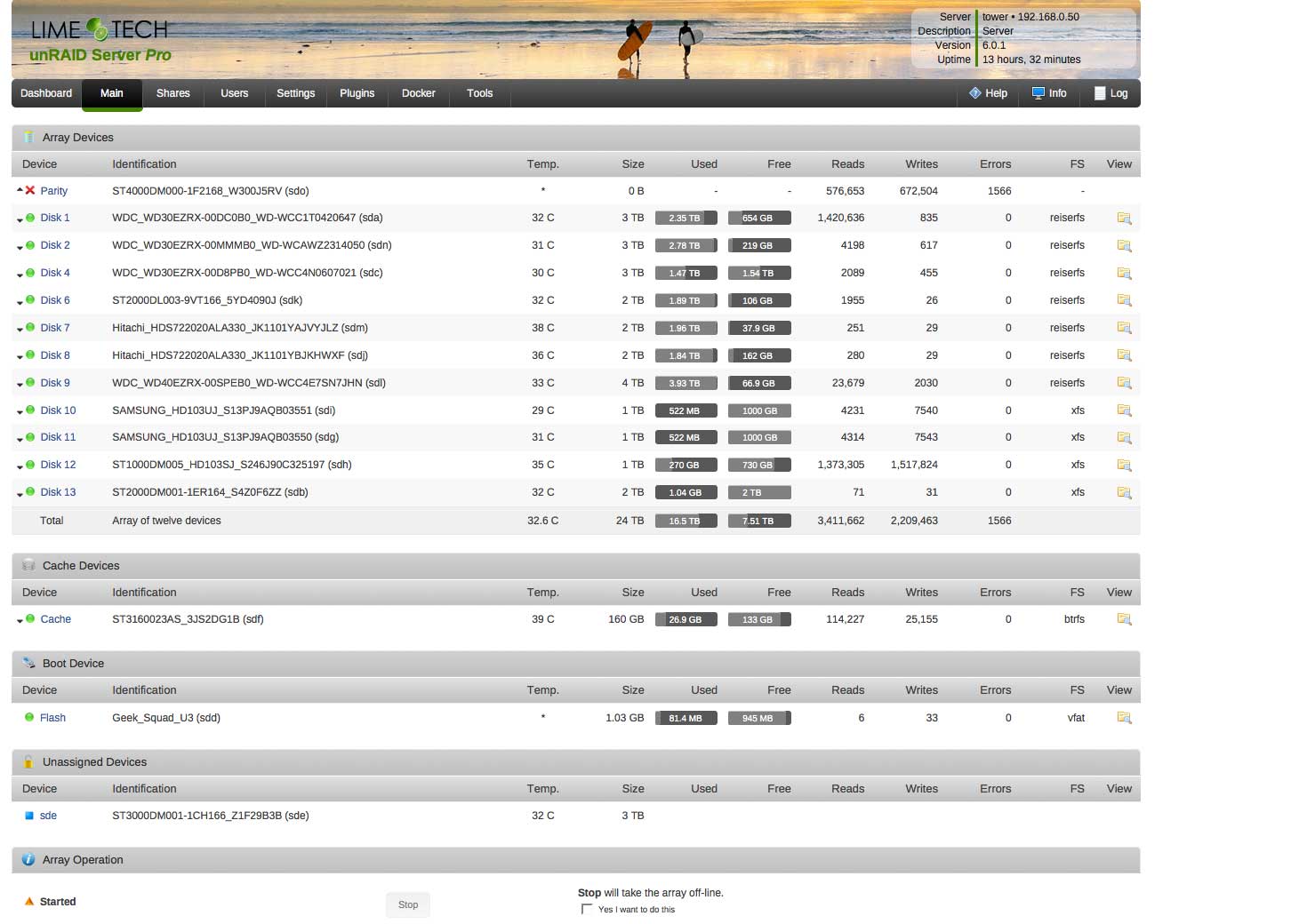

September 4, 201511 yr Author So Problems still persist. I removed the three 1TB drives and had everything up and working for a few days. (Screen shot 1)During a parity sync it dropped disk03 from the array again. Showed 444k write errors on disk 3. See screen cap 2(forgot to screen cap before reboot so its not showing the failed writes) I then ordered a new seasonic 850w x-series gold power supply. Installed the new power supply, created a new config added all the drives back except disk 03. ran parity sync again and everything was good. I figured with the new power supply i could back in my my three 1tb drives. Cleared and added the drives again everything was fine. Woke up this morning and it has now dropped the parity disk from the array. (screen shot 3). I have not rebooted the server yet so was able to grab the current diagnostics. also attached.
September 4, 201511 yr Community Expert Some stuff in your syslog that I'd not seen before, as unRAID handled the addition of 3 new drives. I think it's probably all normal though. Of course, your parity drive was disabled due to a failed write, but there isn't a smart report for it. Maybe check your connections again.
