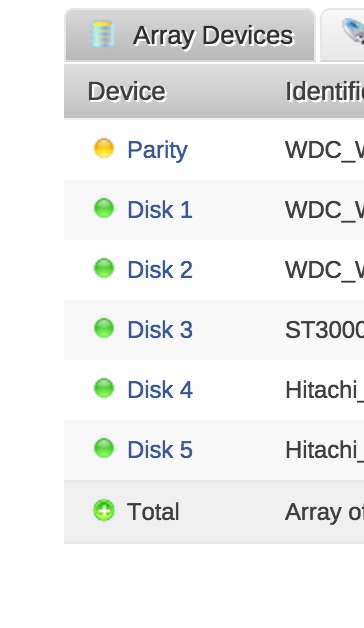

My parity drive started playing up a few days ago, I noticed that the drive had disabled itself and had failed SMART. I decided to restart the server and the parity disk was now listed as a new drive so I started the array and completed a parity sync. That was all fine except the drive disabled itself again about a day later.

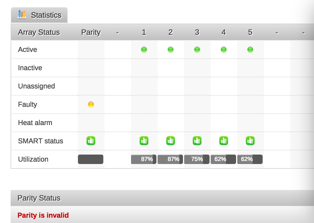

I purchased a new 3TB WD Red drive to replace it. When I started the server, the drive was listed as a new, I assigned it as parity and started the array and it's currently going through a parity sync. The parity drive status has a yellow bubble (invalid data content), which aligns with the details on the unRaid wiki, however it's showing as faulty on the Dynamix Dashboard. I've attached screenshots of the two screens, Is that right?
Sorry if this is an obvious questions, the parity failure threw me a bit and just want to make sure it's going smoothly or if there's another issue.

Yes, that is normal. I just finished doing a new parity drive myself.
