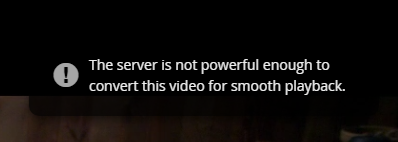

Currently I stream my video content via Plex to my Xbox One, Playstation 3, Apple TV (via iPad/iPhone), Chrome Cast (iPad/iPhone) and in the Browser on my computer (Win 10 Chrome) - not at the same time of course. I've been trying to work out if the issue is device specific or across all. Unfortunately on every device I have the same issue, approximately 10-20 minutes in the video playback will freeze, sometimes temporarily, other times it will drop the connection and say unable to contact the plex server (xbox), or the computer isn't powerful enough for the stream (browser) which is odd given it is an 8 Core AMD with 8GB of RAM.

Its actually every 5 minutes, Ive attached a screenshot and syslog

Where do you have your "Transcoder temporary directory" set to?  In Plex server settings -> transcoder settings
Hey Scott,
the field is blank currently, I'm using a 128gb cache ssd should i just create a directory in the /config mount point for the docker?
I would try that just to see if it helps.  I have mine set to /transcode in plex server settings,  and in the docker mappings i have /transcode => /mnt/cache/plextemp
looks like it might have done the trick!
