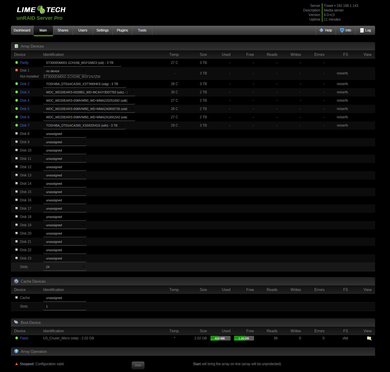

August 12, 201511 yr Author In Main, click on the drive and go to the Attributes and post them. Thank you, but I can't actually click on the drive because it says Disk 1 is "not installed" in main with a red square next to it (device disabled.) You could always upgrade to 6.0.1 final. That's true. Doing that would give me access to the new diagnostics feature. I wonder if the diagnostics work even work though if it's not detecting the drive. On a side note, I noticed it says in the syslog for sda1 (my UnRaid flash drive) that the "Volume was not properly unmounted. Some data may be corrupt. Please run fsck." Not sure that has anything to do with my issue though!

August 16, 201511 yr Author @RobJ - Thank you for taking the time to update the Wiki article! I just received a replacement drive, and I wanted to ask a few questions before I start. [*]You mention in the updated instructions to "Unassign the old drive" of which I'm not sure I am able to or need to do because it is listed as "not installed." I've attached an image of my UnRAID GUI to illustrate what I am seeing. [*]You also mentioned that all of the contents of the old drive will be copied onto the new drive, making it an exact replacement, except possibly bigger. I worry about that last part as 3TB is the largest drive I can install since that is the size of my parity drive, and I (stupidly, I know) kept my drive pretty full, so much so that there were only roughly 6GB left on the drive before it died. Will I have to worry about anything happening if it is indeed larger since I suspect 6GB isn't a large buffer for any overflow Thank you again for all of your help as always, and I will begin the rebuild process as soon as I get confirmation on those two items!

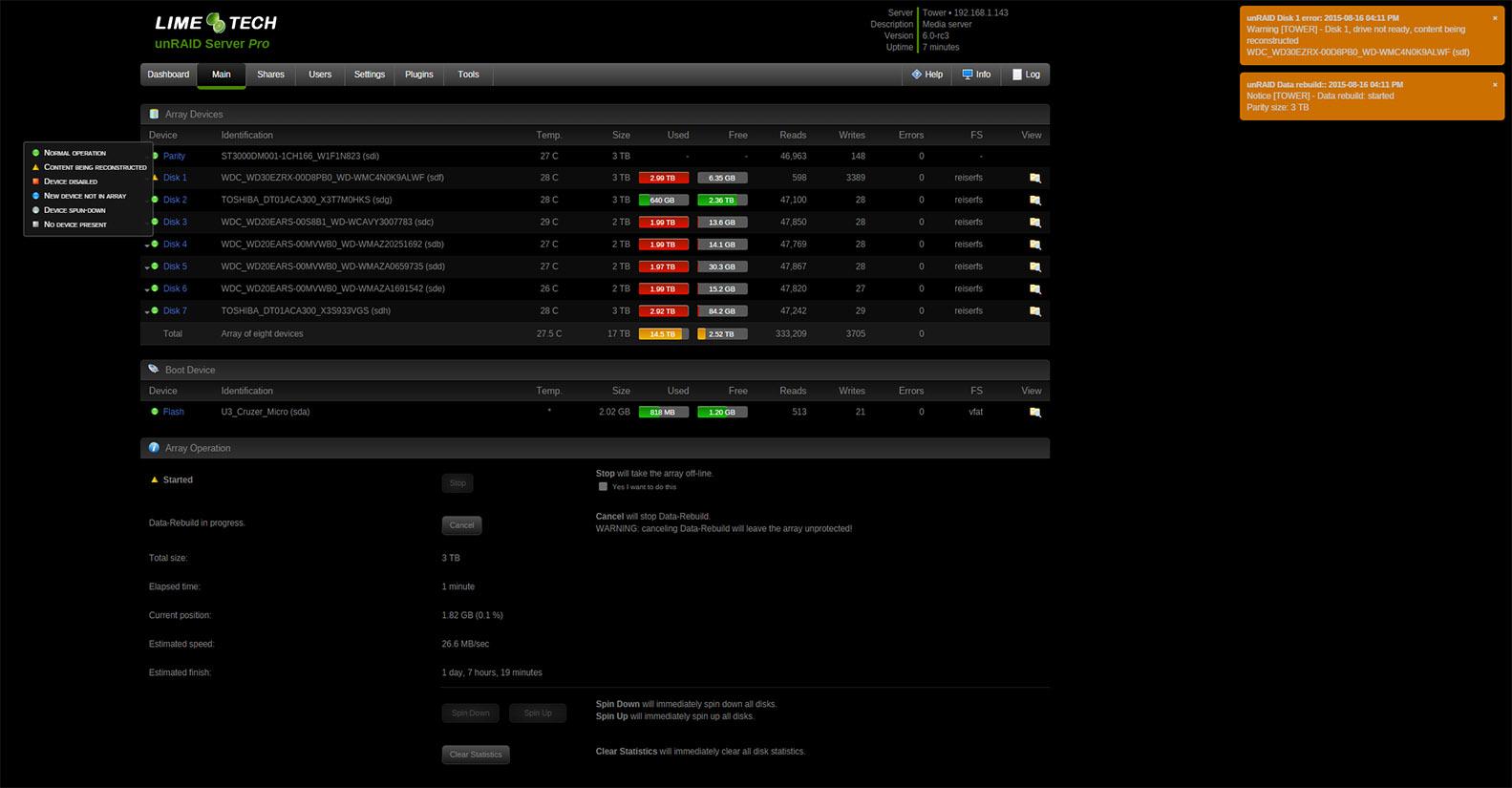

August 16, 201511 yr Author @itimpi - Thank you for the quick explanation. I have attached the new drive and it is currently, seemingly with no issues, rebuilding the drive as we speak. I expect this to take a fairly long time, maybe a full day, so I will report back once it is done if there are any issues. @RobJ - I followed the instructions you laid out and had no problems so far. I admit I got a little excited and forgot to take a screenshot of what it said for the "I'm sure" portion of the instructions. The wording had mentioned something about "rebuilding the drive," but I forgot to copy it down before proceeding. What I did was the following, starting with removing the old drive because my server was already shutdown: [*]Removed problem drive from server [*]Installed new drive with the same SATA cable and power cable, also keeping the drive connected to the same port the troubled drive was connected to [*]Booted up server (noticed that the SuperMicro splash boot screen did not sit there for a minute as it previously had, presumably because the troubled drive was no longer delaying boot.) [*]Opened up UnRAID GUI to the "Main" tab (default) [*]Clicked the drop down list next to "Disk 1" (currently reporting "no device") and selected the new drive [*]Clicked the "Yes, I'm sure" check box next to the information explaining that the drive will be rebuilt upon hitting the "Start" button [*]Clicked on the "Start" button and the rebuilding process started, with the UnRAID GUI displaying orange-colored toast pop-ups in the top right corner. The toast pop-ups said the following: [*]unRAID Disk 1 error: 2015-08-16 04:11 PM Warning [TOWER] - Disk 1, drive not ready, content being reconstructed WDC_WD30EZRX-00D8PB0_WD-WMC4N0K9ALWF (sdf) [*]unRAID Data rebuild:: 2015-08-16 04:11 PM Notice [TOWER] - Data rebuild: started Parity size: 3 TB [*]Data build currently in progress I've attached a screenshot of the current screen for possibly posting on the wiki post if it is of any help. In the meantime while the drive re-builds, I want to try and see if I can diagnose the drive that stopped working. I have a SystemRescueCD USB drive that I will use to boot up into Linux and try and see if I can get the drive to be detected. If anyone has any suggestions on things to do when trying to diagnose a potentially bad drive, that would be greatly appreciated. In the meantime, off to Google I go. Nonetheless, thank you to everyone who has been a help in this post. I hope that this will be a simple solution to my issue!
August 16, 201511 yr Community Expert I think this screenshot should be captioned "Don't let your drives get this full".
August 17, 201511 yr Author I do have a problem, and it's keeping my drives too full I need to convert some of those 2TB drives since I'm out of SATA ports! I've read conflicting arguments on here that it does and doesn't matter how much free space you have on your drives, so I'd love to hear what you suggest is an adequate amount
August 17, 201511 yr I've read conflicting arguments on here that it does and doesn't matter how much free space you have on your drives, so I'd love to hear what you suggest is an adequate amount Static content that is read only after you put it on the drive (movies, etc) fill 'er up. The last few will probably take a while to start copying, but after it's on there, reading speeds should be fine. Drives that have changing content, I'd keep about 20% free, and every once in a while it would probably be a good idea to totally clean off the drive, format it, and start filling it up again. Fragmentation is still an issue, and I have not found a good way to deal with it short of reformatting every once in a while. Keeping 20% free will keep the effects to a minimum. Others may have differing opinions, but this has been my experience so far with unraid.

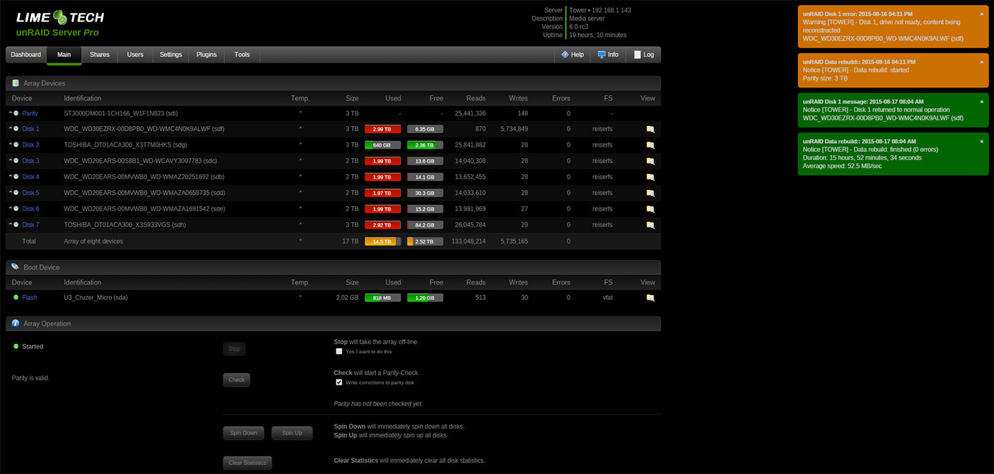

August 18, 201511 yr Author Not a problem. Attached is another screenshot of the completed rebuild if it is at all helpful. The drive has rebuilt successfully and everything is now back to normal. Thanks to you and everyone else for assistance with my issue!
