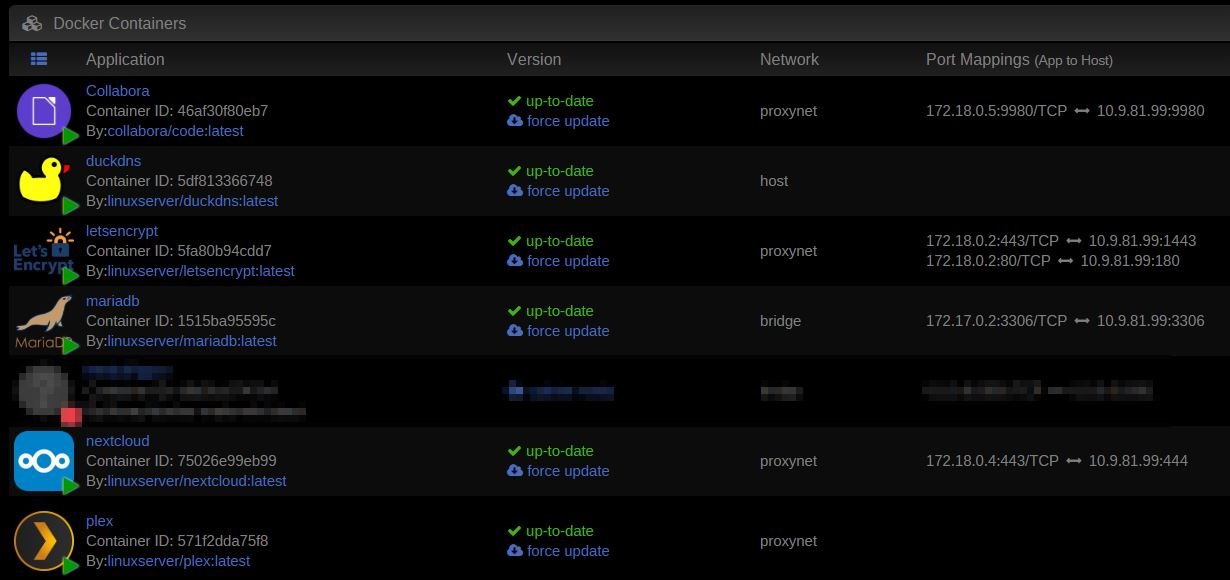

I just followed this guide "How to Setup and Configure a Reverse Proxy on unRAID with LetsEncrypt & NGINX" (linked below).
When he did this and set his "Network Type" to "Custom : proxynet" it still showed "Port Mappings (App to Host)"
When I switch to "Custom : proxynet" on my linuxserver Plex docker the port mappings disappear.
How I can get to my Plex server via https://plex.mydomain.com which goes over the internet, through a reverse proxy, doing SSL, etc... but now it seems impossible to to get to Plex locally.
How can I do this?  Why did those "Port Mappings" dissappear on this Plex docker?

Let's Encrypt is setup.  I didn't do any configuration on the Plex side other than switching my network.
I have it set up exactly how the video described.... Ok my router/firewall I have WAN port 80 and 443 mapped to 180 and 1443 on my unRAID server.
I have letsencrypt running on proxynet network using ports 180 and 1443.
Then I have config files for nginx which pass plex.* subdomain onto plex:32400
Everything seems to work when I access it through internet (https://plex.whatever.com) but I can no longer access it using http://<ip of unraid>:32400
Curious why port mappings disappear on Plex when switching to proxynet but other dockers like Nextcloud or even the letsencrypt still list them.
Everything seems to work when I access it through internet (https://plex.whatever.com) but I can no longer access it using http://:32400

No, the webui doesn't work for Plex but it does for Nextcloud.
The act of switching Nextcloud to "Custom : proxynet" does not affect my ability to connect locally.
The act of switching Plex to "Custom : proxynet" DOES affect my ability.  In the screenshot you see there are no Port Mappings listed for Plex but they still exist for letsencrypt, Collabora, and nextcloud.
I'm saying there is something different about this Plex template.
Is it possible to edit this template somewhere?
I looked at all of these and noticed that Plex doesn't have any Publish->Port section while the other templates do.  Perhaps this is the issue?  Could this be added?  I have to believe this is what is currently preventing me from connecting directly via local network and having to traverse the internet.

The reason there are no ports in the template is that we advise to run it in host mode. If you somehow change that, you need to figure out which ports to add. In this case it isn't hard for the webui. The other ports is mentioned somewhere in this thread, it might even be in the Readme on github. If not, check the which ports the official plex container recommends.
You should set up dns resolver (pfsense) so that you can use the domain name inside your network.
When I have the network for Plex set to "Host" I see these mappings listed.
10.9.81.99:1900/UDP  <-->  10.9.81.99:1900
10.9.81.99:32400/TCP <-->  10.9.81.99:32400
10.9.81.99:32400/UDP <-->  10.9.81.99:32400
10.9.81.99:32469/TCP <-->  10.9.81.99:32469
10.9.81.99:32469/UDP <-->  10.9.81.99:32469
10.9.81.99:5353/UDP  <-->  10.9.81.99:5353
No clue where this list is comming from?  Perhaps something within the Dockerfiles somewhere.
I manually set "-p 32400:32400" in the "Extra Parameters" and I was able to connect locally.
I have Unify/Ubiquiti equipment.  How would I make it so that I could use that domain name inside my network?
From outsite my network, that domain name points to my public IP address and I have my USG map port 80 and 443 to my unraid server port 180 and 1443 (because unRAID already uses 80 and 443).  This then hits the reverse proxy and goes to the correct Docker.
From inside my network if I had plex.mydomain.com resolve to 10.9.81.99 then what would be doing the translation from 80 and 443 to 180 and 1443?
I understand that you advise to run in host mode, but isn't that accomplished by defaulting to host mode?

I guess another option is to leave it in host mode and not on proxynet.
In that case, instead of using Docker to resolve each other by DNS I could hard code the IP of the unRAID server in the proxy_pass on this line:
https://github.com/linuxserver/reverse-proxy-confs/blob/master/plex.subdomain.conf.sample#L33
I am still interested in anything I can do locally via DNS on my USG gateway.  I'm fairly new to networking.
Also, if I did want to edit those template files what is the supported way to do that?  Would I copy the xml and call it custom-plex.xml and make my changes there?

I would like to use my domain when I'm away and my ip while at home.
I believe this can be solved 2 different ways.
  • Let plex run on proxynet and either
    • modify template to publish the ports
    • modify the Extra Parameters to include port mappings like -v 32400:32400
  • Let plex run on host and
    • Hard code Unraid IP address in proxy config:
      i.e. change "proxy_pass http://$upstream_plex:32400;" to "proxy_pass http://10.10.1.99:32400;"
I thought the best way to fix this would be to have the linuxserver guys change their template so that it would play nice with the LetsEncrypt container/configurations which are also owned by them.
Link to comment
40 minutes ago, eric.frederich said:
Yes, everything you said is understood and correct.
On my home network I am able to use plex by the domain address.  Same from my phone.  It works.
What I was asking though, is how to make it possible to access it by ip:port while at home and not have this traffic traverse the public internet.
Nothing need to be done to the template.
The traffic doesn't go through internet if you can use the domain name to get to plex on your home network. Then you have managed to set up dns resolver somehow.
When running plex on the custom docker bridge you need to add ports to get it to work on your local network through IP. If you add 32400 you should be able to go to unraid-IP:port/web.
