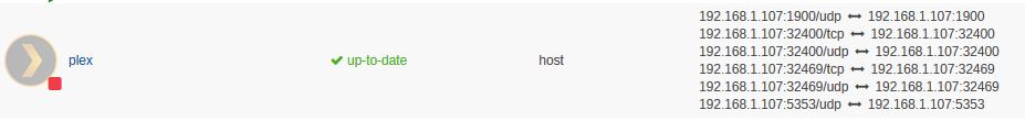

I recently upgraded my unraid server to 6.5.0 and ever since then my Plex server has been crashing after playing a media file for a short amount of time.  The log shows the plex server shutting down "DEBUG - Shutting down with signal 15", but nothing more that I can see.  This has all been since I updated to the latest unraid version.  My plex version is 1.12.2.4929.
Any help would be greatly appreciated.

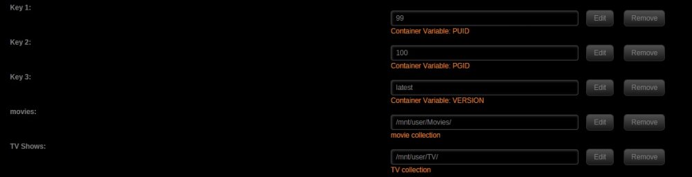

Unable to Find Media Folders
Hello,
I'm trying to setup Plex Server and when I "Browse For Media Folder" I cannot find my media folders.  The mnt directory is empty (within Plex) and I know that is where they are as I can see them when I browse the shares in the UnRaid WebUI I can see (for example) /mnt/user/TV Shows.  It looks like I'm not starting at the root of the server when I'm browsing in the Plex setup web page.  I don't see anything in the Docker -> Edit that allows me to set a path to the media.
Thanks,
Jerry

Sounds like you don't really understand volume mapping. Have you read the Docker FAQ? Are you following any guides to set this up?
I know that this is where my problem is.  However I cannot find the instructions to tell me how to do this.  I did find these instructions but I cannot find how to get to the volume mappings as shown.  I don't know if it is supposed to be in the config for that individual docker or someplace else.  For Sabnzb there were places in the Docker edit for me to set the path for downloads.
In the case of this Plex Docker there is a AppData Config Path under more settings.  There is also a note near the top that states "/media Map this to your media, you can use several submappings here", but I cannot find anyplace in the Docker Edit screen that lets me set the /media path.
I figured it out by looking at the /config one and using the "Add another path" link.  I still cannot find anyplace that describes how this should be filled out, I just played around with copying what was already there for /config.

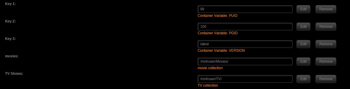

Did you use Community Applications to get started with this? Are you actually using the linuxserverio plex docker or some other plex docker?
I figured it out by looking at the /config one and using the "Add another path" link.  I still cannot find anyplace that describes how this should be filled out, I jut played around with copying what was already there for /config.
Does this picture help you any?
