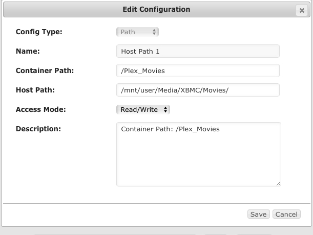

40 minutes ago, jtcweb said:
I just played around with copying what was already there for /config.
Here’s a sample of what one of my paths looks like-
You’ll need to make adjustments as necessary for your setup and add as many paths as you need for all your media.

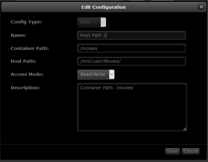

5 hours ago, jtcweb said:
I figured it out by looking at the /config one and using the "Add another path" link.  I still cannot find anyplace that describes how this should be filled out, I just played around with copying what was already there for /config.

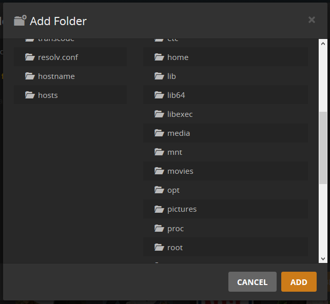

There are two parts to setting this up;  Defining the Host Path in the Plex Docker Edit screen and associating it with Container Path, like this example:
The second part is adding a Library in Plex that corresponds to your specified container path. In this example I am adding a Movies Library and am at the scree to select the folder which will be associated with the Libarary
If you want to add a Movies library the folder you select is "movies" since that is the  name of the container path specified when the mapping was created.  Do not go into the mnt folder looking for your movies. You won't find what you are looking for there.
The whole purpose of creating the container mappings in the docker is to associate a user share (/mnt/user/Movies in my example) with a container path that Plex will use.

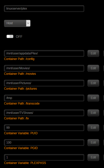

Interesting.  Here is a screenshot from my docker config:
So, I should eliminate the PLEXPASS variable?  I am not certain how it got there, but, if it is not a default variable, at some point, I must have added it for some reason.  Is something else misconfigured?
Edited by Hoopster
As it says in the Readme, the variable is VERSION and the value is latest. Just edit the one you have and set it to the new.
It's probably from when you installed it in the first half of 2015.
Yep, reading that on Github now.  Will set VERSION to public or latest (probably public).  This docker has been running great for me since I installed it.  I likely never realized the variables had changed.  Thanks!
Setting it to public will not get you the plexpass version. But that was maybe the point, as you are beta testing using the plexpass version?
