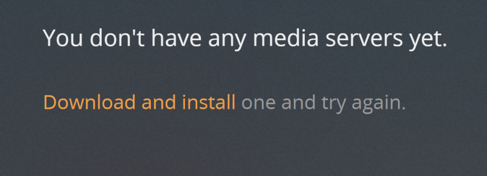

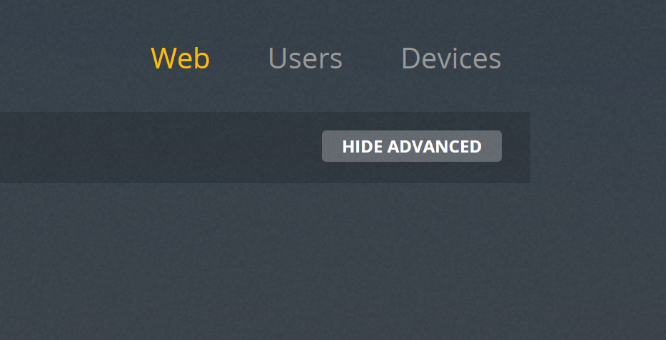

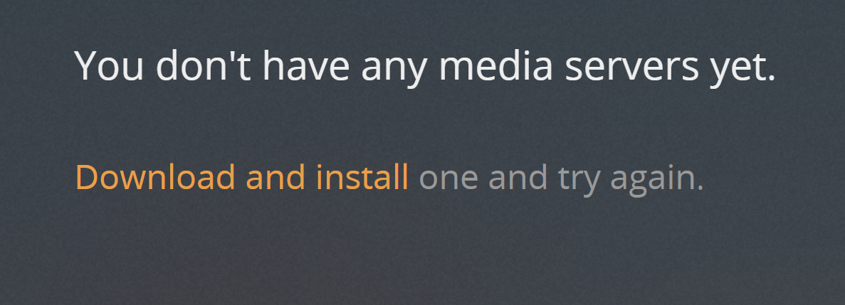

 Can someone please help me. My plex disappeared. I know it may seem too little information but I am serious here. My server was unconnectable, I tried to reinstall the docker after I wiped the plex folder from the appdata and I literally can't do anything. I get no server tab.  PLEX.PNG.81b7bc18835b1388ce1c7048184e4965.PNG
I tried going to the URl that tries to run setup again and I only get it asking for me to download and install one... Except I am already connected to my Plex!image.thumb.png.805055679be8ab75f6dd4e099b81ef56.png
This is really Getting me down. I paid for a lifetime Plexpass and now it's gone and I simply can't get it working again!
Thanks for any help you can give... Im kinda bummed right now as you can imagine. ?

It doesn't seem like too little information, it is too little.
Post the docker run command, the plex container log and plex log if you want help.

First, i can't get you the plex logs since there is no server anymore. I tried removing it because it was not showing up.
Secondly, Here is the plex docker log.

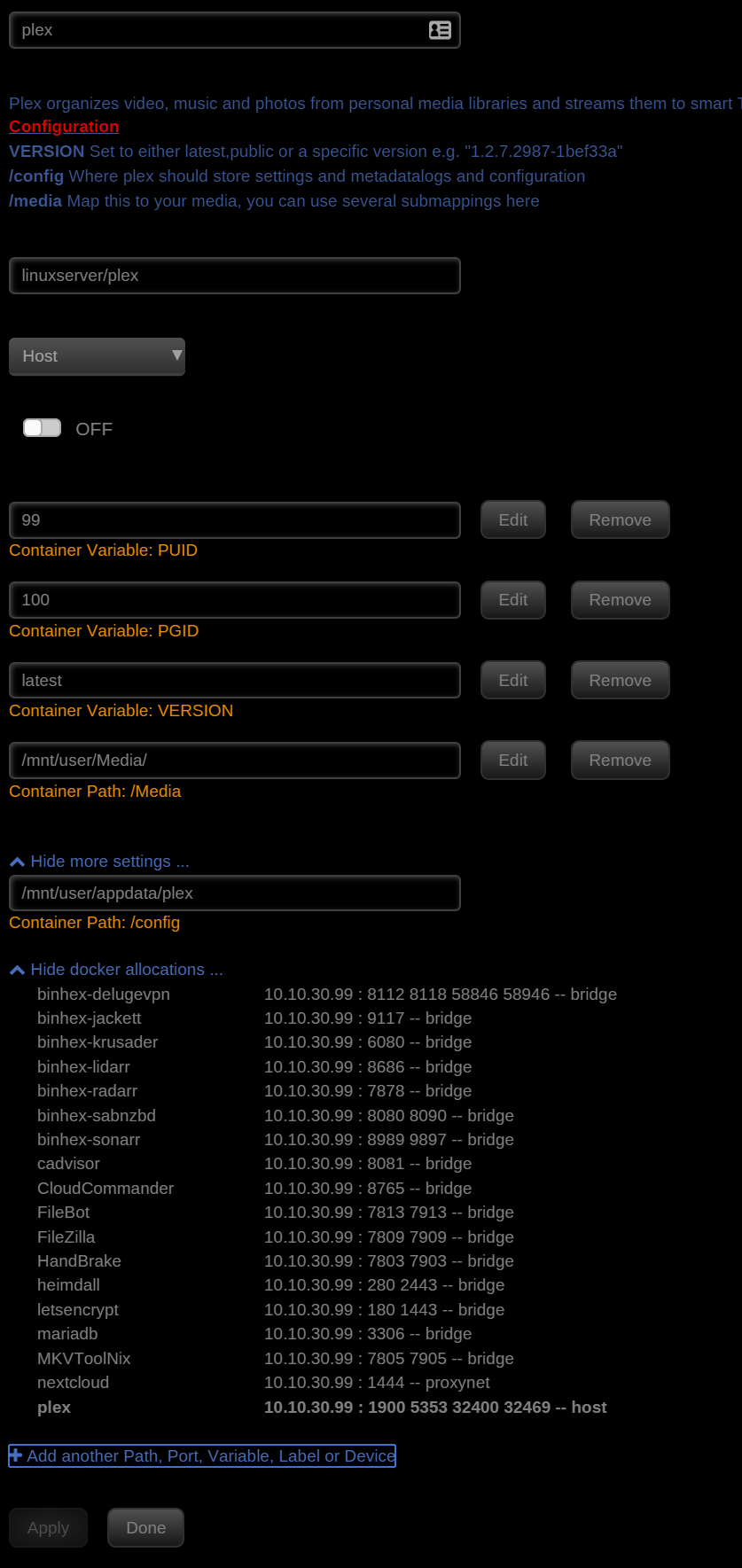

Thirdly, sorry, but I have no idea how to get the docker run command. I'm new to unRaid and Linux in general and have only been using it about a month. I am happy to get it for you if you tell me how.
EDIT: Is this what you were looking for?
root@localhost:# /usr/local/emhttp/plugins/dynamix.docker.manager/scripts/docker run -d --name='plex' --net='host' -e TZ="America/Phoenix" -e HOST_OS="unRAID" -e 'PUID'='99' -e 'PGID'='100' -e 'VERSION'='latest' -v '/mnt/user/':'/MyMedia':'rw' -v '/mnt/user/appdata/plex':'/config':'rw' 'linuxserver/plex'

I believe this is what you were looking for? It was already on the cache drive but I moved it to another location anyway and no change. Also, yes, I am connecting directly to it via my local LAN.

Post your docker template config, looks like its trying to use a 192.168 and 10.10 network
that's very interesting because I don't use 192.168.0.0 at all on my network. I actually use three subnets 10.10.10.0/24 which is my personal LAN, 10.10.20.0/24 which is reserved only for the roommates use through an AP, and then I have 10.10.30.0/24 which is a dedicated exclusively to the server itself and nothing else. This way NAT reflection work in pure NAT mode and I have a greater granularity of control where the traffic actually goes. The only time I used 192.168.0.0 was when I first set up my pfSense VM. My modem's access page is 192.168.100.1 and is unconfigurable though.
As for the docker template config, I assume you mean what I have in the attached pic? I just don't know much about docker yet, learning every day, so I don't know if this is something specific you are asking for and I'm just too newb to know better. ?
@everyone
Honestly, I just don't know why using a fresh install of the docker will not allow me to start over. I don't even care about the metadata getting lost, I just want to rebuild it. I did go and test Binhex, LimeTech, and the official docker containers and all of those exhibited the same behavior, even though I have never had them installed before. So there is something that isn't getting wiped clean that is blocking me from starting a new server. Would a rebuild of my docker image be worth trying?

Yes, that was the first thing I tried. I have now done it maybe 40 times. That's not a typo, literally at least forty times. I appreciate the sanity check though. ?
Since you mentioned it is trying to use a subnet I simply am not using, is there a way to manually force Plex to use the subnet I am actually using? Would there be any kind of reason why it would be trying to force the wrong subnet in the first place?
Not sure if it is related, but, did you see this post at the top of the page? Apparently the latest version of Plex server can bind to multiple network adapters (which might explain your multiple subnets problem) and it is causing some people issues - like servers not showing up - with Plex docker implementations.

I think this has to do with your subnets. You should connect through a device in the 10.10.30.0/24 range or else you will get this issue.

I think you are on to something. First off, I originally set up this docker when the server was on the 10.10.10.0/24 subnet, same as my current machine so that's prolly why it worked. And with what @ijuarez and @Hoopster said, it seems that it is binding to some subnet with 192.168. subnet. Ok, so I was following Spaceinvader Ones's tut on nextcloud. In his tutorial, he has you make a new network, low and behold it is set to a 192.168. subnet! So this tells me plex is binding to Vibr0. I have since moved the server back to the 10.10.10.99/24 subnet so that shouldn't be an issue right now. However, in unraid, I can't use the GUI to remove virbr0 route. vibr.thumb.PNG.f855c84086ced4aa89af7734509ade3e.PNG
My issue now is I simply don't know the commands to remove it entirely. I decided after the fact that I didn't want to have any of my docker going through virbr0 since it made them inaccessible locally due to the way my network was set up. I COMPLTELY forgot about this too as I am not using it and sort of haven't thought about it in a bit.
I would be willing to put money on this being the problem. Does someone know the commends to remove this virtual network?

Docker natively has a bunch of networking, subnets, etc. that you're not going to be able to remove. Plex tried to make the code that would allow you to specify which network interface to use. While you *CAN* specify that, the code underlying this detection method broke in the last release. They're working on it, and so I wait, I can't get any Plex server to run in my environment under Docker or Linux, ATM.
A quick test is to launch a web client and try to connect to the server. Mine literally is available for 30 seconds every 5 minutes or so. That's the acid test I found. It won't show up initially for a few minutes too.
The difference here is this virbr0 I made myself from the command line as part of the tutorial. I should be able to remove this specific network, shouldn't I? It is not part of the docker stuff by default.

Oh, so if you want to change networking and adding bridges, if I recall, you need to spin down your array before you can change the advanced network settings to allow you to add virtual NICs and bridges.

So in the Routing Table section of Settings>Network Settings you have no trash can icon in the Delete column to allow you to delete virbr0 (assuming that is the correct way to delete it)?

AAAAHHHH! I FIXED IT!!! WOOO!
Alright, sorry, I'm so happy I could literally start running around in circles right now! So, here's what I did. After remembering I use the 'docker network create proxynet' command, I opened the terminal and tried just using 'docker network remove proxynet' but it errored and told me that it had active endpoints. I then recalled I could disable the 'preserver user-defined networks'. I disabled this in the docker settings of unRaid and then after re-enabling the Docker engine, I was finally able to remove this virbr0 entirely. From there, I just opened the Plex WebGUI like always and it instantly showed me the create new server stuff. Hell yes...
Honestly, guys, I can not put into words how incredibly frustrating this has been for me over the last two days or so. I have also never gotten as good support before from such a knowledgeable group of people. With the powers of all of you together and a little bouncing of ideas off each other, we have fixed it. Where can I donate to the linuxserver.io? ???
