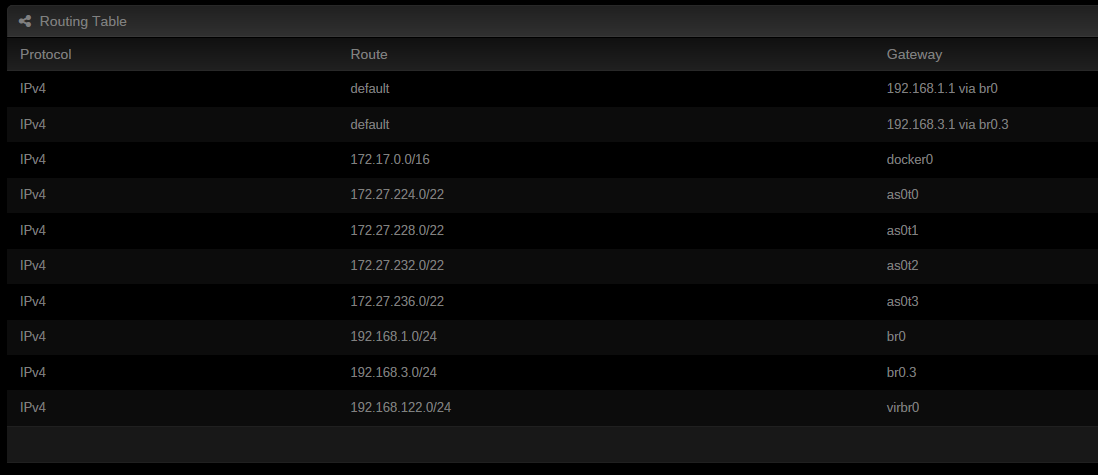

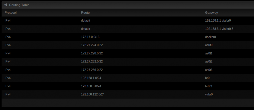

And yet I (and others) have had zero issues with Plex with the 1.13.5 version whereas many others have network connectivity issues inside and outside their local LAN.
The problems seem to be related to docker network interfaces and how Plex interacts with them.  It is interesting that some have issues and some don't with similar network setups.
I have zero issues and everything is functioning normally both internally and remotely.
Here are my unRAID/docker networks for reference:
