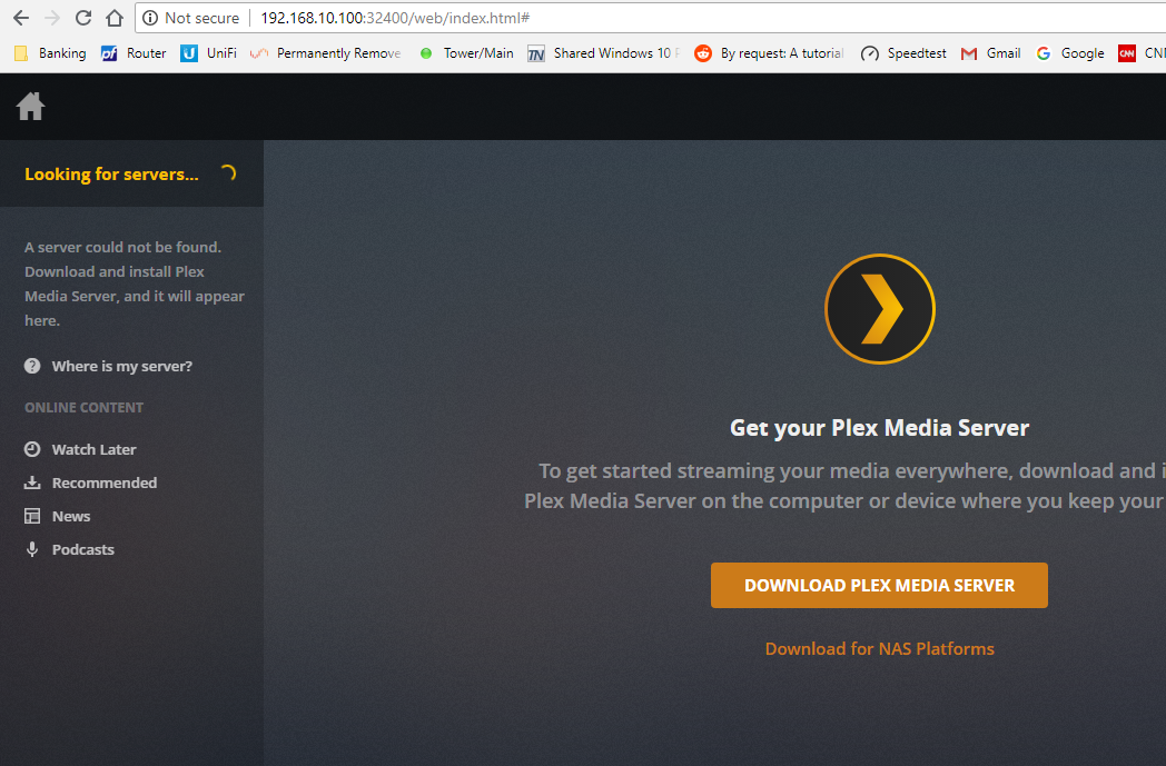

3 minutes ago, xman111 said:
It is installed but I wasn't sure what I should pick for the containers, etc.  It just keeps saying looking for servers.
If you downloaded the Linuxserver.io Plex docker you downloaded the Plex Media Server.
When you launch the WebUI, it should find the Plex Media Server running on your unRAID server.  The Server it finds will be the name of your unRAID server.
Before determining if you have your containers mapped properly, a server has to be found.
The Plex docker shows as running (green play arrow on the icon) in the Docker tab, correct?
What is the exact error you are seeing?  Is it something like "You don't have any media servers yet.  Download and install one", or, is it something else?

just on way home from work will post screenshots in an hour.
thanks for taking the time to respond.
ok, here are a couple pics..

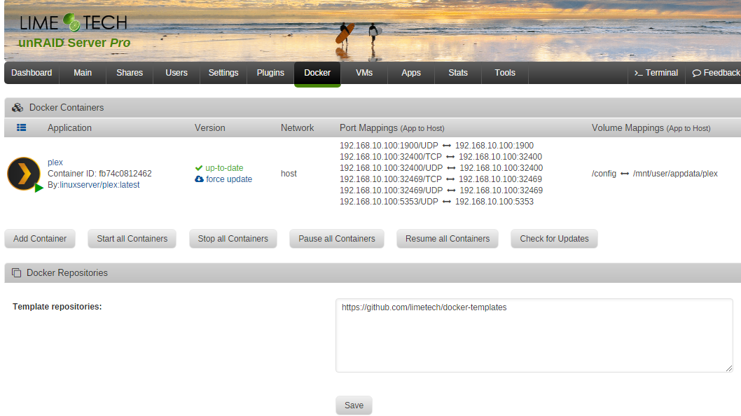

you know another weird thing is I have my main computer that i just booted up with a plus licence (i have a pro and plus licence).   I did the exact same steps and plex works on this computer.  I noticed the docker icon looks a little different, not sure if that is a hint or anything.   see how this one just says plex but the non working one says container ID and by linuxserver?

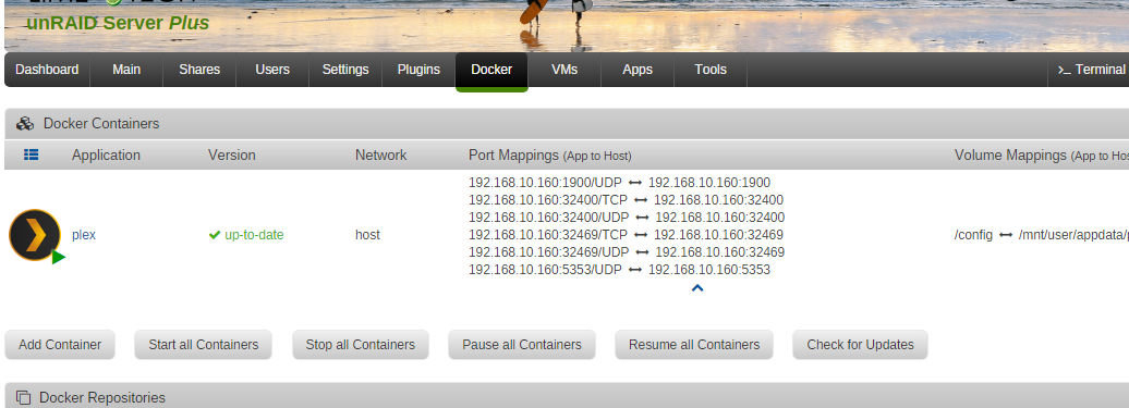

Yes but your config says it's on /mnt/user/appdata.
Sent from my BND-L34 using Tapatalk
I just uninstalled, then deleted the plex diretory from /mnt/user/appdata/plex and /mnt/cache/appdata/plex.   when i reinstall, it makes a directory /plex in BOTH those locations.  Is it maybe a setting I have wrong with the cache drive?
Your screenshot of volume mappings also says that you haven't mapped any of your media, so even if you get it running it won't be able to access any of your files.

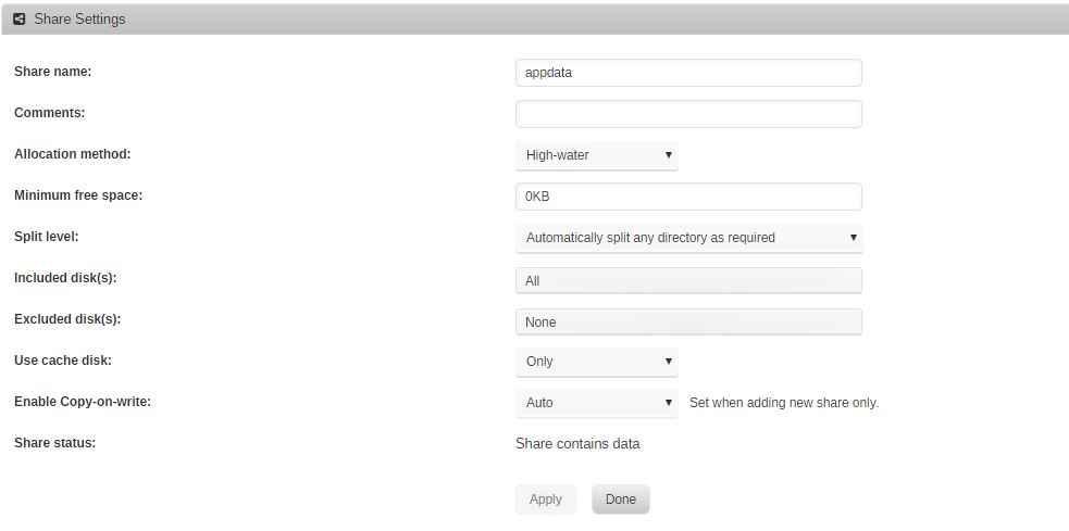

here is my appdata settings.. not sure if this has anything to do with it.  pretty much the only difference between the two systems is the cache drive, and of course the licence and some of the hardware :)
Edited by xman111
Just now, xman111 said:
here is my appdata settings.. not sure if this has anything to do with it.  pretty much the only difference between the two systems is the cache drive.
That looks fine, but I don't think anyone suggested that was your problem.
Post your logs when your start Plex, also like trurl stated your template doesn't show where your media is located.

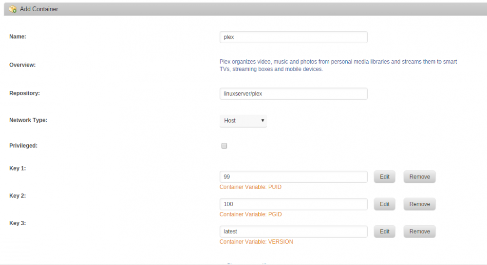

Looked at my config and notice that your template does not have the disclosure of what goes where in the template. How are you installing it?
I'm assuming via the Apps tab
ya, just installed via the apps tab..

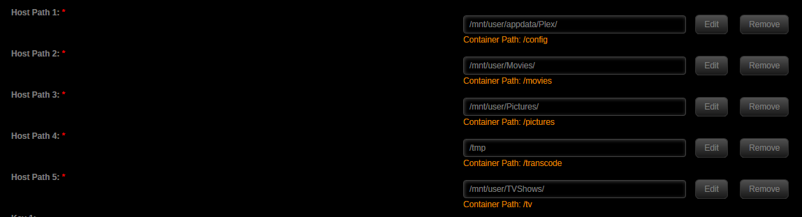

Xman - sorry I left you hanging.  I have been out for the last few hours.  Glad to see you have received help and made progress.

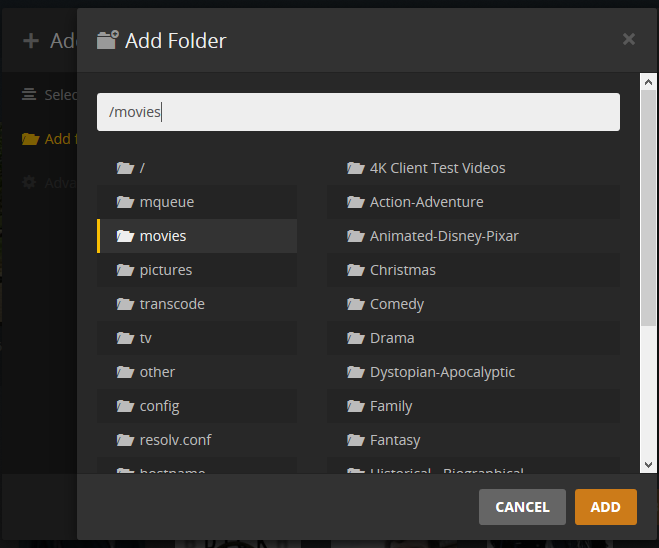

For reference, here are some of my mappings in Plex:
Then on the Plex side, to access movies for example, you would add a Library, specify the media type of Movies and then select the /movies folder as seen here:
