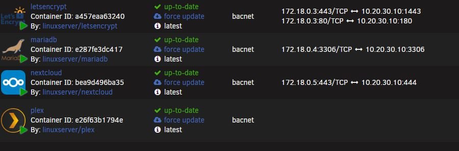

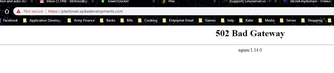

Hello Experts!
I have setup LE on a custom network.  I'm trying to setup reverse proxy for my plex (linuxserver plex).  I set plex up on the same custom network.
At this point I cannot reach plex through the web_ui.  I get "it's not reachable".  Also port mappings don't show like the other linuxserver containers do, is that normal?
Also I can't get the plex.subdomain.conf to work.  I've tried it with a host setting and can't get it to work.  I followed the instructions in the conf file to no avail.

With the custom network I'm not sure which settings to change, if it's even possible.
Edited by sgt_spike
10 hours ago, sgt_spike said:
Hello Experts!

If you do user defined bridge, you should use the proxy conf as is, without replacing the container name with the ip address.
You are trying to proxy through ip, but you didn't map any ports, so no connection
So set network back to the user defined network and add a port setting in the plex setup.  The port being 10.20.30.10:32400 to 172.18.0.6:32400.
If I have it wrong it's because your last statement is unclear to me.
i understand your first statement, is that in addition to your second statement or are they two separate setting types

They are either or.
If you do user defined bridge, don't modify the proxy conf and it should work (after you enable it by renaming).
If you do host networking or macvlan, replace the container name with the ip address.
What you tried to do above was mixing and matching. You had user defined bridge network, but you also tried to connect via ip of the host. However, because you did not map the container port on the host port, connection through host ip did not work.
On 9/25/2018 at 3:52 AM, aptalca said:
They are either or.
I got the containers port mapped to the host and it connects to the web_ui.  However I'm not sure why I keep getting a bad gateway error trying to connect with https://plex.spikedevelopments.com
