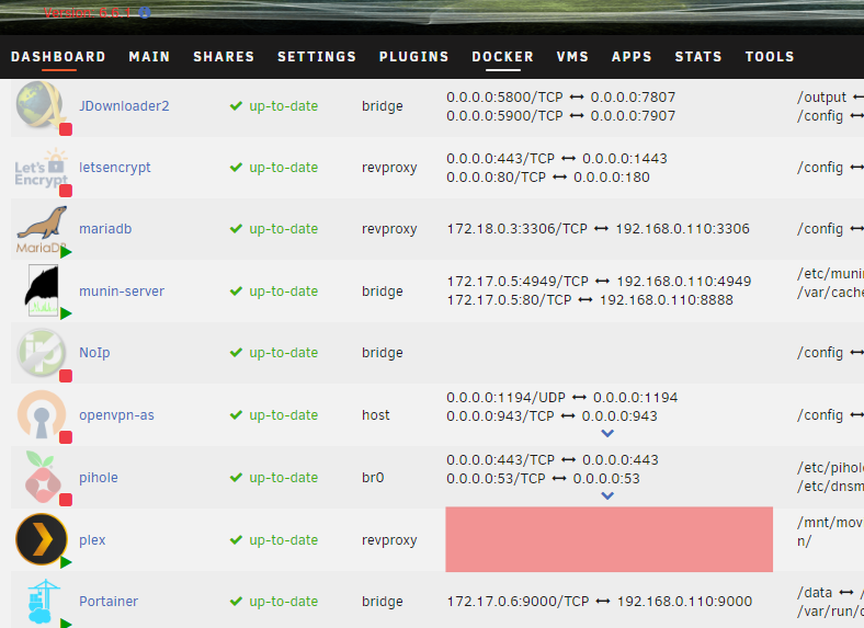

I followed [/url] guide to setting up reverse proxies and letsencrypt and wanted to get this to work for me with plex. I do the following:
  1. Create a CNAME for my domain called 'plex', so should be able to access plex through 'plex.mydomain.com' (not my real domain obviously)
  2. Put my duckdns domain + token into the DuckDNS container settings
  3. Setup port forwarding as described in the spaceinvaderone video (80 -> 180, 443 -> 1443)
  4. Setup a user defined network 'proxynet'
  5. Run letsencrypt using 'proxynet'
  6. Install linuxserver.io's plex container and make it use the 'proxynet' network
  7. Check that the plex.subdomain.conf file is set up correctly, shown below
I then try to run plex by clicking on the WebGUI option in the docker tab and my browser fails to open plex - I get 'Problem loading page' and the address bar at the top of the browser writes
http://172.18.0.4:32400/web. I cannot access the Plex GUI by typing 192.168.0.18:32400, https://plex.mydomain.com doesn't work either. In essence it does not seem to work in any other way than Host mode.
Any help would be really appreciated - just keep in mind that I'm not experienced and words like ports have only a vague meaning for me.

This should be posted in LE Topic.
What do you have as your network for plex docker? Host?
Post your plex LE config
Leave plex in host and in the plex LE proxy config change proxy pass from upstream to the ip of plex:32400

Which server are you referring to; plex, LE, unraid, and where in the proxy config file would I put the server's IP?  I have LE and plex running on the same user defined network (172.18.0.0).  It's my understanding that plex is then running in bridge mode, at this point.  If I'm wrong, please enlighten me :) !!!!
Below is the plex proxy config file I'm using.  it's the boilerplate version, I just renamed the file, taking off the .sample

Change plex back to host
In the proxy config change proxy pass upstream:32400
To ip:32400

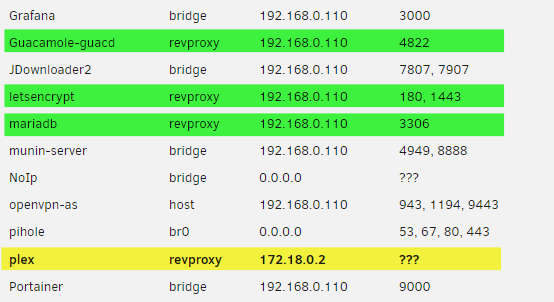

After following up the setup described here
linuxserver/plex docker IP:Port is not transated/mapped to the Uraid IP:Port.
Plex is reachable over the public web address, but not from my internal LAN.
Here are some print screens:
Docker tab: No address/port mapping for Plex.
Docker allocations:  the revproxy network ip is displayed, however there is no port mapping.
SSH Shell: docker network list
So far I had tried the following, without success:
- Changed the network of the docker to Bridge, as it was initially.
- Uninstalled Plex and reinstalled it from the custom templates.
- Rebooted Unraid server.
Notice that for the others docker containers which are in the custom docker network revproxy there is no issue.
Diag archive attached: node804-diagnostics-20181004-0146.zip
Edited by FlorinB
Thank you for posting this.
I am having the identical error and was going to do the screenshots, but yours is exactly it.
I noticed in the Docker Image the Exposed Ports are defined properly, but
NetworkSettings: Ports: {}, are empty.
I believe this is the cause of the issue.
It’s because the template is setup for host so no port needs map. If it gets changed to a different network then the port needs map so it is pass.
As I had already mentioned I had tried that already without success - Still same issue - Plex not reachable from local network.
Anyone ? Ideas/Solutions?
Sent from my iPhone using Tapatalk Pro
Why limit the template to a host-only network?
Or rather, may I submit a request to have the Ports populated in the NetworkSettings?
So you tried host and still can’t get to the GUI?
They probably set it up this way so it works right out of the box.

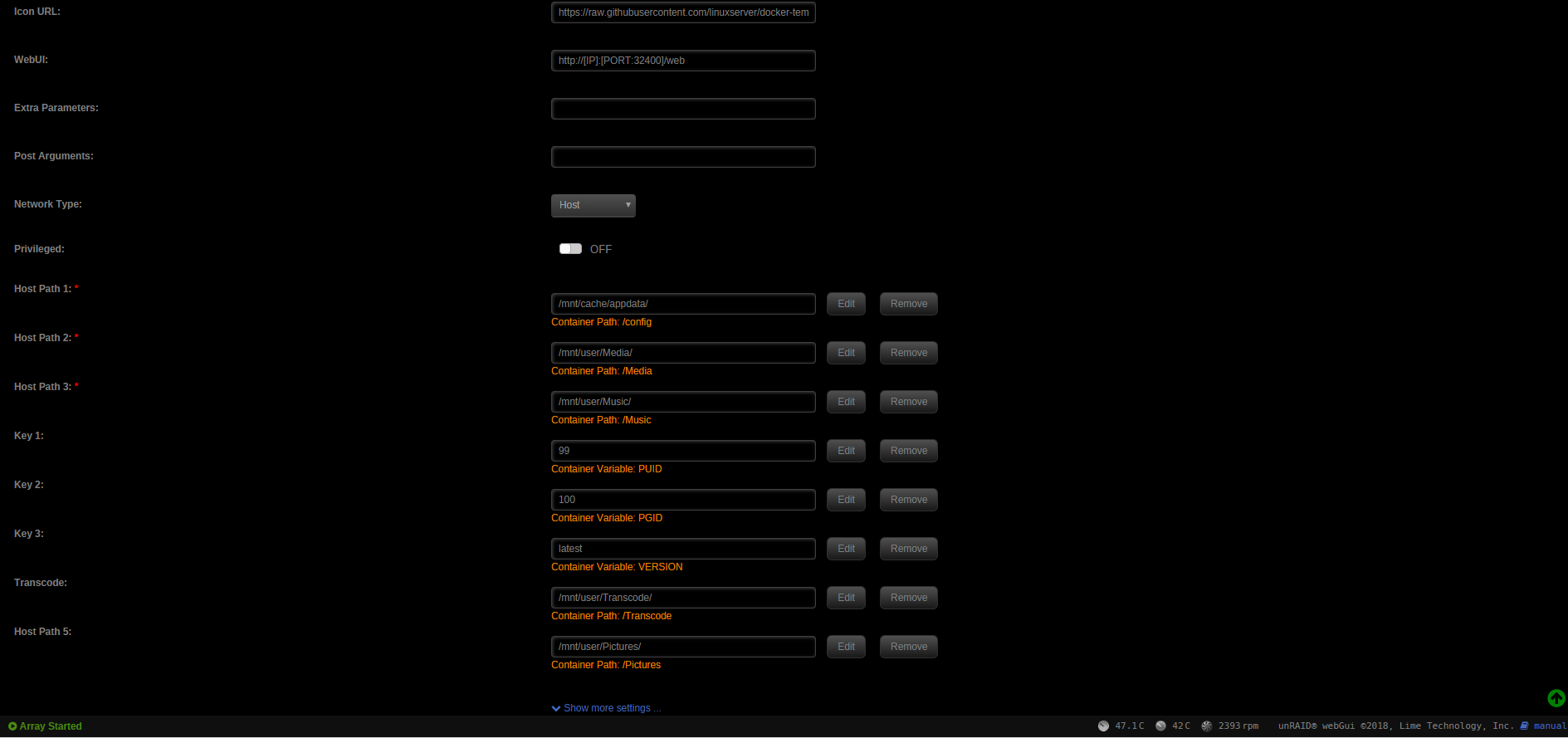

Post your docker template dockers>plex>edit

@H20_King89
My Have not touched my temples since I set up the docker years ago. I only messed with the version variable this morning as a last resort
