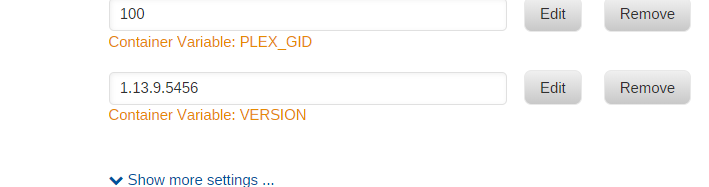

Hey All,
I need to roll back plex to the previous version.
@Squid gave me the following advice.
"You need to "tag" the repository with an appropriate version number instead of leaving it black (which defaults to :latest)  Ask in the particular support thread for what tag you should be utilizing."
How do I execute on this?
Are you asking for someone to tell you the previous version number so you can tag the repository with it, or, do you  know the version number and are asking for help in tagging it correctly in the docker?
If it is the former, go to the Plex Media Server announcements forum for release notes on all versions.  You can work back from the current version (at the end) to any version you think will solve your issues.
If it is the latter, see the GIthub or Docker Hub links in the first post of this forum and read the "Setting up the application" section.

@Hoopster Thanks for the help.
I went to the setting up section of those pages, but I don't see any option in my WebUI to change the version number like it's suggesting to do in the Setting Up Section.
Am I looking in the wrong place?
Are you looking in the Plex docker edit page?
You should see the VERSION variable there which you edit with the appropriate tag.
Ah ok, I did find it and was able to change it.  But after restarting the docker and logging out and back into the webui, the version is still 1.14.0.5465
When you applied the change and clicked on Done in the edit page, it should have executed the docker run command with the changes.  Did that happen?  To force the docker run command to appear again, make another edit in the Plex edit page (you can just change any variable, path etc. slightly and then change it back to its original value), click Apply and then Done and then copy the docker run command when it is finished running and post it here.
Yes, it did execute a docker run command. I forced it again for good measure, but it's still on the same version.
root@localhost:# /usr/local/emhttp/plugins/dynamix.docker.manager/scripts/docker run -d --name='PlexMediaServer' --net='host' -e TZ="America/Chicago" -e HOST_OS="unRAID" -e 'PLEX_CLAIM'='claim-cpzsQgMWvkqB7uW3qnSd' -e 'PLEX_UID'='99' -e 'PLEX_GID'='100' -e 'VERSION'='1.13.9.5456' -v '/mnt/user':'/mnt/user':'rw' -v '/mnt/user/appdata/plex/Plex Media Server/':'/config':'rw' 'plexinc/pms-docker:plexpass'
f8010f53a44ed3d95137304c335dfecd0a6d0e4ba6f4cae26d7dfca64834690
The command finished successfully!
That is not the complete version number. It needs to have some additional stuff at the end. It must correspond to the filename of the download from Plex. For example, the current version has filename 1.14.0.5465-xxxxxxxxx
Where do you find the full version number on this page?
https://forums.plex.tv/t/plex-media-server/30447/236

Thanks for finding that @wgstarks
I used that version number but it still is not changing the version on the webui general settings page.
root@localhost:# /usr/local/emhttp/plugins/dynamix.docker.manager/scripts/docker run -d --name='PlexMediaServer' --net='host' -e TZ="America/Chicago" -e HOST_OS="unRAID" -e 'PLEX_CLAIM'='claim-cpzsQgMWvkqB7uW3qnSd' -e 'PLEX_UID'='99' -e 'PLEX_GID'='100' -e 'VERSION'='1.13.9.5456-xxxxxxxxx' -v '/mnt/user':'/mnt/user':'rw' -v '/mnt/user/appdata/plex/Plex Media Server/':'/config':'rw' 'plexinc/pms-docker:plexpass'
8e45b193f3fd58c00d18a675e504aa1763dd0160d9bb3e91774c8832855f723
This is listed on Plex downloads page:

@cypres0099 my apologies for forgetting about the download identifier in my instructions.
