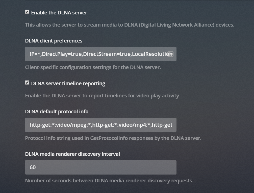

2 minutes ago, Xaero said:
I'm having trouble getting DLNA to work.
The network is set to HOST (as it is by default)
I've enabled DLNA in the plex settings.
I've enabled both of the advanced network options for unauthorized access and lan for 192.168.1.0/24 (my subnet/mask for the local network)
I don't see the plex media server listed in Windows 10 Explorer, Windows Media player or any other DLNA enabled stuff.
Any suggestions?
Top of my head, (but take with a grain of salt since I don't use Plex), but maybe you'll have to give Plex a static IP address in the template instead of having it set to HOST so that it winds up on the same network as everything else instead of on the default docker network.
  • Replies 6k
  • Views 1.3m
  • Dear Plex User, We have recently experienced a security incident that may potentially involve your Plex account information. We believe the actual impact of this incident is limited; however, action i
  • Go to the appdata share and look in Plex\Library\Application Support\Plex Media Server\Crash Reports You will find folders for your previous versions named as the release version.
  • Yep, seems like the problem.   Not to be outdone... google.  And what do I find.... Hoopster's post from over a year ago. I see your post here regarding the iGPU not being enabled corr
I have DLNA working here with Plex set as host. But could it be that there are something else using port 1900, so Plex can't bind to it?
Any suggestions?
I have some default settings like this
Now if you are speaking about Windows 10. Do a test, just disable the Firewall and the DLNA server should show up. Then start troubleshooting what is being blocked and what not. Maybe you have to create a rule in the windows firewall to allow connections from the plex.
Interesting, I put the IP=*,DirectPlay=true,DirectStream=true and stopped/started. It kind of showed up, then disappeared. I removed that line, and restarted DLNA again; this time it shows up under "This PC" on my Windows 10 client, and I can open files with Media Player - but the audio is a garbled mess. Not sure what to do about that lol.
I knew it was something between those lines.
This is what I have
DLNA client preferences
IP=*,DirectPlay=true,DirectStream=true,LocalResolution=1920x1080,RemoteResolution=1280x720,OnlineResolution=1280x720,LocalVideoQuality=74,RemoteVideoQuality=49,OnlineVideoQuality=49,SubtitleSize=100,AudioBoost=100,MusicBitrate=64
DLNA default protocol info
http-get:*:video/mpeg:*,http-get:*:video/mp4:*,http-get:*:video/vnd.dlna.mpeg-tts:*,http-get:*:video/avi:*,http-get:*:video/x-matroska:*,http-get:*:video/x-ms-wmv:*,http-get:*:video/wtv:*,http-get:*:audio/mpeg:*,http-get:*:audio/mp3:*,http-get:*:audio/mp4:*,http-get:*:audio/x-ms-wma*,http-get:*:audio/wav:*,http-get:*:audio/L16:*,http-get:*image/jpeg:*,http-get:*image/png:*,http-get:*image/gif:*,http-get:*image/tiff:*
DLNA media renderer discovery interval
60
DLNA server announcement lease time
1800
DLNA server description icons
png,jpeg;260x260,120x120,48x48
But bro, don't use media player for that. Go to the plex website or download the plex player. If you have a smart tv, use the plex app. Honestly don't stress too much about it. Because it's likely an issue with the firewall or the settings in the computer .
Yeah I figured out why that was as well. The DLNA tells media player what to try to do. So since my setup is Stereo on this PC and the audio from the file is usually 5.1 or higher - I just get garbled mess. It doesn't do any transcoding or anything. So I'll just go back to how I was watching stuff locally - browsing through the share and opening it in MPV.
Use the browser or download the plex media player that should do it

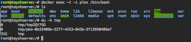

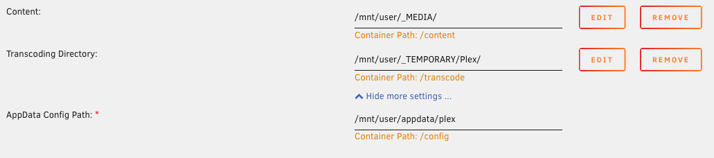

Am I doing something wrong here? I seem to have to boost the size of my docker.img file every few weeks to account for a growing Plex container. Right now I'm up to about 33GB (with my docker.img size at 40GB). From what I can tell, I have everything setup to be outside of the container.. however note that originally I had the transcode folder setup to run in the container. I have since moved that.
Usage:
CONTAINER ID     IMAGE                COMMAND     CREATED             STATUS              PORTS        NAMES               SIZE
b92f3afec57d     linuxserver/plex     "/init"     2 weeks ago         Up 21 minutes                    plex                32.6GB (virtual 33GB)
Anyway, let me know if you see any problems with my setup:
2094038824_ScreenShot2018-12-13at11_06_11AM.thumb.png.35c369f18eaedb9a38404e43ae80d306.png
Thanks in advance, let me know if any more information is needed!
Usage:
My plex container size is less than 500MB. My media library is probably somewhat smaller than some. But it does seem like you have something wrong.
On the Docker page, what do you get when you click the Container Size button?
Clicking the Container Size button get's me the following:
Name                              Container     Writable          Log
plex                                33.0 GB      32.6 GB       495 kB
binhex-krusader                     2.29 GB      30.3 MB       468 kB
radarr                               658 MB      76.6 MB      23.7 MB
ombi                                 633 MB       224 MB       486 kB
sonarr                               617 MB      39.1 MB      29.2 MB
glances                              615 MB       355 kB        130 B
duplicati                            598 MB       301 kB      7.30 kB
DDclient                             315 MB       1.3 MB      2.73 MB
letsencrypt                          294 MB      55.5 MB      17.1 kB
sabnzbd                              268 MB       301 kB       220 MB
tautulli                             234 MB      45.4 MB      1.76 GB
openvpn-as                           221 MB       1.2 MB      9.56 kB
telly                                124 MB          0 B      5.89 MB
transmission                        37.4 MB      6.47 kB       506 kB
Seems like all my other container are within reason except for Krusader which probably just needs a trashcan emptied or something.. Interesting. Is there a way I can browse the containers filesystem to see where all that space is being used?
Appreciate the reply

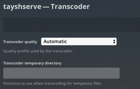

In the plex application, what do you have set for the transcoder directory?

6 minutes ago, tayshserve said:
`transcode` or `/transcode`?
/transcode to match the specified container path.
According to Plex (and they should know 😀), when no transcode directory is defined, Plex defaults to {path to Plex appdata}/Library/Application Support/Plex Media Server/Cache/Transcode
which would be on mapped Unraid storage so that doesn't seem like it should be the problem. And in fact, I am just using that default myself, but seldom transcode. Might be worth setting it to /transcode though just to see if it makes a difference.

Yep I was under the impression that Plex was transcoding to /tmp by default. When I look into the container file structure, it seems like /tmp is the culprit. That bad boy is 31GB but just contains a bunch of XML files. Not sure what these are or how to actually move them elsewhere.. but it seems like I'm missing some kind of path map here.
Update – so I opened one of the XML files from the tmp directory and it seems to be live TV guide data from schedules direct? Wondering if it's safe to just delete this stuff.. I'm honestly not even sure where this data is coming from as I use the EPG data from Plex/Gracenote, not schedules direct.
Update 2 – alright.. I spot checked a bunch of the files and saw they were all schedules direct data.. I was going to back this stuff up but figured since it's in a temporary directory I should be fine. I deleted all the XML files and restarted Plex. My container size dipped down to under a GB. I guess I'll monitor the situation to see what happens.. but I honestly cannot explain how all that crap got dumped into that folder. The only thing I can think of is at one point maybe I tested using schedules direct? Even so.. 30+GB?
Annnnd in the middle of typing the above I noticed that the tmp folder has begun to fill up again... with data from schedules direct?
Edited by tayshserve
What is the Plex folder associated with your TV Shows library?  You will have to delete your Plex DVR and recreate if you want to change EPG settings.  I use the HDHomeRun EPG.  It appears the DVR still thinks its using Schedules Direct?
I have my Plex transcode set to use /tmp as the host path with /transcode as container path.  /tmp if properly configured is RAM.
