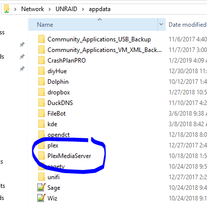

Not sure this is related, but should I be seeing two Plex folders like this this:

30 minutes ago, btrcp2000 said:
It's as if Plex sees a different set of folders than UNRAID does?

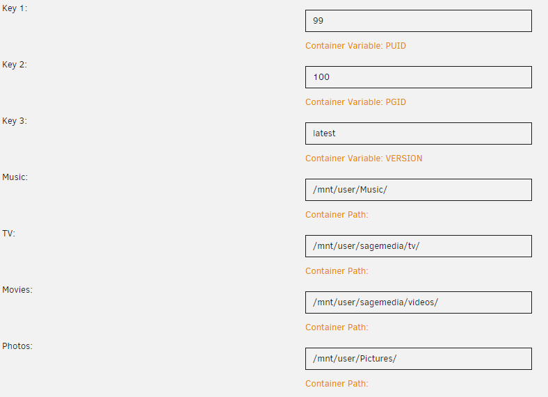

Yes, that's the way it works.  Dockers have their own "file system" and this has to be mapped to the host (unRAID) file system.
You need to create volume mappings in the docker that map host paths to container paths.
Your screen shot only shows partial information.  What are the container paths that correspond to your host paths?
In the Plex Server when creating a library, you browse to the corresponding container path to select the folder (/movies, /tv, etc.) not to the host path (/mnt/user/Movies).

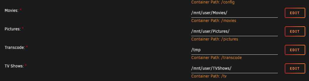

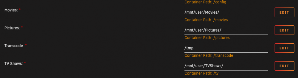

Here are my mappings, for example:

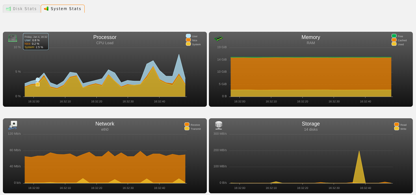

Damn it, 3-4 cores still getting pegged at 100% for some reason and my LOCAL plex stream froze when this happened. This makes plex unusable. Guys what do I do and why is this happening? All dockers except plex are pegged to 1 core. I don't know what's going on. Should I start a separate thread on this?
Also the docker CPU utilization (on the docker page) doesn't add up anywhere close to 100% that the CPU is getting to. Is this correct that's it's showing most of my 16 gigs of ram is being used? Not sure if that's an issue, figured I would post this screen shot
