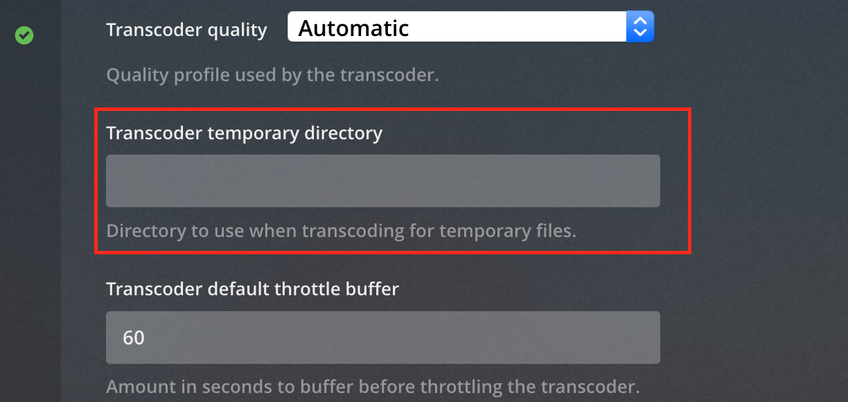

I've just reinstalled Linuxserver's plex docker after my server randomly decided to delete all of my dockers and vms; however, I cant seem to remember what I should do with the "transcoder temporary directory" setting. By default it's blank, but I cant find anything  telling me where the default location is. Does anyone know where the default transcoder directory is????
I want to make sure that my transcoder directory is on my SSD cache.
Edited by ImBadAtThis
typo
If you leave it blank it defaults to {path to your Plex folder in appdata}/Library/Application Support/Plex Media Server/Cache/Transcode
If your appdata share in on an SSD, it will transcode on the SSD.
If you have created a transcoder volume mapping in the Plex docker, then enter the specified container path as your Transcoder temporary directory.

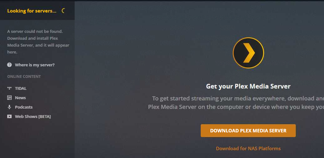

Hey, this wasn't happening before.
I noticed that after an update. My server stopped showing up in some computers. It's confusing, I can still access using my TV, my phone, outside my network.
The message I get is this.
Honestly, this doesn't make sense to me.
Share this post
Link to post
Have you tried signing out of plex and signing in again? That usually works for me.
