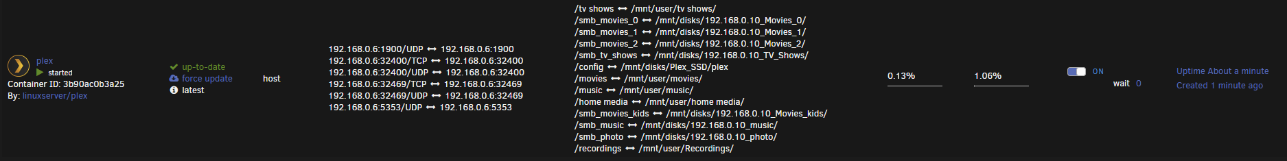

Sorry isn't this the docker mount that I posted?
The mount is: image.png.a78e3a25ac7a473d7542ecb5010ac5e7.png - Thats in the docker UI
Not sure I know what you mean?
Look at the forum settings, make sure signatures are switched on and you'll see a link in my sig to Docker Run Command.
That's what we need to see.
Sorry here you go:
What does the privileged setting do? Is it like setting a Higher process priority than the other Dockers?
Again thanks for your time!

Is that SMB mount actually mounted currently in Unassigned Devices? Post a screenshot of that.

6 minutes ago, casperse said:
Sorry here you go:
Sorry, I realise now you actually had posted the relevant info originally.  I missed it.
So what is the issue?  You can't browse from Plex (Docker container) - Host (Unraid) - SMb Share (Different Machine)
Probably a limitation of the SMB layer I would imagine.  Not something I've ever tried, but I'd be surprised if nobody else has.
The --privileged flag gives all capabilities to the container, and it also lifts all the limitations enforced by the device cgroup controller. In other words, the container can then do almost everything that the host can do.
