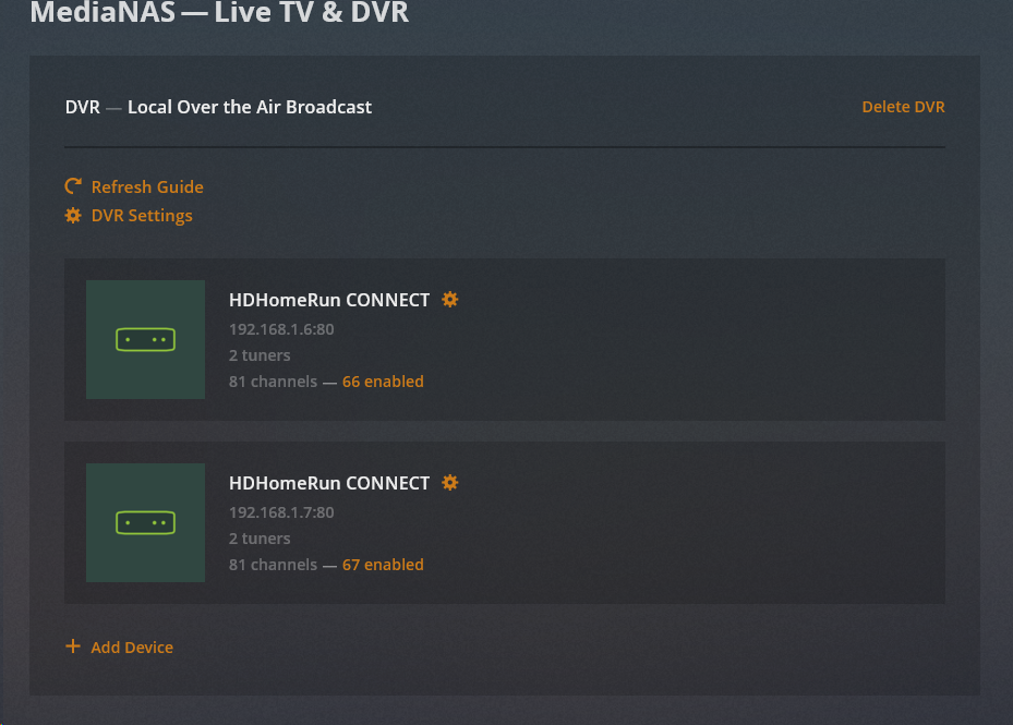

Yes, there are different HDHomeRun models.
I have two dual-tuner Connects on my network, each connected to a separate antenna.  They also make a unit with 4 tuners and one that works with cable cards.  The Extend model has built-in encoders which produces smaller recordings and takes the encoding burden off of the server.  The Connects work just fine for me as my server handles the encoding without problem.
The HDHomeRun units connect to the LAN, not to a TV.  In fact, they do not have to be anywhere near a TV.
I have the HDHomeRun app on every streaming devices in the house; TVs, computers, iOS and Android phone, iPads.  The app just picks an available tuner from the four I have to watch TV.  For recording, I use the Plex DVR instead of the HDHomeRun DVR.
Again, the only connections the HDHomeRun units have are an antenna in coax connection and an RJ45 Ethernet port for connecting to the LAN.  Any device on the LAN can access any available tuner.  I can even access the tuners remotely via Plex Live TV and DVR.

I have added both Connects in Plex, so, yes, it has all four tuners available to it.  I choose to use the HDHomeRun app for watching TV on my local LAN.  For me, it is just a bit easier, but, you could certainly do it through Plex as well.  In fact, it is only way to watch TV/streaming media remotely.  As I said, Plex does have a very good channel guide.
Of course, all recorded media is viewed through Plex.  You can do it all with Plex if you choose.

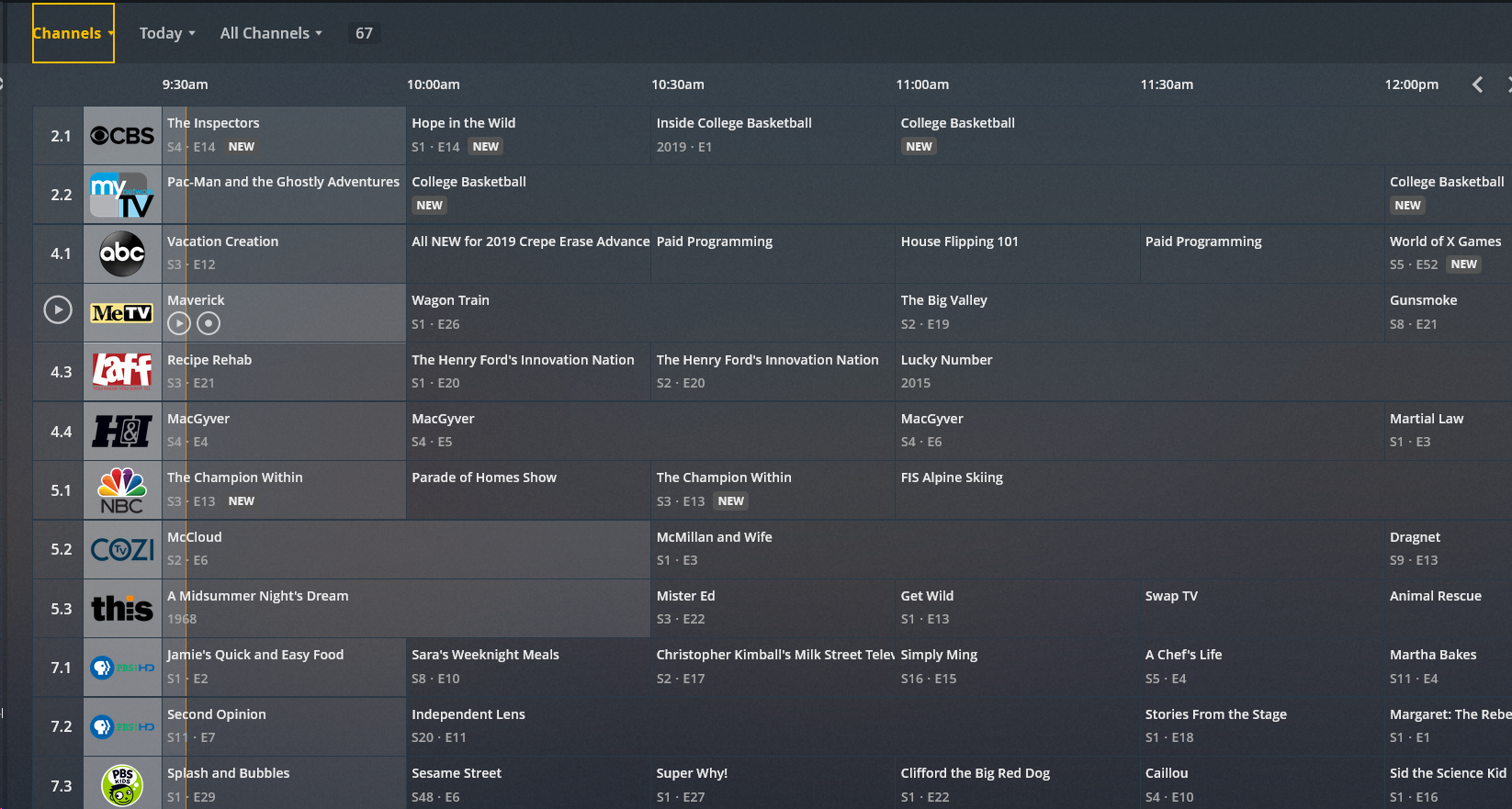

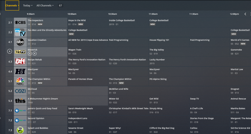

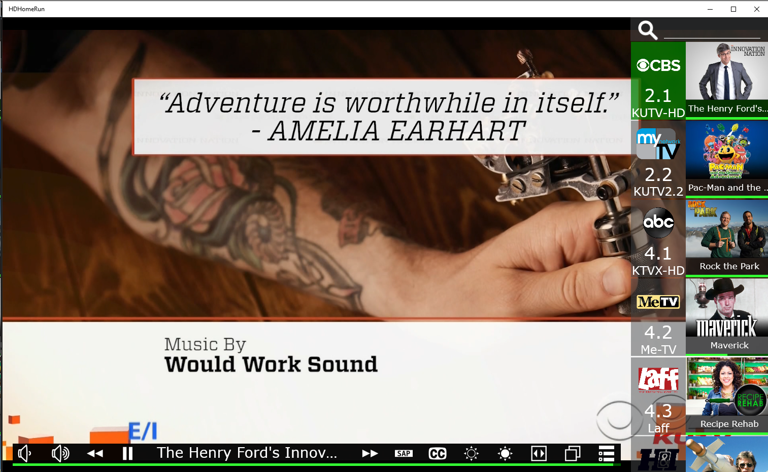

Here's the channel guide in the HDHomeRun app.  It pops up on the right of the screen (it has pop outs to show upcoming shows on each channel):
Here's the Plex Channels view in the channel guide:
