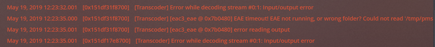

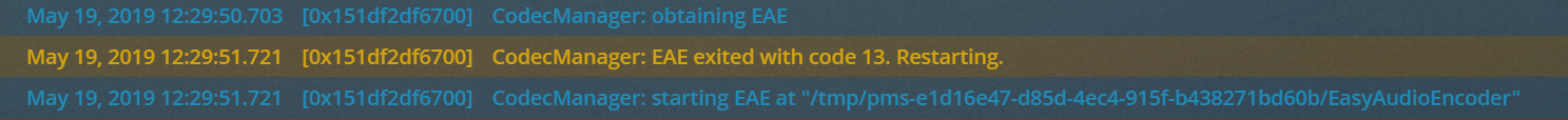

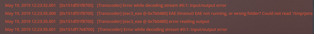

2 minutes ago, gacpac said:
Today I'm trying to play something in plex and I'm getting this error from the logs.
And I have other movies using AC3 codec that work fine. I'm kind of confused.
Okay I deleted the audio codec and now it plays.
But I still got this error, should I be worried?

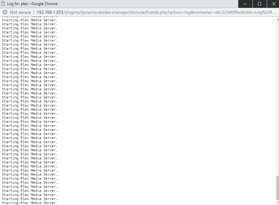

Hello guys,
since like some days my plex is acting weird. The playback of most of the stuff on my server doesn't work correctly and when I look into the docker container log, it shows this:

These connect: Connection refused messages come up when I try to playback things and all acting choppy...
Never had issues before. Does someone have a clue?
Thanks in advance!

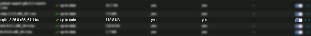

This script requires SQLite3 if you do not have it installed:
1. Go to Community Applications
2. Install the Dev Pack
3. Go to "Settings" in UNRAID
4. Open Dev Pack
5. Enable (install) SQLite3
6. Retry pmsDB.sh

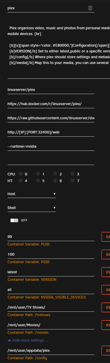

5 hours ago, dbinott said:
Gladly give it, but the OP does not state what you would require.
I can give you this. What else do you require?
Unraid 6.7.0 nvidia version
Assuming this is a fresh install, go to http://unraidip:32400/web from a computer that is in the same network subnet as unraid
If the subnet is different, you can use the ssh tunnel method described at the bottom of this page under on a different network: https://support.plex.tv/articles/200288586-installation/
