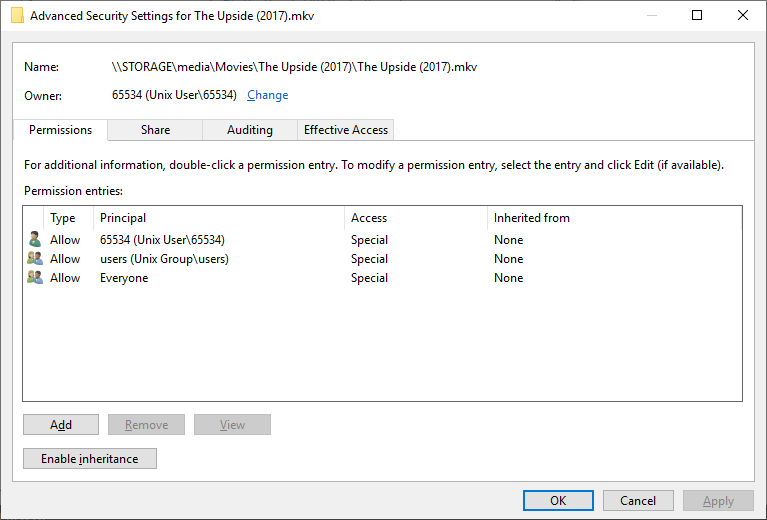

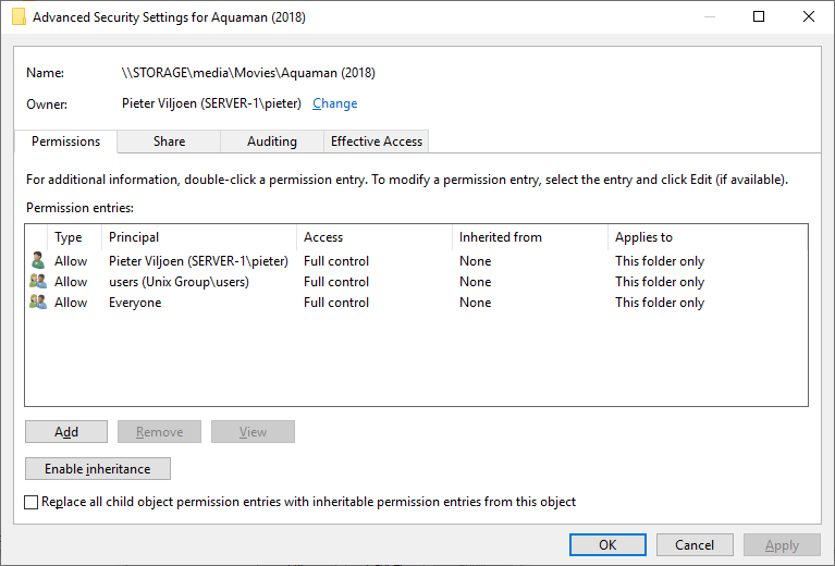

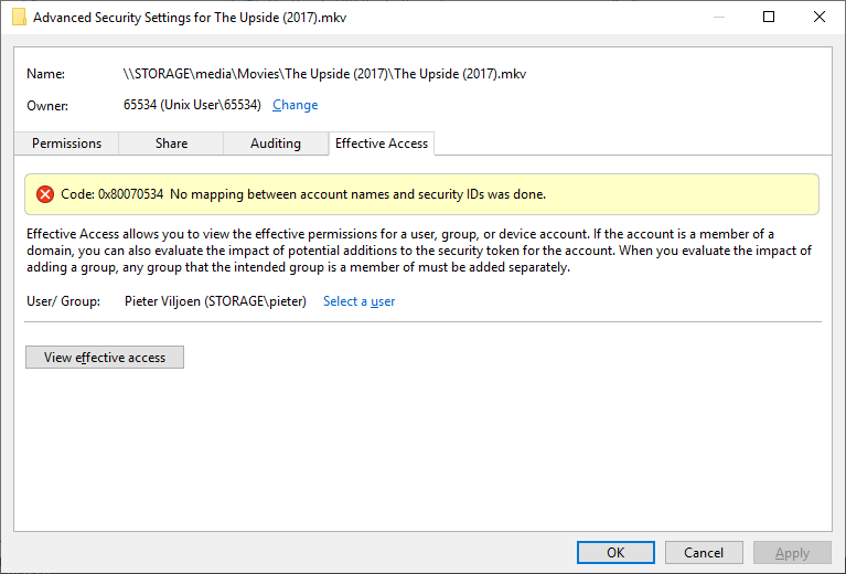

Hi, I am unable to delete the "Plex Versions" folder created by Plex from my SMB share.
Per google my problem with this is not unique, but I did not find a conclusive answer on how to prevent it from happening, vs. chmod to restore access.
Unraid share: /media
Permissions set to private, RW access for user "Pieter"
SMB accessed from Win10 via user "Pieter"
All media originally copied from a W2K16 server using robocopy.
Typical permissions of content coming from my SMB account:
root@Server-1:~# ls -la /mnt/user/media/Movies/Aquaman\ \(2018\)
-rw-rw-rw- 1 pieter users 15260151084 Mar  5 08:19 Aquaman\ (2018).mkv
Plex, Sonarr, Radarr, all LSIO Docker, configured to run with UID 99 / nobody and GID 100 / users.
All have a /media path mapped to my /mnt/user/media share.
Example of content created by Radarr or Sonarr:
root@Server-1:~# ls -la "/mnt/user/media/Movies/The Upside (2017)"/
-rw-rw-rw- 1  65534 users 11738762701 Jun  1 00:18 The\ Upside\ (2017).mkv
Example of content created by Plex, that I cannot delete from user pieter over SMB:
root@Server-1:~# ls -la "/mnt/user/media/Movies/Aquaman (2018)"
drwxr-xr-x 1 nobody users          38 May 26 11:23 Plex\ Versions/
root@Server-1:~# ls -la "/mnt/user/media/Movies/Aquaman (2018)/Plex Versions/"
drwxr-xr-x 1 nobody users   6 May 26 11:23 Optimized\ for\ TV/
The view from Windows:
C:\Users\piete>icacls "\\STORAGE\media\Movies\Aquaman (2018)\*.*"
\\STORAGE\media\Movies\Aquaman (2018)\Aquaman (2018).mkv S-1-5-21-9595238-3571069986-2878196060-3000:(R,W)
                                                         S-1-22-2-100:(R,W)
\\STORAGE\media\Movies\Aquaman (2018)\Plex Versions S-1-22-1-99:(F)
                                                    S-1-22-2-100:(RX)
                                                    Everyone:(RX)
C:\Users\piete>icacls "\\STORAGE\media\Movies\The Upside (2017)\*.*"
\\STORAGE\media\Movies\The Upside (2017)\The Upside (2017).mkv S-1-22-1-65534:(R,W)
                                                               S-1-22-2-100:(R,W)
                                                               Everyone:(R,W)
The content created by Sabnzbd / Sonarr / Radarr are created under user 65534, and I don't know what this user is, or why it is not the UID nobody that was specified by the container UID setting?
Anyway, I can modify this content since the Windows SMB user has Write rights.
We can see that the Plex created "Plex Versions" folder only grants Read and Execute rights to the Windows\Everyone group and the Linux\users group, and full rights to the Unix\nobody user.
his means that I can read the folders created by Plex from Windows, but I cannot delete them.
How should I be configuring my containers, and specifically Plex, such that the content created by Plex, can be modified by other users over SMB?

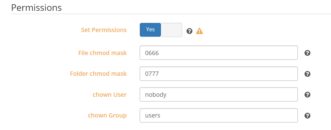

@ptr727 I just remembered why I don't get problems anymore.
There's a setting inside sonarr and radarr respectively. I don't know if Sabnzbd has that function.
That should do it 100%
Have you set this up?
Share this post
Link to post
I am setting permissions in Sonarr and Radarr, just like yours, but it does not explain the weird user id.
