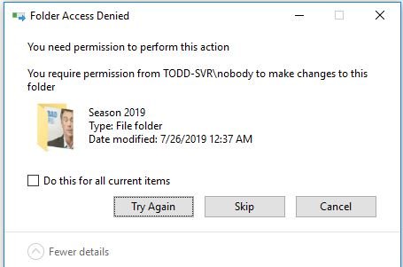

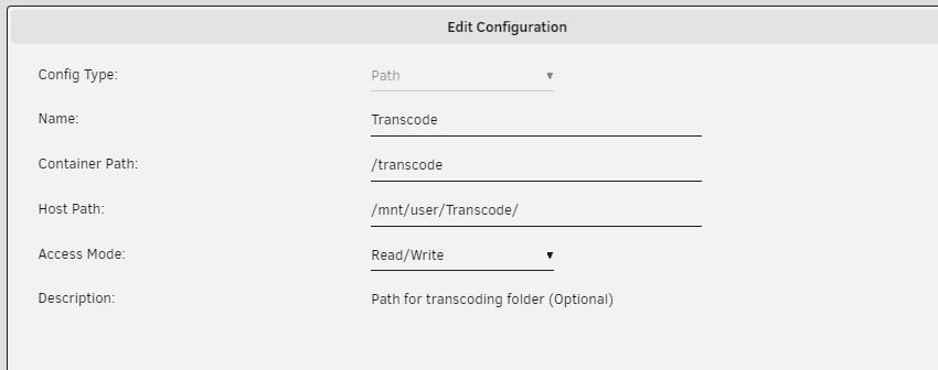

July 26, 20197 yr So last night I migrated over to the Linuxserver.io docker from Limetech. Everything came up just as I was looking for. However, I have one issue, and one question.... Issue: Any DVR recorded file is being setup with the username "nobody" and I can't delete any of the video files created until I run the "new permissions" utility. This happened once before I can't for the life of me remember what I did to fix it. (see image) Question: How do I confirm where transcoding is taking place (temp folder)? In the Linuxserver.io docker settings it is set to mnt/user/transcode... The "Transcode" is on my cache disk only. Inside Plex, the transcoder settings originally had \\cache\transcode. When I first tried to record after the new install, I was out of space errors. The \\cache\transcode would seemingly be a bad pathway, I can't recall when I plugged that in and it must have been held over from the old setup. However, it was working previously. I deleted that pathway in the Plex transcode setup, and the errors went away. Here is the question: Where is it transcoding to? With the actual plex software transcode location blank, is it respecting or using the location designated in the docker? I do want it using the cache drive for transcoding, there is plenty of room. Thanks in advance for any help.
July 26, 20197 yr 6 hours ago, TODDLT said: How do I confirm where transcoding is taking place (temp folder)? Whatever container path you set in the docker configuration should match exactly to what you use in Plex settings. If the container path is /transcode then you would enter /transcode for your transcode location in Plex. This will result in transcoding in whatever host directory you have configured in the docker. /mnt/user/transcode in your example.

July 27, 20197 yr Still working through some bugs since installing Linuxsever.io Plex. I had two movies streaming from Plex. 1 was being transcoded, one direct play. Nearing the end of both, I get this warning on unRaid. It crept up to 83% until the first movie stopped and then I got a "return to normal" message. Docker high image disk utilization: 2019-07-27 10:05 Warning [-SVR] - Docker image disk utilization of 80% Docker utilization of image file /mnt/cache/Dockers/docker.img I can't find anywhere to raise the size of the size of the image file or space allocated. The Cache drive is 250GB and only 24GB used by dockers. I'm sure transcoding is taking up some space but how could that possibly fill that drive? Any thoughts appreciated. EDIT: I found this, but no idea how to increase the size of a container of if that is the issue The old Plex is not running, just haven't removed it yet, but I do notice it's a bigger container. I had as many as 4 or 5 streaming continuously before and never had that warning. Name Container Writable Log --------------------------------------------------------------------- binhex-krusader 2.23 GB 18.9 MB 66.2 kB binhex-minidlna 1.42 GB 1.49 MB 598 kB DiskSpeed 939 MB 1.21 MB 29.1 kB PlexMediaServer 526 MB 354 kB 229 kB PlexLinuxserver.io 355 MB 309 kB 4.33 kB tautulli 256 MB 122 MB 3.04 MB Edited July 27, 20197 yr by TODDLT
July 27, 20197 yr 58 minutes ago, TODDLT said: Still working through some bugs since installing Linuxsever.io Plex. I had two movies streaming from Plex. 1 was being transcoded, one direct play. Nearing the end of both, I get this warning on unRaid. It crept up to 83% until the first movie stopped and then I got a "return to normal" message. Docker high image disk utilization: 2019-07-27 10:05 Warning [-SVR] - Docker image disk utilization of 80% Docker utilization of image file /mnt/cache/Dockers/docker.img I can't find anywhere to raise the size of the size of the image file or space allocated. The Cache drive is 250GB and only 24GB used by dockers. I'm sure transcoding is taking up some space but how could that possibly fill that drive? Any thoughts appreciated. EDIT: I found this, but no idea how to increase the size of a container of if that is the issue The old Plex is not running, just haven't removed it yet, but I do notice it's a bigger container. I had as many as 4 or 5 streaming continuously before and never had that warning. Name Container Writable Log --------------------------------------------------------------------- binhex-krusader 2.23 GB 18.9 MB 66.2 kB binhex-minidlna 1.42 GB 1.49 MB 598 kB DiskSpeed 939 MB 1.21 MB 29.1 kB PlexMediaServer 526 MB 354 kB 229 kB PlexLinuxserver.io 355 MB 309 kB 4.33 kB tautulli 256 MB 122 MB 3.04 MB You have configured the transcode path in plex wrong and set it to a path inside the container.
July 27, 20197 yr 6 minutes ago, saarg said: You have configured the transcode path in plex wrong and set it to a path inside the container. They are both on the cache drive, but different folders. Transcode is /mnt/user/Transcode/ Transcode is located solely on the cache drive. Docker is located /mnt/user/appdata/PlexMediaServer/ appdata is also solely on the cache drive. Is there something else I should be looking for? Edited July 27, 20197 yr by TODDLT

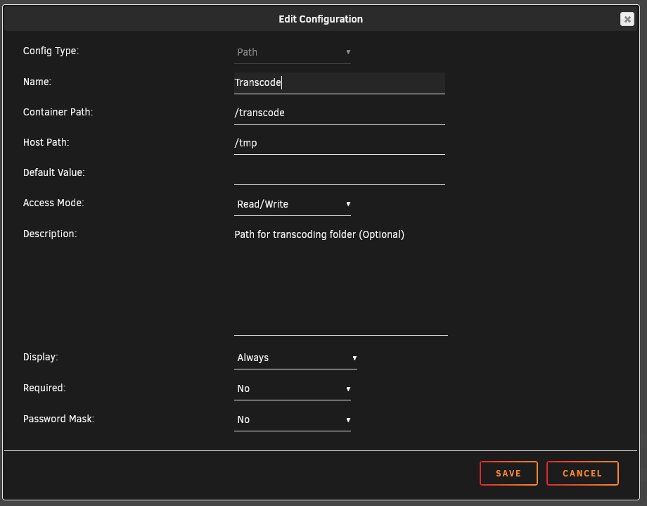

July 27, 20197 yr I just updated the Plex docker to Version 1.16.3.1433 (Unraid is running Version: 6.7.2) After the Plex update I get this error: I have plenty of room so this is not the problem. I have Plex stored on another special SSD and had no problem Could it be the transcoding folder? (I have never used it, default is fine)? I am using HW acceleration and it look to be running okay? Hope someone can share some light on this.... UPDATE: Where does it save the transcode files? (It's not on my cash drive) plenty of room Index of /mnt/cache/appdata/plex/Library/Application Support/Plex Media Server/Cache So it must be on my Appdata drive? /mnt/disk/SSD/plex (But the folder is empty) /mnt/disks/SSD/plex/Library/Application Support/Plex Media Server/Cache/Transcode I would like the speed so either defining a specific location in the docker Path for transcoding folder (Optional)? On a SSD? or my cash drive? any recommendations from the power users ? Edited July 27, 20197 yr by casperse
July 27, 20197 yr 4 hours ago, TODDLT said: They are both on the cache drive, but different folders. Transcode is /mnt/user/Transcode/ Transcode is located solely on the cache drive. Docker is located /mnt/user/appdata/PlexMediaServer/ appdata is also solely on the cache drive. Is there something else I should be looking for? Post your docker run command and a screen shot of the transcoding path in plex.
July 27, 20197 yr 1 hour ago, casperse said: I just updated the Plex docker to Version 1.16.3.1433 (Unraid is running Version: 6.7.2) After the Plex update I get this error: I have plenty of room so this is not the problem. I have Plex stored on another special SSD and had no problem Could it be the transcoding folder? (I have never used it, default is fine)? I am using HW acceleration and it look to be running okay? Hope someone can share some light on this.... UPDATE: Where does it save the transcode files? (It's not on my cash drive) plenty of room Index of /mnt/cache/appdata/plex/Library/Application Support/Plex Media Server/Cache So it must be on my Appdata drive? /mnt/disk/SSD/plex (But the folder is empty) /mnt/disks/SSD/plex/Library/Application Support/Plex Media Server/Cache/Transcode I would like the speed so either defining a specific location in the docker Path for transcoding folder (Optional)? On a SSD? or my cash drive? any recommendations from the power users ? Post your docker run command. The default transcoding path is somewhere in the app data folder.

July 27, 20197 yr Just a heads up to both of you, mapping the /transcode location is not enough. You also need to go into Plex server settings in the gui and select /transcode as the transcode location Edited July 27, 20197 yr by aptalca
July 27, 20197 yr 40 minutes ago, aptalca said: Just a heads up to both of you, mapping the /transcode location is not enough. You also need to go into Plex server settings in the gui and select /transcode as the transcode location I have the same pathway set in the docker, and inside the transcode settings in the Plex GUI.
July 27, 20197 yr 3 hours ago, saarg said: Post your docker run command and a screen shot of the transcoding path in plex. Where do I find the run command? Isn't this set up in the background? I didn't create a command to run the Plex Docker. The transcode path in the docker is identical to what you see in the plex image attached.
July 27, 20197 yr 32 minutes ago, TODDLT said: Where do I find the run command? https://forums.unraid.net/topic/57181-real-docker-faq/?tab=comments#comment-564345
July 27, 20197 yr 1 hour ago, TODDLT said: Where do I find the run command? Isn't this set up in the background? I didn't create a command to run the Plex Docker. The transcode path in the docker is identical to what you see in the plex image attached. That needs to be set to /transcode exactly
July 27, 20197 yr 1 minute ago, aptalca said: That needs to be set to /transcode exactly ahh, OK so the docker settings correlates /transcode to /mnt/user/transcode... yes?
July 27, 20197 yr 26 minutes ago, TODDLT said: ahh, OK so the docker settings correlates /transcode to /mnt/user/transcode... yes? It depends on what you set as the host path in Plex docker container. Whatever you set as the Container Path is what you enter in the Plex server as the "Transcoder temporary directory" In my case, and probably yours, that is /transcode. That happens in my case to map to /tmp (RAM) on the unRAID server. If you set the host path to /mnt/user/transcode that is where transcoding will take place on your server when you tell Plex to use /transcode.
July 27, 20197 yr 31 minutes ago, TODDLT said: ahh, OK so the docker settings correlates /transcode to /mnt/user/transcode... yes? It will link to whatever you have set for the host path.
July 27, 20197 yr 11 minutes ago, wgstarks said: It will link to whatever you have set for the host path. got it.. yes makes sense now Thanks all
