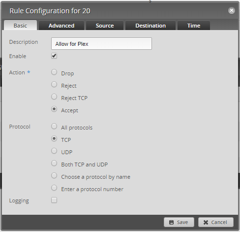

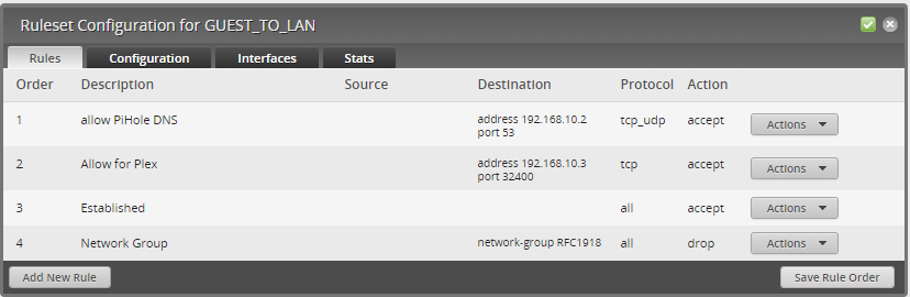

I'm having trouble getting the Plex to be found outside of the network.
I'm using "Network Type" Custom: br0
I've assigned Plex it's own IP address in the Secure LAN of my network.
I can only watch TV/Movies when connected direclty to that network.
Should I not have used "Custom: br0" ?
I can't find any explanation of why you would use the differnet "Network Types". Most posts focus on the shares which I have working properly.
Share this post
Link to post
Have you forwarded port 32400 to the applicable IP in the router?
Share this post
Link to post

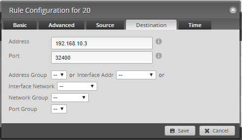

So I added a rule to ALLOW TCP to DESTINATION address 192.168.10.3 (my Plex server on unRAID) and port: 32400.
Am I setting this up wrong? What IP do I need to open the port for? The Roku's or the Plex server's?  Or my unRAID's server? And is it a "DESTINATION" or a "SOURCE"?
Share this post
Link to post
1 minute ago, Squid said:
Thanks Squid. So I've posted this question in several forums. Redit, Ubiquiti, etc. And People keep posting that link. However, what I'd like to do is connect the Plex server running on VLAN10 (192.168.10.3) to the Roku on the IoT network VLAN30 (192.168.30.13).   I want to directly connect the two. I don't want to send the movie to Plex's server, then have it come back to my Roku that's sitting right next to the server.
I imagine this is quite common where someone would configure their network to have their IoT devices (Roku, Shield, Vero 4K+) on a VALN secured from their management network. And I've seen this question asked on the Ubiquiti forums about a dozen times but they don't come up with a solution. I was able to pass all my DNS traffic through my VLAN for Pi-Hole with the firewall rule that I posted above. I'm hoping that it's a similar solution but I want to make sure I have both unRAID and Plex server configured properly so I can rule them out as the issue.
Does this make sense?
Share this post
Link to post
Update:  I unexpectedly figured it out. This time with much less whining on the forums as usual 😃
It was GDM Network Discovery!! I had to open a destination port range to my Plex server's IP address. Ports 32410 to 32414.
I didn't have to list anything in the Source tab. My current rule blocks all traffic between VLANs but already allows traffic FROM VLAN10 to anywhere.

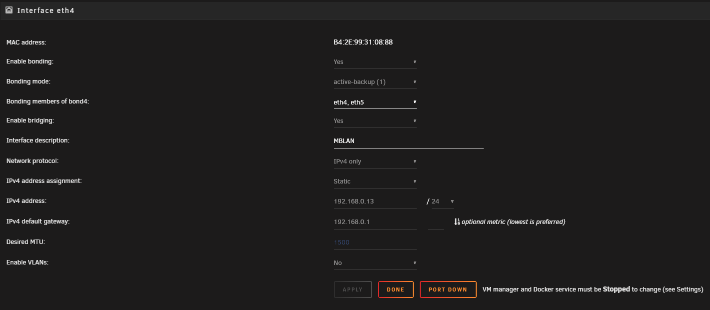

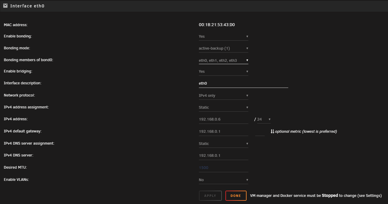

On 10/10/2019 at 8:38 AM, casperse said:
Help setting up dual network in Plex docker?
I have managed to setup the ethernet like this:
And this:
But how to add this to Plex in Docker (Sofar I have been unsuccessful)
I use "host" which just uses the first lan group, changing it to "Custom: br0" doesn't seem to work
Do I have to add it manually?
As always your input and help is much appreciated
Reason to do this: I want to setup different gateways to different internet connections
And I think I saw Plex being able to have multiple network connection in the ui
Any input on how to add all networks to Plex (Multiple access?)
I think I had this when it was running on my Syn NAS....
