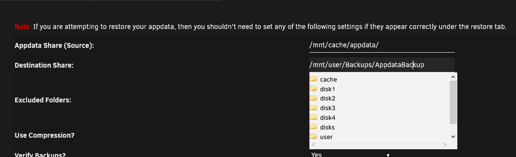

34 minutes ago, JT24 said:
Could you please post how to do this?
Isn't he just talking about the CA Appdata Backup/Restore plugin?
It lets you specify the folder to which to backup your appdata folder and the schedule on which it is done.  Mine is weekly.

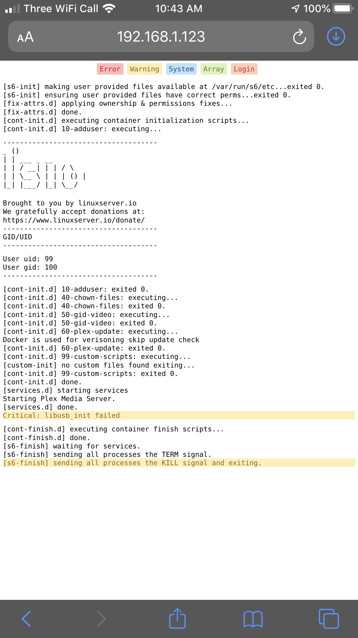

2 minutes ago, Spoonsy1480 said:
Just switched to 6.8 rc5 and my plex docker will not start, was running before with no problems
Post diagnostics and docker run command.
Share this post
Link to post
I will when I get home, I haven’t changed anything but updated to 6.8 rc5 plex was working before

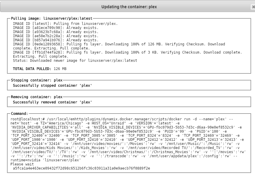

Went to update my Plex docker to the latest, and it's been sitting here for about 2 hours. What SHOULD I do?
Share this post
Link to post
9 minutes ago, buellmule said:
What SHOULD I do?
Open a new tab and grab diagnostics for posting here
Share this post
I can not seem to add diagnostics as I’m on my phone but I hope this helps, when I go back to 6.7
It works
Share this post
Link to post
It works
Doesn't help at all. Still need Diagnostics and run command. That is not the run command.
See the very first link in the Docker FAQ for instructions on getting the run command.
