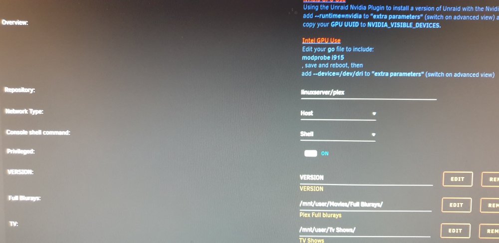

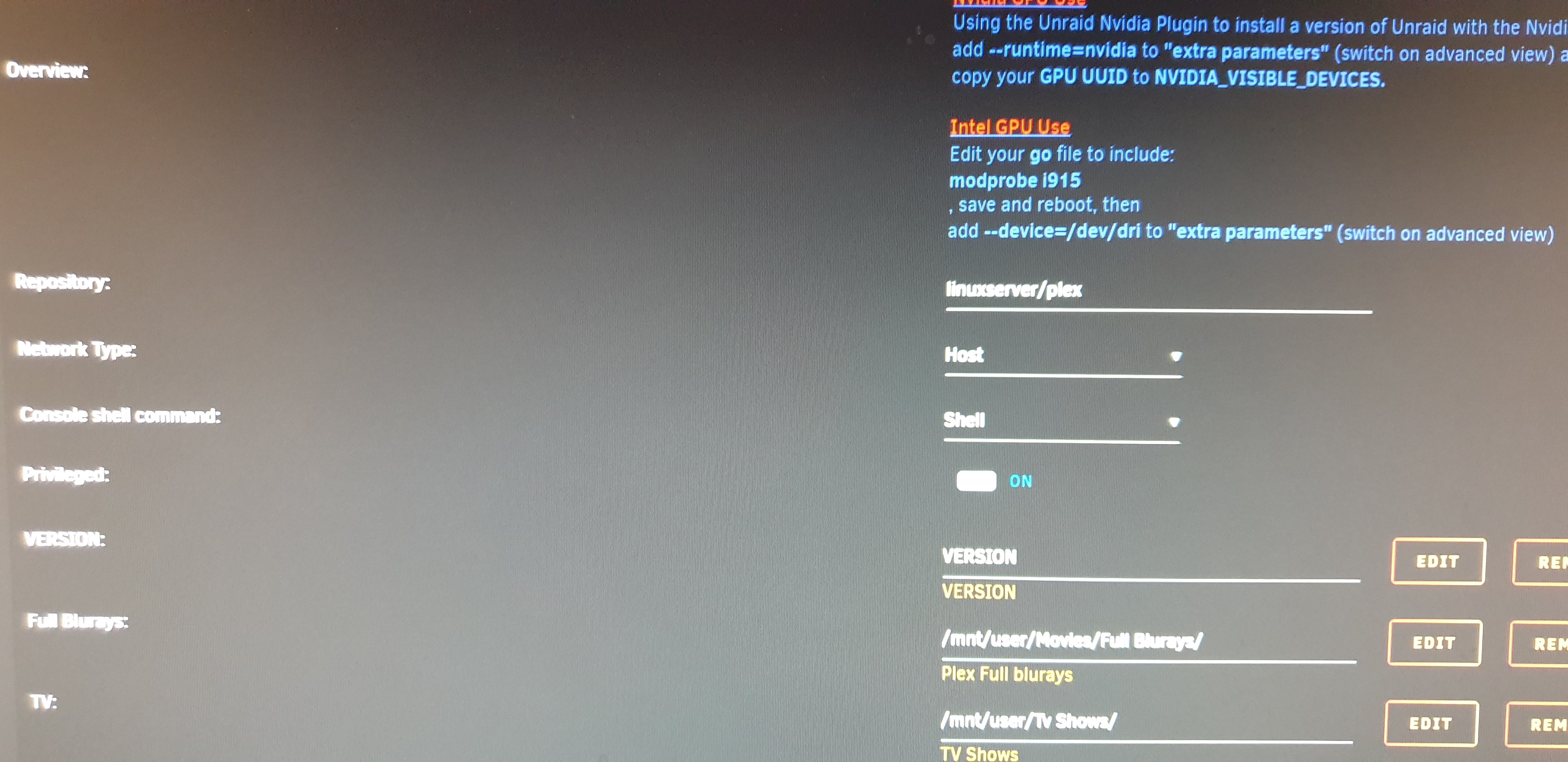

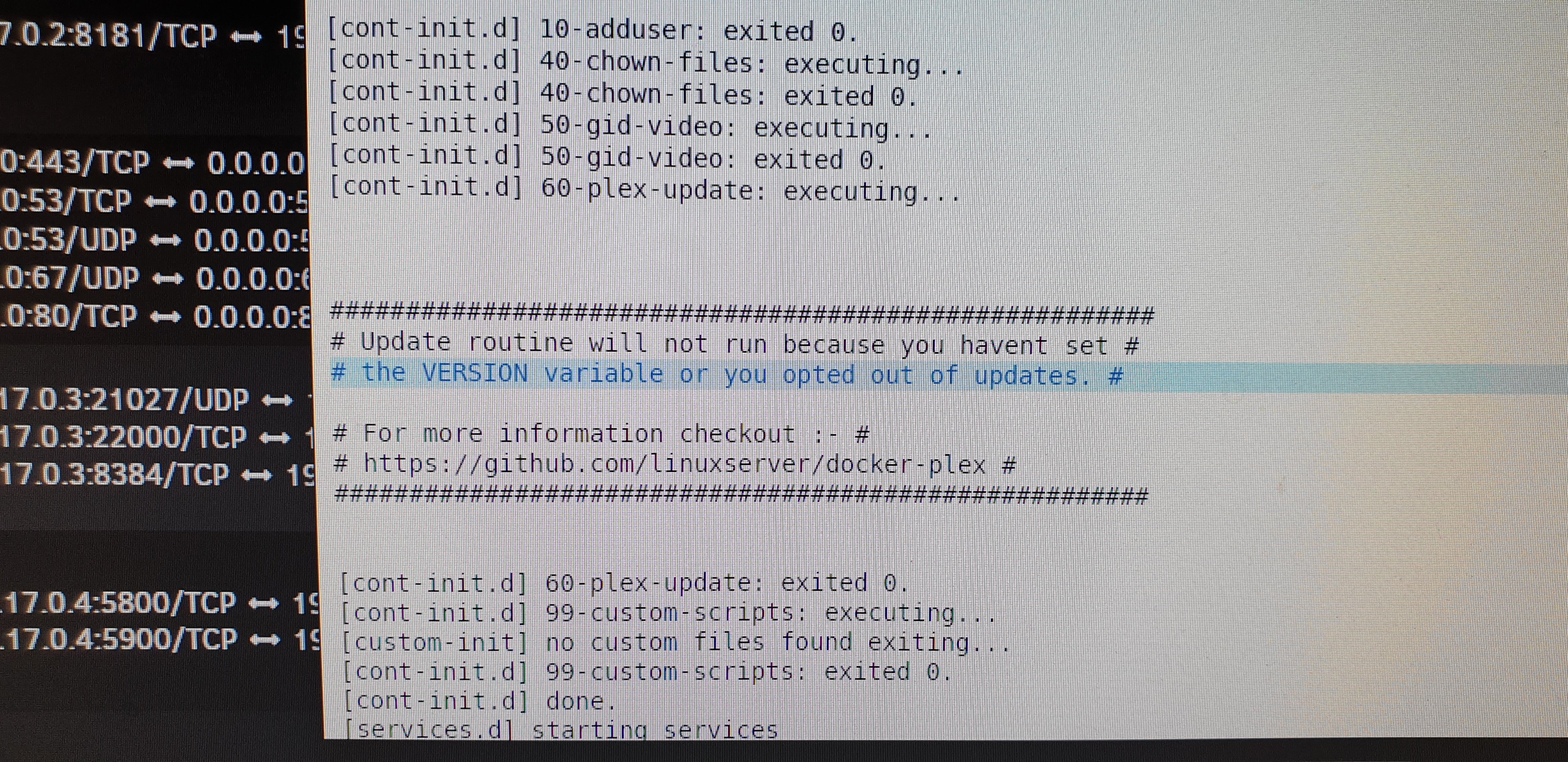

coblck Posted November 24, 2019 Share Posted November 24, 2019 Thanks you like in say all good just noticed this in the log though. Quote Link to comment
saarg Posted November 24, 2019 Share Posted November 24, 2019 2 hours ago, coblck said: Thanks you like in say all good just noticed this in the log though. You know you can take screenshots on your computer? The reason why you are seeing that message is because you haven't set the version variable correctly. You should set it it to one of the following: latest docker public Read what squid posted for an explanation of the difference. Quote Link to comment

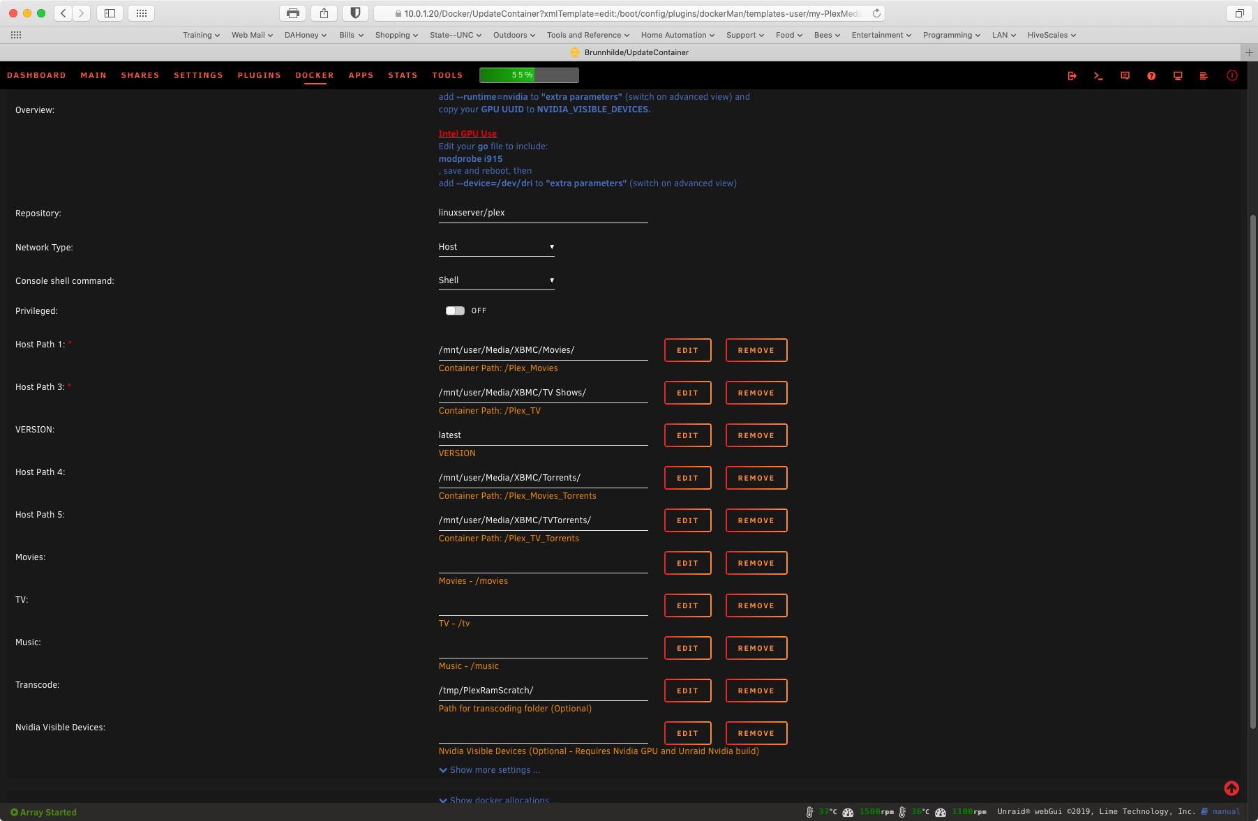

coblck Posted November 24, 2019 Share Posted November 24, 2019 I have changed it to all 3 but still get error. Can someone post photo if there setup in there docker? Quote Link to comment
wgstarks Posted November 25, 2019 Share Posted November 25, 2019 16 minutes ago, coblck said: I have changed it to all 3 but still get error. Can someone post photo if there setup in there docker? Quote Link to comment

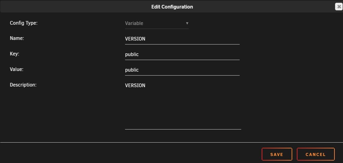

coblck Posted November 25, 2019 Share Posted November 25, 2019 Thanks excatly what I have now but still have error. Could you click on the edit button for version and see if we have the same please? Quote Link to comment
saarg Posted November 25, 2019 Share Posted November 25, 2019 3 minutes ago, coblck said: Thanks excatly what I have now but still have error. Could you click on the edit button for version and see if we have the same please? No need for him to show it as you can see that his is set to latest. Post yours and people can tell if you got it worn or not. Quote Link to comment
coblck Posted November 25, 2019 Share Posted November 25, 2019 Morning here is what i have Quote Link to comment
aptalca Posted November 25, 2019 Share Posted November 25, 2019 4 hours ago, coblck said: Morning here is what i have Key should be VERSION, value is latest. You didn't set anything to latest there?!? Quote Link to comment
coblck Posted November 25, 2019 Share Posted November 25, 2019 6 minutes ago, aptalca said: Key should be VERSION, value is latest. You didn't set anything to latest there?!? That fixed it thank you very much Quote Link to comment
