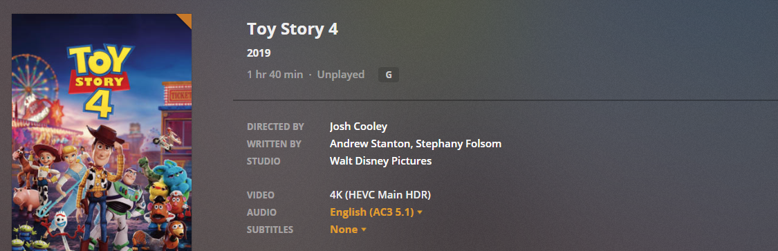

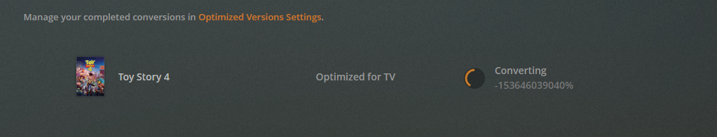

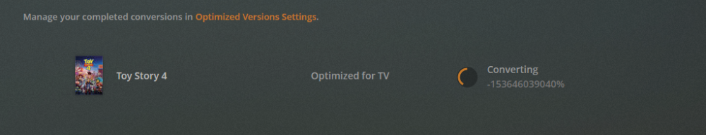

Hi all, I seem to have stumbled across a peculiar problem. When I recently try to transcode/optimize a 4K video file (mp4, HEVC), the progress status indicates a negative percentage value. I remember it to have worked fine in the past. Other encodes appear to be working fine @1080p.
Has anyone seen this before, and is it an issue with the GPU I am trying to use (GTX1050Ti)?
What information can I provide that could help shed some light on this mystery? Thanks in advance!
Setup:
Unraid 6.8.0 (Nvidia)
Plex 4.12.3 (linuxserver)
GPU: GTX1050Ti

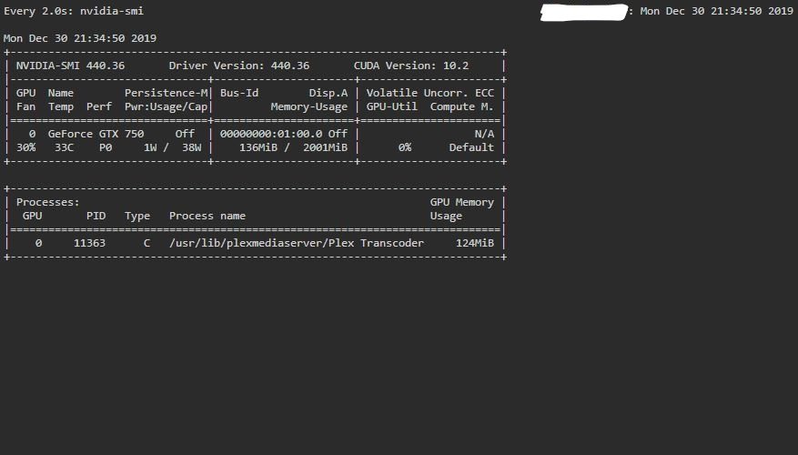

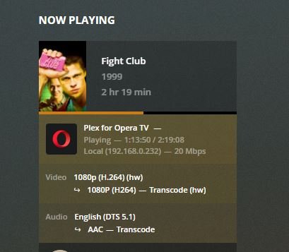

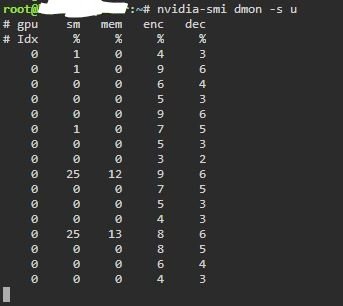

I assume Nvidia hardware decoding/encoding are both working for me based on below images?
Edited by jaybee
Share this post

4 hours ago, jaybee said:
Hi all,
Recently installed plex LSIO and nvidia unraid both on latest versions. I've been reading up the best I can on all the info and was wondering if someone can confirm that I'm correct on the below right now at time of writing:
1: The official plex apps/dockers did not support Nvidia Hardware decode specifically (hardware encode was enabled and had been working for some time) up until it was recently officially added around June 2019.
2: Before the above happened, there was a workaround which mainly involved a "hack" or wrapper script of some kind which altered ffmpeg included with plex to flag that it can do Nvidia hardware decoding.
(I'm yet to find this separate thread where this is supposedly discussed and often referred to in this very thread so have only been able to take snippets from various places).
3: Soon after (1) occurred above, the docker plex images were updated (including this one) to also include the ability to Nvidia hardware decode as well as encode.
4: Therefore simply installing the latest version of LSIO plex does indeed work out of the box with Nvidia Hardware decoding and encoding, so long as it is bundled with nvidia unraid to allow pass through of nvidia gpu to the plex container. (I'm assuming the bolded part is required and it would not work with official unraid).
5: Nvidia hardware decode and encode has worked for ages on windows and hence people have previously worked around the linux issues with using windows VMs.
6: Updating to the latest official unraid new releases could break nvidia hardware decoding since nvidia unraid could break underneath, so best to wait for this to also be updated first.
Sorry if I got any of the above wrong.
Correct. Stock unraid does not have the necessary nvidia drivers or the nvidia runtime required.
The nvidia plugin allows you to install custom builds of unraid that include the necessary drivers and docker runtime.
Only install the unraid builds via the nvidia plugin to make sure that your Plex container continues to use nvidia hw transcode.
And yes, until recently, Plex only supported hw encode. Now it supports both. No need for other scripts or wrappers. Just the custom unraid build and the linuxserver container make it work.

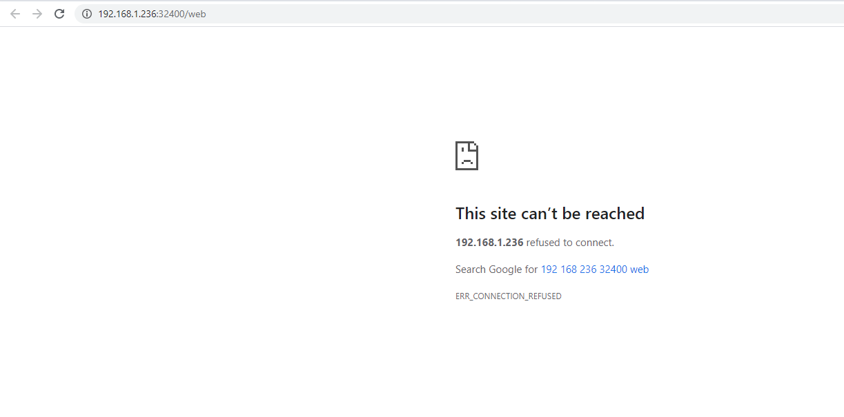

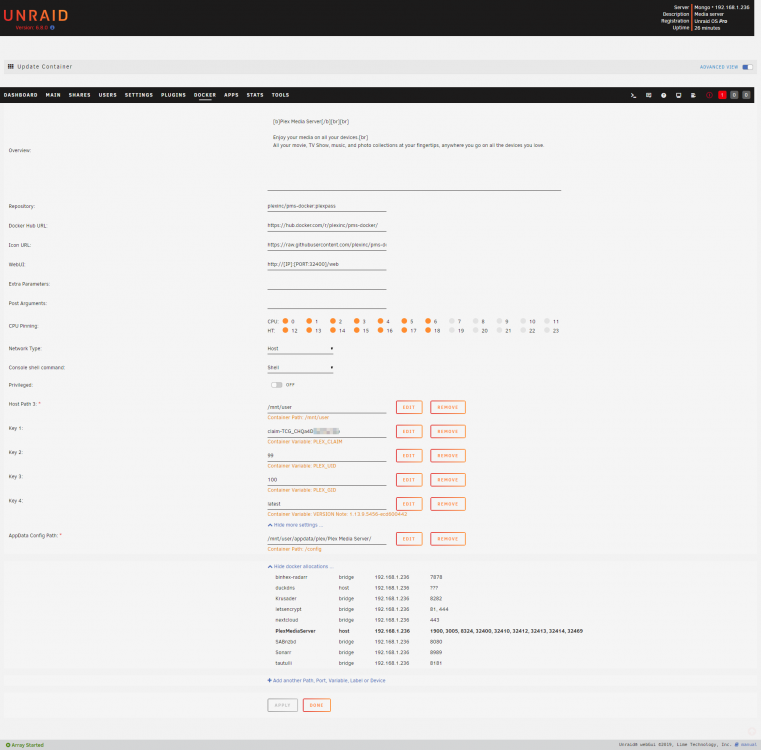

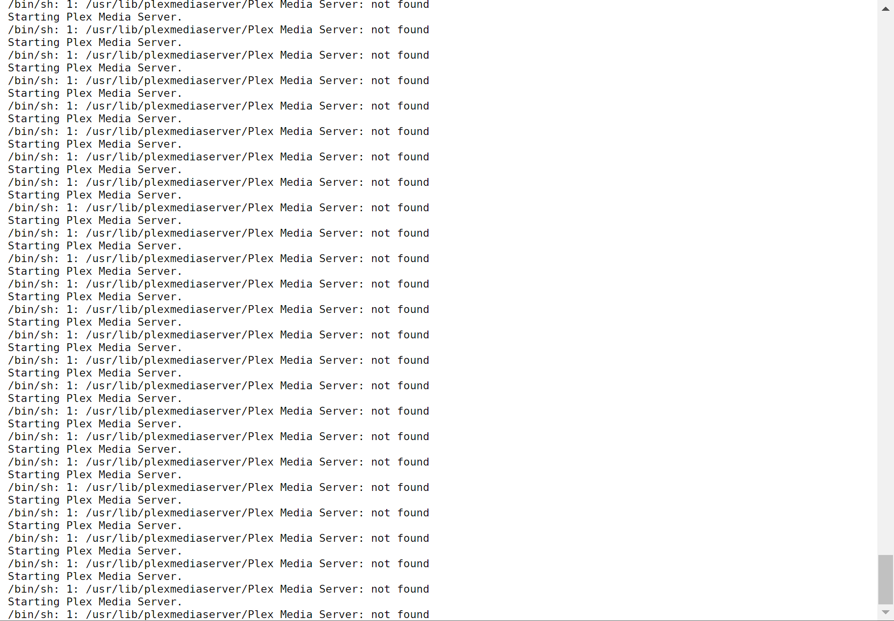

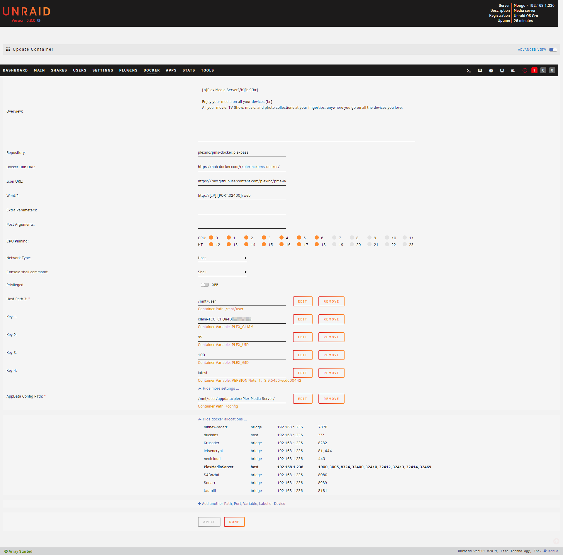

PLEX SERVER UNREACHABLE AFTER RYZEN 9 UPGRADE
Today I upgraded from an old AMD processor to a Ryzen 9 3900x and a ASrock x370 Professional Gaming Motherboard. I got everything up and running, but Plex is acting strangely, Selecting the webui shows the server as unreachable. Sometimes I can access the plex server from my phone or Nvidia shield on the local network momentarily and then it drops again.
Any idea what could be going on?
UPDATE: Now clicking on Webui from the docker no longer takes me to plex admin. It's just showing "site can't be reached"
Edited by cypres0099
Quick update...
It turns out that I was apparently not running the linuxserver docker of plex, but rather the Plexinc version.  That's a tidbit I found out after removing the docker to try reinstalling. So anyway, I attempted to reinstall with the linuxserver version, but I was getting an error saying my certification has expired and it wouldn't pull the docker.
Poked around on google and unraid forms and found out that error can come from an incorrect date/time setting. Upon checking, my date and time setting had been set to the date on which the updated bios had been released (Aug 3, 2019). So I manually corrected the date/time and the docker pulled and installed correctly.
My guess is that my problems with the original plex install were likely related to this too, but it's too late since I deleted it.
All the appdata is showing up correctly, but I had to re-add the libraries before it would play any of the content correctly becuase the linuxserver distro uses path mapping.
So that was fun!
