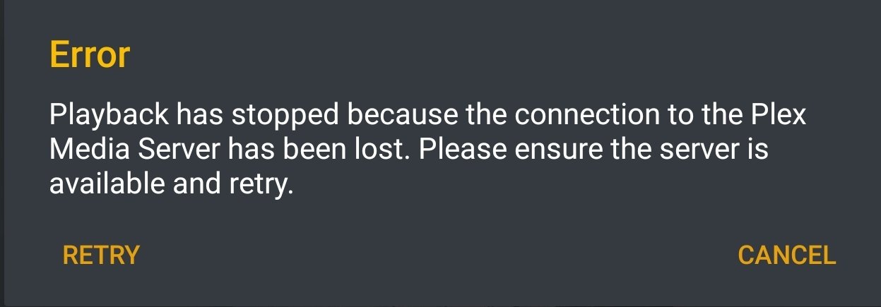

Hi guys, I keep getting this message on my Android devices:
- Old Fire TV
- FireTV Stick 4k
- Brand New FireTV Stick 4k
- Samsung Galaxy S10+
- Samsung Tab S4
1480058622_WhatsAppImage2020-02-02at14_14_20.thumb.jpeg.800ff41662b84d02b6d80b357349e541.jpeg
On the Tab S4 if i play the same item via the web browser it plays just fine, but using the app I get the above error!
Any idead how to resolve this issue? Seems to have started recently.
Many thanks
