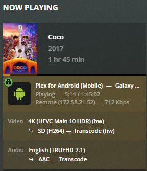

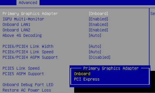

mikesp18 Posted February 26, 2020 Share Posted February 26, 2020 4 hours ago, trurl said: What GPU? Explained in the first post in this thread. You should always read at least the first post in the support thread. Quick Sync Video on the Xeon E-2288G. Sorry, I'll go read the intro page. Thank you Quote Link to comment

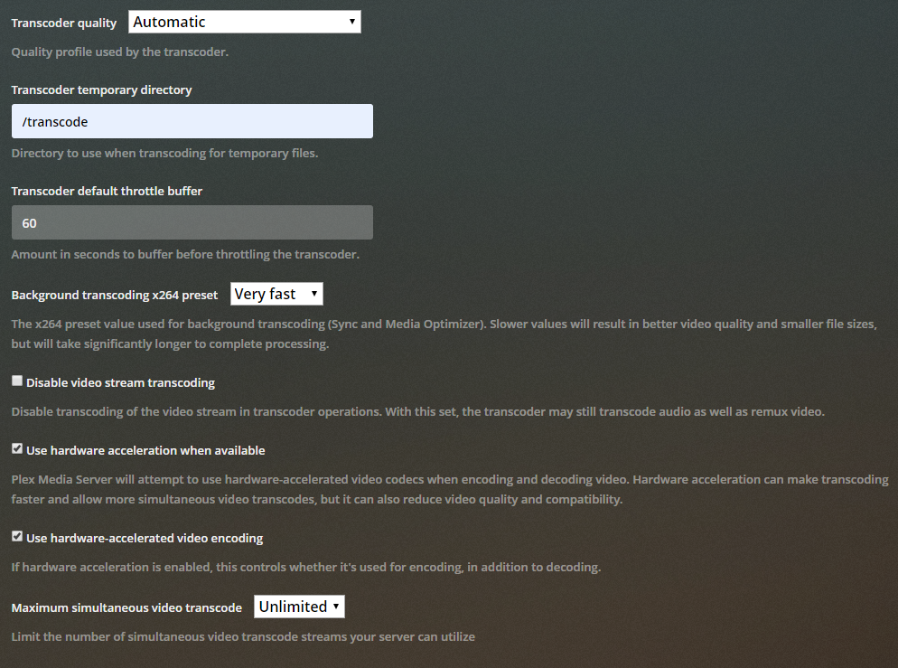

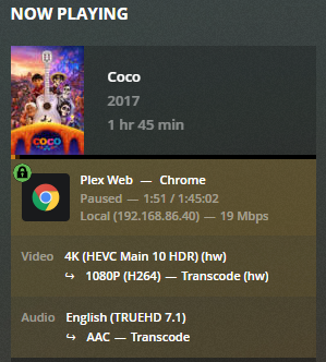

Hoopster Posted February 26, 2020 Share Posted February 26, 2020 (edited) 12 minutes ago, mikesp18 said: Quick Sync Video on the Xeon E-2288G. Sorry, I'll go read the intro page. Thank you You might find this post interesting. You can see the prior posts in the thread for system details. I have hardware transcoding working on Plex with the E-2288G, but you need the go file entries as well as the appropriate Plex parameters/variables configured in the docker container. Here is a tutorial on how to set it up properly. Edited February 26, 2020 by Hoopster Quote Link to comment
mikesp18 Posted February 26, 2020 Share Posted February 26, 2020 48 minutes ago, Hoopster said: You might find this post interesting. You can see the prior posts in the thread for system details. I have hardware transcoding working on Plex with the E-2288G, but you need the go file entries as well as the appropriate Plex parameters/variables configured in the docker container. Here is a tutorial on how to set it up properly. Hi Hoopster, I have the same hardware as you I suspect since I bought it from the same Ebay dealer. He said he flashed the bios to the 2.10A, but I noticed it states 2.10 on boot. I'll have to check though I've not even attempted to log in yet via IPMI here is my /flash/config/go file #!/bin/bash # Start the Management Utility /usr/local/sbin/emhttp & modprobe i915 Attached are my parameters in linusserver.io plex container: When I start up the Docker, I get the following error: Any idea where I am going wrong? I noticed on Page one of this thread, it states: 2. Add the Plex container and add --device=/dev/dri to extra parameters (switch on advanced template view) There is no need to chmod/chown the /dev/dri, this is handled by the container. Hoopster, that ***GUIDE*** Plex Hardware Acceleration using Intel Quick Sync mentions: We need to change the relevant permissions on our Quick Sync Device which we do by typing into the terminal window: chmod -R 777 /dev/dri So I'm guessing this was slightly outdated and no longer needs to be done. Quote Link to comment

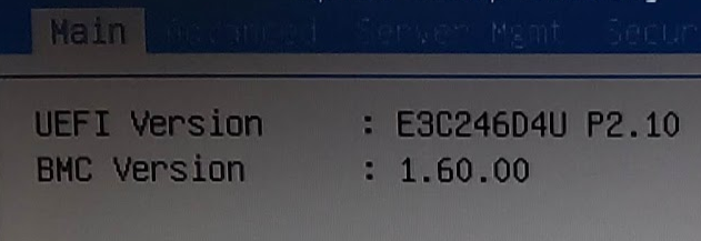

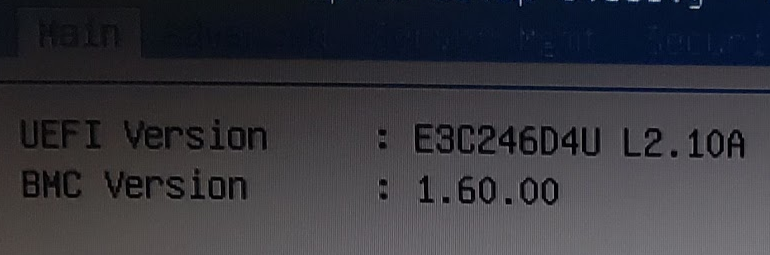

Hoopster Posted February 26, 2020 Share Posted February 26, 2020 44 minutes ago, mikesp18 said: Hi Hoopster, I have the same hardware as you I suspect since I bought it from the same Ebay dealer. He said he flashed the bios to the 2.10A, but I noticed it states 2.10 on boot. I'll have to check though I've not even attempted to log in yet via IPMI ASRock sent me the 2.10A BIOS. The board I got from the eBay seller has BIOS 2.10 54 minutes ago, mikesp18 said: We need to change the relevant permissions on our Quick Sync Device which we do by typing into the terminal window: chmod -R 777 /dev/dri So I'm guessing this was slightly outdated and no longer needs to be done. It's still in my 'go' and does not cause problems Here is my go file Plex section: #Setup drivers for hardware transcoding in Plex modprobe i915 chown -R nobody:users /dev/dri chmod -R 777 /dev/dri And here is the relevant section of my Plex docker setup: Quote Link to comment

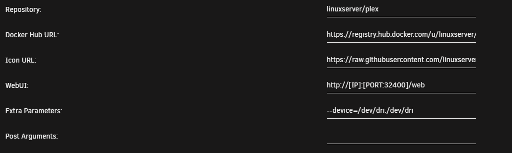

aptalca Posted February 26, 2020 Share Posted February 26, 2020 1 hour ago, mikesp18 said: Hi Hoopster, I have the same hardware as you I suspect since I bought it from the same Ebay dealer. He said he flashed the bios to the 2.10A, but I noticed it states 2.10 on boot. I'll have to check though I've not even attempted to log in yet via IPMI here is my /flash/config/go file #!/bin/bash # Start the Management Utility /usr/local/sbin/emhttp & modprobe i915 Attached are my parameters in linusserver.io plex container: When I start up the Docker, I get the following error: Any idea where I am going wrong? I noticed on Page one of this thread, it states: 2. Add the Plex container and add --device=/dev/dri to extra parameters (switch on advanced template view) There is no need to chmod/chown the /dev/dri, this is handled by the container. Hoopster, that ***GUIDE*** Plex Hardware Acceleration using Intel Quick Sync mentions: We need to change the relevant permissions on our Quick Sync Device which we do by typing into the terminal window: chmod -R 777 /dev/dri So I'm guessing this was slightly outdated and no longer needs to be done. No longer needed but won't hurt Quote Link to comment

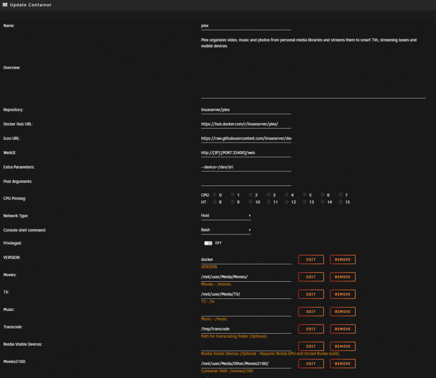

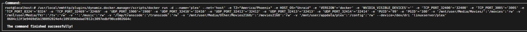

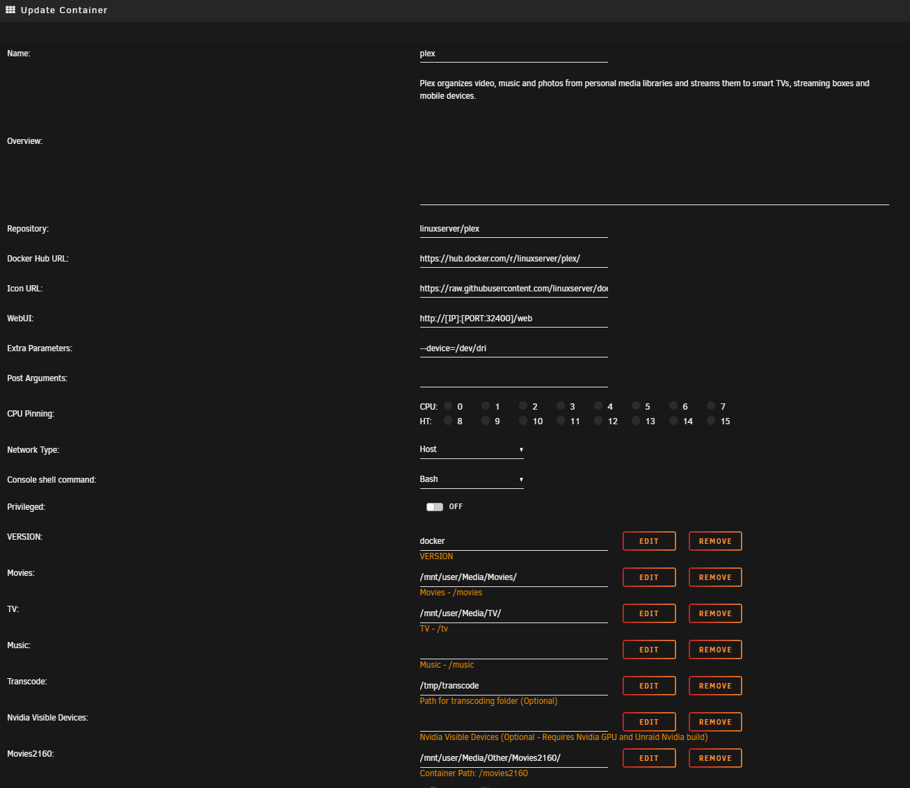

mikesp18 Posted February 27, 2020 Share Posted February 27, 2020 I'm still getting the failure message. I tried reinstalling Plex, but no dice. The problem starts with when the extra parameters: --device=/dev/dri I get the following in the container dialogue: Command: [email protected]:# /usr/local/emhttp/plugins/dynamix.docker.manager/scripts/docker run -d --name='plex' --net='host' -e TZ="America/Phoenix" -e HOST_OS="Unraid" -e 'VERSION'='docker' -e 'NVIDIA_VISIBLE_DEVICES'='' -e 'TCP_PORT_32400'='32400' -e 'TCP_PORT_3005'='3005' -e 'TCP_PORT_8324'='8324' -e 'TCP_PORT_32469'='32469' -e 'UDP_PORT_1900'='1900' -e 'UDP_PORT_32410'='32410' -e 'UDP_PORT_32412'='32412' -e 'UDP_PORT_32413'='32413' -e 'UDP_PORT_32414'='32414' -e 'PUID'='99' -e 'PGID'='100' -v '/mnt/user/Media/Movies/':'/movies':'rw' -v '/mnt/user/Media/TV/':'/tv':'rw' -v '':'/music':'rw' -v '/tmp/transcode':'/transcode':'rw' -v '/mnt/user/Media/Other/Movies2160/':'/movies2160':'rw' -v '/mnt/user/appdata/plex':'/config':'rw' --device=/dev/dri 'linuxserver/plex' b23fda0dffa9d51752267986652031bb7358cdfde8a200adf4790d39918ae858 /usr/bin/docker: Error response from daemon: error gathering device information while adding custom device "/dev/dri": no such file or directory. The command failed. Any ideas? Quote Link to comment
Hoopster Posted February 27, 2020 Share Posted February 27, 2020 4 minutes ago, mikesp18 said: The problem starts with when the extra parameters: --device=/dev/dri Start a terminal session from the GUI and try "cd /dev/dri" to make sure that folder does exist. If it exists, check the contents. It should have these files in it: If the folder does not exist or the contents are not as shown above, that is your problem. Quote Link to comment

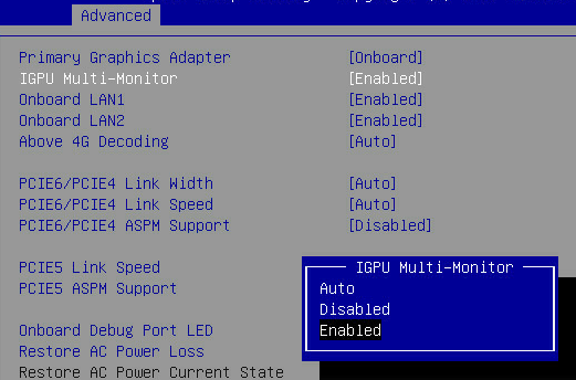

mikesp18 Posted February 27, 2020 Share Posted February 27, 2020 (edited) Yep, seems like the problem. Not to be outdone... google. And what do I find.... Hoopster's post from over a year ago. I see your post here regarding the iGPU not being enabled correctly in the bios. Bingo. Problem was the iGPU set to AUTO, instead of ENABLED. Here are some pics from the IPMI/BMC (BTW, I did upgrade the Bios to the L2.10A instead of P2.10. (I'm going to post pics in case someone else is looking Motherboard in question here is ASRock Rack E3C246D4U and as Hoopster noted in a number of over threads, this is a beta bios (2.10a instead of most recent 2.10 from website) from tech support to be able to use ASPEED AST2500 for BMC/IPMI without disabling the Intel iGPU, though I haven't thoroughly tested it yet. Now, for completeness: GO file: adding modprobe i915 plex linuxserver.io container application values: Extra Parameters --device=/dev/dri plex container started, dialogue: Now with the same terminal as before: Now settings in Plex->Transcoder and here's transcode over local network to 1080p Chrome browser and here's transcore over cellular to my cell phone Edited February 27, 2020 by mikesp18 3 1 Quote Link to comment
Hoopster Posted February 27, 2020 Share Posted February 27, 2020 10 hours ago, mikesp18 said: Not to be outdone... google. And what do I find.... Hoopster's post from over a year ago. I see your post here regarding the iGPU not being enabled correctly in the bios. Yeah, sorry I did not point that out in the first post, but I posted that just as I was headed out the door for a few hours and I was not sure that was the issue. By the time I returned, you had verified the problem and already found the answer. 👍 Quote Link to comment

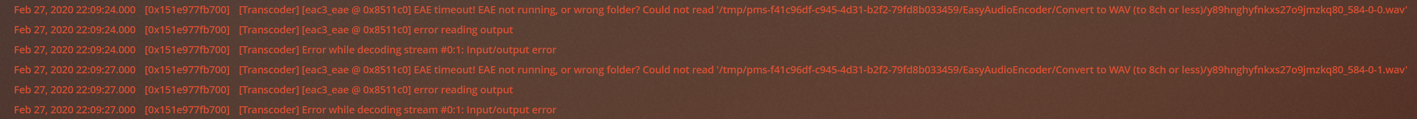

casperse Posted March 8, 2020 Share Posted March 8, 2020 (edited) Hi All I have a solid system for a very long time but after encoding to RAM I am getting some problems once in a while some TV shows doesn't play and then later they play fine? Error log: [Transcoder] [eac3_eae @ 0x15422c0] EAE timeout! EAE not running, or wrong folder? Could not read '/tmp/pms-018fb146-d1c7-4f41-84cb-cae419d0ca06/EasyAudioEncoder/Convert to WAV (to 8ch or less)/e12d43b76d37f1d2-com-plexapp-android_7893-0-0.wav' I found this post? Anyone have a solution to this? (Just upgraded to 64GB RAM to use RAM for encoding) And only for TV never movies? so the tmp folder si working.... Edited March 8, 2020 by casperse Quote Link to comment
