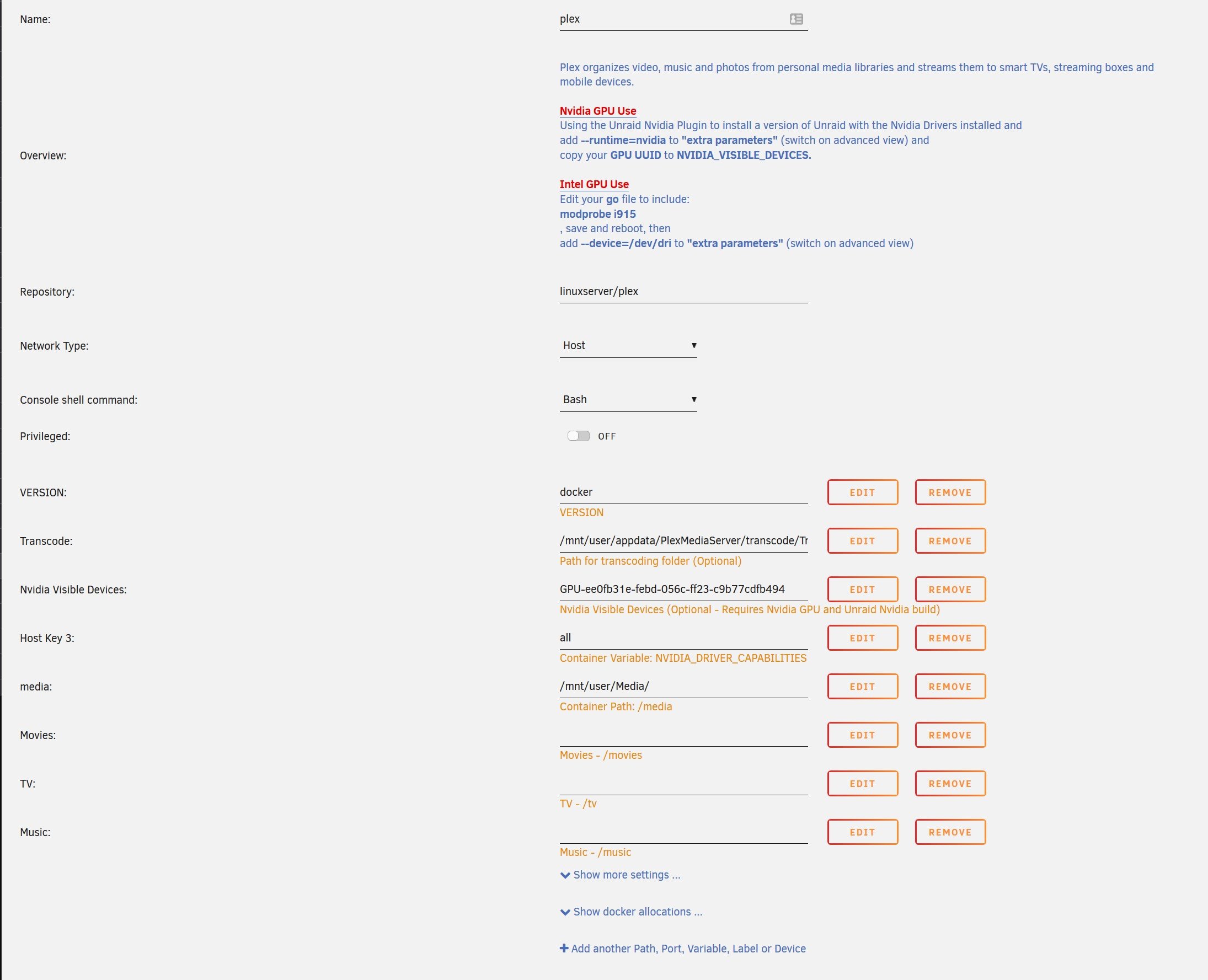

vmax5000 Posted April 1, 2020 Share Posted April 1, 2020 Not sure if this is the right place to ask, but I updated my unraid to 6.8.3 and now my plex server won't start. I did update the plex server software prior to the unraid update. Any help would be appreciated. Thanks.. Quote Link to comment
axipher Posted April 1, 2020 Share Posted April 1, 2020 11 minutes ago, vmax5000 said: Not sure if this is the right place to ask, but I updated my unraid to 6.8.3 and now my plex server won't start. I did update the plex server software prior to the unraid update. Any help would be appreciated. Thanks.. Looks like you may have been running the Unraid Nvidia Build as you have a GPU ID filled in. Did you update Unraid to the non Nvidia 6.8.3? Quote Link to comment
vmax5000 Posted April 1, 2020 Share Posted April 1, 2020 Not sure, I might have, can I go back to 6.8.2 and try again? Thanks.. Quote Link to comment

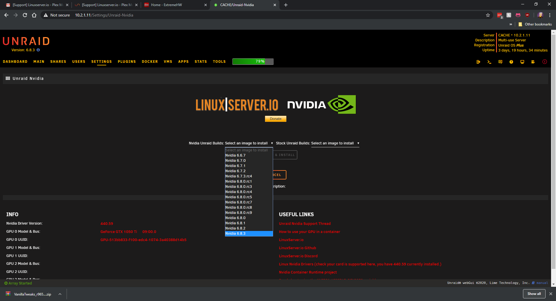

axipher Posted April 1, 2020 Share Posted April 1, 2020 Well if you have the Unraid-Nvidia Plugin you just want to select an Nvidia Unraid build and let it do the install process on the little pop-up Quote Link to comment
vmax5000 Posted April 1, 2020 Share Posted April 1, 2020 Oh, thanks! I never even thought of that. Thanks! Quote Link to comment
vmax5000 Posted April 1, 2020 Share Posted April 1, 2020 Yup, that fixed it, I completely forgot about having to do that. I'll try and remember next time. Thanks again, V Quote Link to comment
axipher Posted April 1, 2020 Share Posted April 1, 2020 2 minutes ago, vmax5000 said: Yup, that fixed it, I completely forgot about having to do that. I'll try and remember next time. Thanks again, V No problem, sometimes a second set of eyes is all you need on a problem. Quote Link to comment

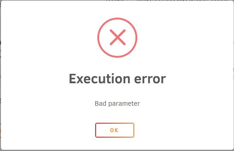

uaeproz Posted April 8, 2020 Share Posted April 8, 2020 (edited) Guys I'm trying to make the GPU do the hard work for encoding/decoding but I'm getting this issue in the screen shot that I attached. I tried to restore the permissions from the "New Permissions" under settings but still getting the same error. I tried "Docker Safe New Perms" under settings but again same issue still. What should I do? Edited April 8, 2020 by uaeproz Quote Link to comment
saarg Posted April 8, 2020 Share Posted April 8, 2020 4 hours ago, uaeproz said: Guys I'm trying to make the GPU do the hard work for encoding/decoding but I'm getting this issue in the screen shot that I attached. I tried to restore the permissions from the "New Permissions" under settings but still getting the same error. I tried "Docker Safe New Perms" under settings but again same issue still. What should I do? Why are you trying to do the chmod? Plex handles encode/decode now, so no need to modify anything. Your error is caused by not escaping spaces and also using the wrong name. Quote Link to comment
uaeproz Posted April 8, 2020 Share Posted April 8, 2020 2 hours ago, saarg said: Why are you trying to do the chmod? Plex handles encode/decode now, so no need to modify anything. Your error is caused by not escaping spaces and also using the wrong name. I was following this guy's instructions to enable NVDEC on youtube: https://www.youtube.com/watch?v=bz16M67z0uM Do you have any pointers to undo the "damages" I made? lol. Transcoding "some" 4k videos is just buffering and not playing now. By the way, in chmod I realized that I used wrong folder name (the "Plex Transcoder" was missing the r). If NVDEC is enabled, how to undo the damage now? I tried clicking on force update but nothing happens Quote Link to comment
saarg Posted April 8, 2020 Share Posted April 8, 2020 4 hours ago, uaeproz said: I was following this guy's instructions to enable NVDEC on youtube: https://www.youtube.com/watch?v=bz16M67z0uM Do you have any pointers to undo the "damages" I made? lol. Transcoding "some" 4k videos is just buffering and not playing now. By the way, in chmod I realized that I used wrong folder name (the "Plex Transcoder" was missing the r). If NVDEC is enabled, how to undo the damage now? I tried clicking on force update but nothing happens Then you have to undo what you did following the video. Quote Link to comment

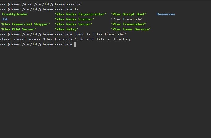

uaeproz Posted April 13, 2020 Share Posted April 13, 2020 On 4/10/2020 at 7:45 PM, Jason Harris said: That video is accurate up until it tells you to go into a terminal and start mucking around on the command line. NVDEC must also be enabled in Plex itself. Good luck! Can you tell me where to stop: cd /usr/lib/plexmediaserver mv "Plex Transcoder" "Plex Transcoder2" apt-get update apt-get install nano nano Plex Transcoder #!/bin/sh /usr/lib/plexmediaserver/Plex\ Transcoder2 -hwaccel nvdec "[email protected]" Add Transcoder after Plex chmod +x "Plex Transcoder" Quote Link to comment
saarg Posted April 13, 2020 Share Posted April 13, 2020 47 minutes ago, uaeproz said: Can you tell me where to stop: cd /usr/lib/plexmediaserver mv "Plex Transcoder" "Plex Transcoder2" apt-get update apt-get install nano nano Plex Transcoder #!/bin/sh /usr/lib/plexmediaserver/Plex\ Transcoder2 -hwaccel nvdec "[email protected]" Add Transcoder after Plex chmod +x "Plex Transcoder" You don't have to do anything to use both hardware encode and decode in Plex. Apart from setting the container up to use your Nvidia card. Quote Link to comment
