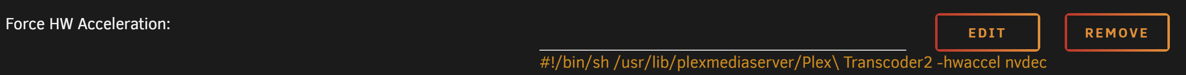

Does anyone know what the "Force HW Acceleration" setting is when you edit the container? My assumption is maybe it's intended to keep your hardware transcoding enabled through updates so you don't have to manually modify files, but I can't find any documentation about it.  That's probably hopeful thinking, but figured I'd see if anyone knew. Thanks for any input!
Edited by eir3ann
Added clarification
That is something you have added.

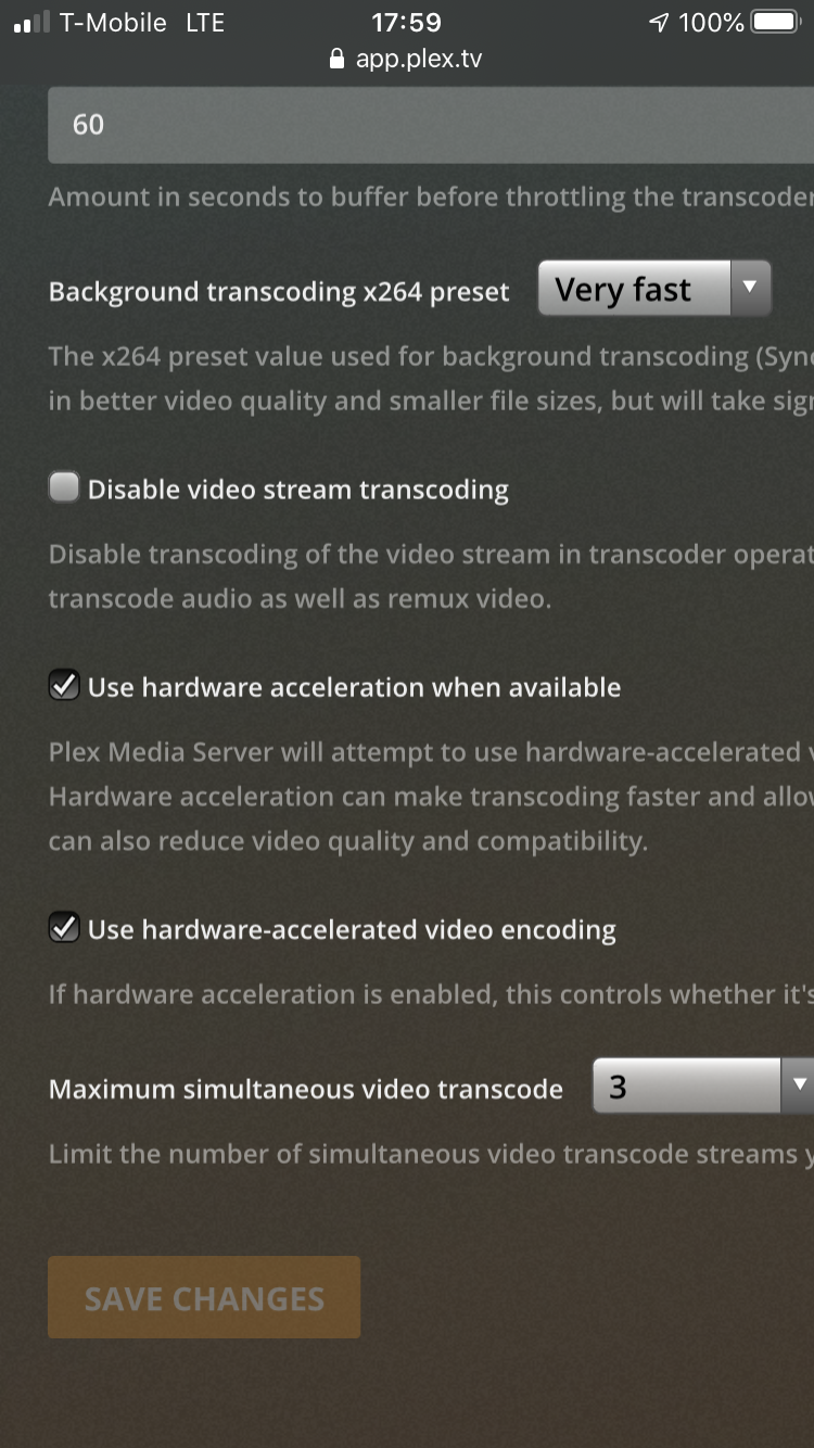

32 minutes ago, FQs19 said:
I was directed to this forum for a question I have about hardware acceleration Encoding not working.

I started a movie and transcoded down in resolution, but gpustats and Plex shows only that Decoding is taking place. My cpu is still doing the Encode.

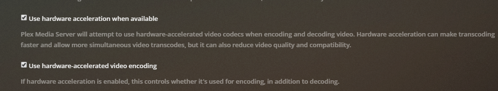

Did you enable both decode and encode in the plex settings?
Plex Transcoder settings?
EDIT: Oops, just saw @saarg already answered this.
Edited by Hoopster
I have both hardware acceleration and hardware-accelerated encoding checked.
Well that would explain it! I must have done that when I was messing with getting it working the first time.  Been so long I completely don't remember doing it, but thank you for your response.  Feeling pretty dumb right now!
