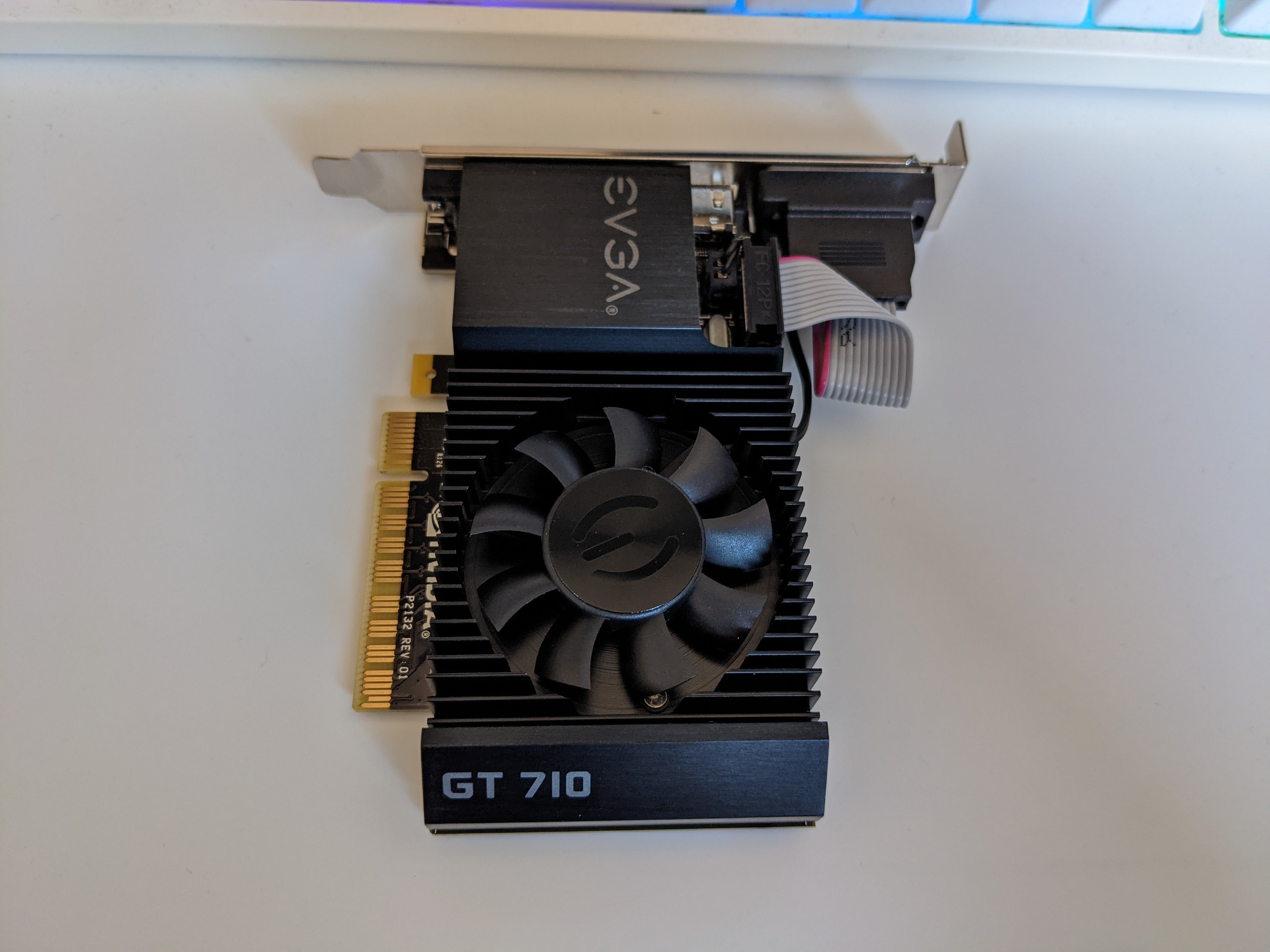

Hi, I purchased one of these a while back thinking I needed it for VMs. Would this help in any way if I passed through to my Plex server? I already have a beefy CPU (16,000 passmark)
