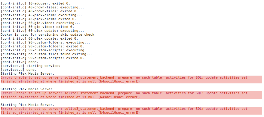

July 16, 20215 yr 21 hours ago, pevo01 said: I tried the binhex container and copied my config across and I get the same error so it seems like it is not an issue with the latest linuxserver.io update. Either my system is having issues or my database is corrupt. I downgraded my linuxserver docker to amd64-version-1.23.3.4707-ebb5fe9f3 (previous version) and it is now working perfectly...

July 22, 20215 yr Hey all! I am jumping on the bandwagon to report my Plex server seems to start up, but then crashes over and over again very often. In the docker logs I see this over and over again: libc++abi: terminating with uncaught exception of type soci::soci_error: Cannot begin transaction. database is locked ****** PLEX MEDIA SERVER CRASHED, CRASH REPORT WRITTEN: /config/Library/Application Support/Plex Media Server/Crash Reports/1.23.6.4810-15ce0e21a/PLEX MEDIA SERVER/8575f75a-9267-434f-35d880a7-f0e79b44.dmp Sqlite3: Sleeping for 200ms to retry Starting Plex Media Server. Sqlite3: Sleeping for 200ms to retry busy DB. Sqlite3: Sleeping for 200ms to retry busy DB. Sqlite3: Sleeping for 200ms to retry busy DB. Sqlite3: Sleeping for 200ms to retry busy DB. Sqlite3: Sleeping for 200ms to retry busy DB. Sqlite3: Sleeping for 200ms to retry busy DB. Sqlite3: Sleeping for 200ms to retry busy DB. Sqlite3: Sleeping for 200ms to retry busy DB. Sqlite3: Sleeping for 200ms to retry busy DB. Sqlite3: Sleeping for 200ms to retry busy DB. Sqlite3: Sleeping for 200ms to retry busy DB. Sqlite3: Sleeping for 200ms to retry busy DB. Sqlite3: Sleeping for 200ms to retry busy DB. Sqlite3: Sleeping for 200ms to retry busy DB. Sqlite3: Sleeping for 200ms to retry busy DB. Sqlite3: Sleeping for 200ms to retry busy DB. Sqlite3: Sleeping for 200ms to retry busy DB. Sqlite3: Sleeping for 200ms to retry busy DB. Sqlite3: Sleeping for 200ms to retry busy DB. Sqlite3: Sleeping for 200ms to retry busy DB. Sqlite3: Sleeping for 200ms to retry busy DB. Sqlite3: Sleeping for 200ms to retry busy DB. Sqlite3: Sleeping for 200ms to retry busy DB. libc++abi: terminating with uncaught exception of type soci::soci_error: Cannot begin transaction. database is locked ****** PLEX MEDIA SERVER CRASHED, CRASH REPORT WRITTEN: /config/Library/Application Support/Plex Media Server/Crash Reports/1.23.6.4810-15ce0e21a/PLEX MEDIA SERVER/1bacac55-0edc-4204-144f91a3-3aecb0db.dmp Sqlite3: Sleeping for 200ms to retry Starting Plex Media Server. Any ideas?
July 22, 20215 yr I updated the `VERSION` variable from "latest" to "1.23.3.4707-ebb5fe9f3" (I just looked through their tags which have Plex server versions, this is from ~2 weeks ago) and every thing seems better. Error spew in the docker/Unraid logs went away. Not sure what's up with latest PMS, but at least this works for now.

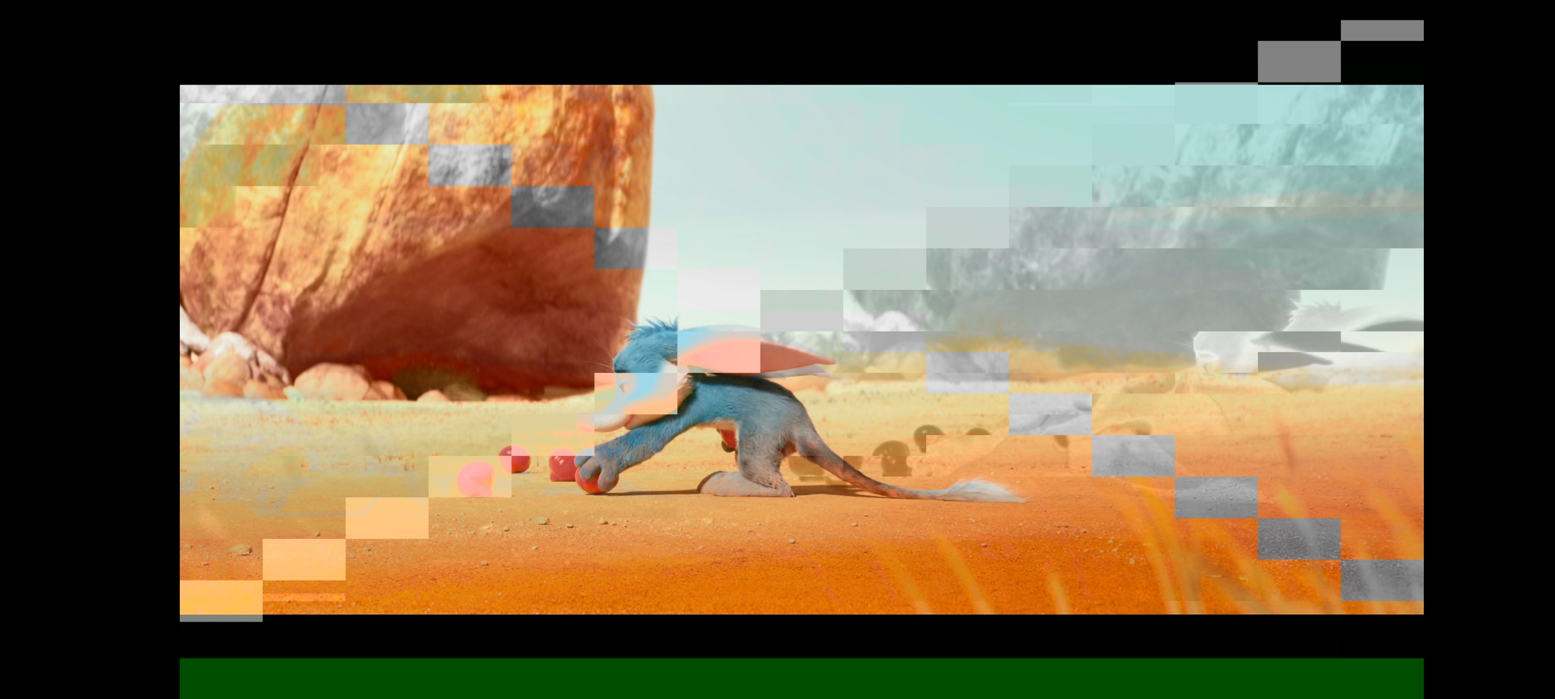

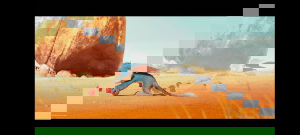

July 24, 20215 yr Hi, I'm setting up a new server with the 11600 CPU. I get this log from the plex docker when trying to hardware convert with HDR to SDR tone mapping. The image also has corruptions (see attached image). Intel_gpu_top shows very high gpu usage. 70-80% Video, 30% Render. beignet-opencl-icd: no supported GPU found, this is probably the wrong opencl-icd package for this hardware (If you have multiple ICDs installed and OpenCL works, you can ignore this message) I'm using Unraid 6.9.2. I am NOT running any i915 file in /boot/config/modprobe.d or modification to the go file. I only installed intel-gpu-top plugin and rebooted the server. The plex docker image I am using is ghcr.io/linuxserver/plex Using tag latest My render location is /tmp Hardware dev/dri passthrough to docker is on. Any assistance regards clearing the transcode image corruptions and the open-cl error would be most appreciated. Edit: I also tried setting an older static plex docker image as suggested in another post. plex:version-1.22.0.4163-d8c4875dd. Still the same result with HDR to SDR on I posted this in another subforum also.
July 24, 20215 yr 18 minutes ago, Presjar said: Hi, I'm setting up a new server with the 11600 CPU. I get this log from the plex docker when trying to hardware convert with HDR to SDR tone mapping. The image also has corruptions (see attached image). Intel_gpu_top shows very high gpu usage. 70-80% Video, 30% Render. beignet-opencl-icd: no supported GPU found, this is probably the wrong opencl-icd package for this hardware (If you have multiple ICDs installed and OpenCL works, you can ignore this message) I'm using Unraid 6.9.2. I am NOT running any i915 file in /boot/config/modprobe.d or modification to the go file. I only installed intel-gpu-top plugin and rebooted the server. The plex docker image I am using is ghcr.io/linuxserver/plex Using tag latest My render location is /tmp Hardware dev/dri passthrough to docker is on. Any assistance regards clearing the transcode image corruptions and the open-cl error would be most appreciated. Edit: I also tried setting an older static plex docker image as suggested in another post. plex:version-1.22.0.4163-d8c4875dd. Still the same result with HDR to SDR on I posted this in another subforum also. Very possibly a driver issue. UnRAIDs linux drivers are very behind and the xe graphics are very different.
July 24, 20215 yr 39 minutes ago, sittingmongoose said: Very possibly a driver issue. UnRAIDs linux drivers are very behind and the xe graphics are very different. Oh I see. Because it's a UHD750 the same driver as the lower end 11th gen 730 and 10th gen 630 (i915 Driver) is not working correctly?
July 24, 20215 yr 19 minutes ago, Presjar said: Oh I see. Because it's a UHD750 the same driver as the lower end 11th gen 730 and 10th gen 630 (i915 Driver) is not working correctly? It’s very possible, there were a lot of issues supporting 9000 series for a while on unRAID for the same reason. hopefully I’m wrong though. Someone will hopefully chime in.

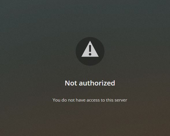

July 25, 20215 yr I keep getting "Not Authorized" error when I try to install a new (second) instance of plex (using the linuxserver repo). My main server works fine. Anyone know how to solve this?
July 25, 20215 yr Do you need a new PLEX_CLAIM? EDIT I can also confirm that when using Jellyfin docker container, hardware transcode and tone mapping works correctly on my hardware, so the issues are with Plex, this docker container or a combination. Edited July 26, 20215 yr by Presjar

July 27, 20215 yr On 7/25/2021 at 7:25 PM, Presjar said: Do you need a new PLEX_CLAIM? Maybe? But there is no setting for a PLEX_CLAIM token? How do I do it?
July 28, 20215 yr 8 hours ago, nerbonne said: Maybe? But there is no setting for a PLEX_CLAIM token? How do I do it? Head to https://www.plex.tv/claim Add the code to the docker container in the environment section. PLEX_CLAIM= Start the container. You have to do this within 4 minutes of generating the claim code. You can see info on it here
July 28, 20215 yr 1 hour ago, Presjar said: Head to https://www.plex.tv/claim Add the code to the docker container in the environment section. PLEX_CLAIM= Start the container. You have to do this within 4 minutes of generating the claim code. You can see info on it here Worked good, thanks.
July 28, 20215 yr On 7/25/2021 at 5:25 AM, Presjar said: I can also confirm that when using Jellyfin docker container, hardware transcode and tone mapping works correctly on my hardware, so the issues are with Plex, this docker container or a combination. It appears almost nobody is running intel 11th gen processors with Plex since they don't even notice it doesn't work
July 28, 20215 yr 11 minutes ago, arturovf said: It appears almost nobody is running intel 11th gen processors with Plex since they don't even notice it doesn't work Not really surprising. I dont know why anyone would buy the 11th gen for desktop over 10th gen. 10th gen offers more cores and is on huge sales. 11th gen has xe graphics though, but in that case its a negative lol. I just upgraded my servers and went for the 10th gen series specifically because i wanted the higher core count.
July 28, 20215 yr 13 minutes ago, sittingmongoose said: Not really surprising. I dont know why anyone would buy the 11th gen for desktop over 10th gen. 10th gen offers more cores and is on huge sales. 11th gen has xe graphics though, but in that case its a negative lol. I just upgraded my servers and went for the 10th gen series specifically because i wanted the higher core count. that might be true to i7's and i9's, but on the low end i5's there is a noticeable difference in performance! other additions are Pcie 4.0 (for faster nvme drives), extra x4 lanes on cpu (another nvme slot), dmi x8 with z590 platform and the new igpu graphics have more power to support more transcodings at the same time (if it was properly supported on Plex of course). In my case since I'm upgrading from 7th gen it doesn't make sense buy a 10gen Edited July 28, 20215 yr by arturovf
July 28, 20215 yr 1 hour ago, arturovf said: It appears almost nobody is running intel 11th gen processors with Plex since they don't even notice it doesn't work I got an 11500 and Plex is HW decoding everything now even with HDR. This was broken before, but now it's working fine. What exactly is not working for you? Is the igpu not recognized or do you have an other issue?
