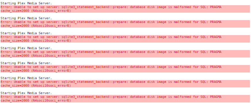

On 9/22/2021 at 5:23 PM, tooviral said:
Hello,
Tryin to repair the database and not sure how to stop plexmediaserver in the docker img.
Tried "service plexmediaserver stop" doesn't work
Any ideas?
I am also very keen to know this so I can try and repair the .db!
