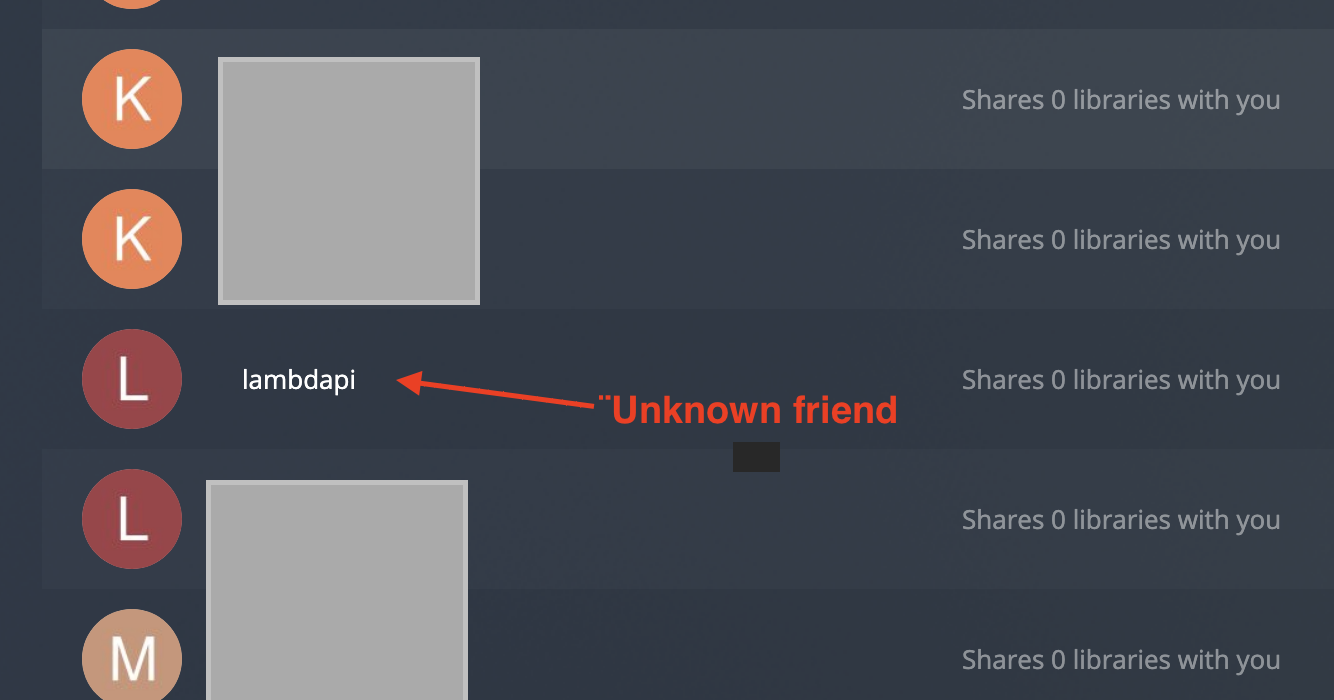

I realize my question is not unrad specific, but looking for help from any and all sources.  I'm running Plex on unraid in a docker. I have a recurring problem where unknown users appear in my friends list and they have share access to all my libraries. It doesn’t appear that these users every stream a file. I have deleted 3 users in the past and a new one popped up today. Not sure how this is happening. I switched to using 2FA for my account (with is the only admin account). Any suggestions would be helpful.
Link to comment
You should immediately log into you account at Plex.tv. From there unshare any libraries and remove all friends and family members select to logout from all devices. Change your password and disable and re-enable 2 factor authentication. Then optionally re-create family members and re-share libraries with friends and family.

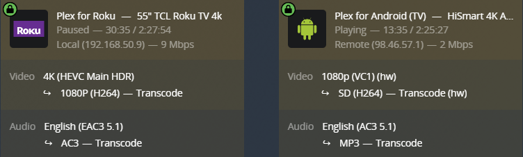

I'm trying to get Quick Sync working properly with Plex. I've got everything set up properly, however when I try to transcode a 4k file it always reverts to the CPU (a Core i7-9700K) instead of the iGPU like I want. However, when it's a non-4k file it works properly. See the attached screenshot.
Any idea how to get the system to transcode 4k like it does other content?
Update: Upon experimenting, it seems if I disable Enable HDR tone mapping everything works fine, however the colors are muted a bit and don’t pop like they should.
Update 2: It's Plex. After a lot of searching I stumbled upon a post in the Plex forum. Rolling back to version 1.25.1.5286-34f965be8-ls91 fixes the problem.
Edited by thunderclap
Update 2
Link to comment
Yes, there's a bug right now with HDR tone mapping and HW transcoding (again, had this problem in the spring 2021 as well). But for me downgrading PMS doesn't work now.
/Söder
Link to comment
Christmas came this year, I reported the issue to the devs and the tonemapping issue is now fixed, latest update came out yesterday.
