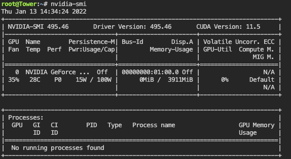

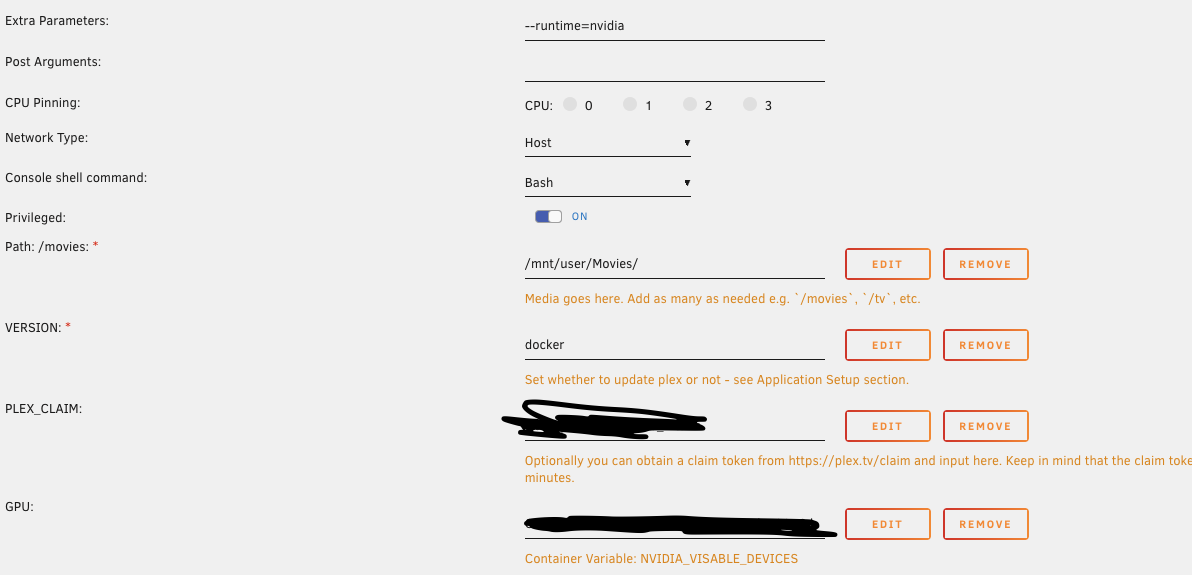

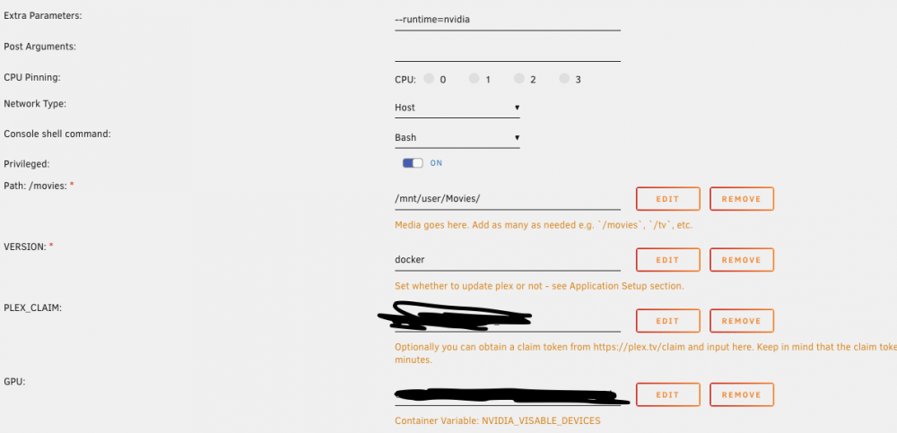

Hi I just purchased a Nvidia Geforce GTX 1650 super in hopes to use it in my unraid box (6.92). I have read through many forums etc re using the Nvidia plugin using 4.95.46.  I have made the  changes in Plex docker.1347756299_ScreenShot2022-01-13at16_08_06.thumb.png.5f6c2bccaa12bf38060b52eafb9cab1d.png

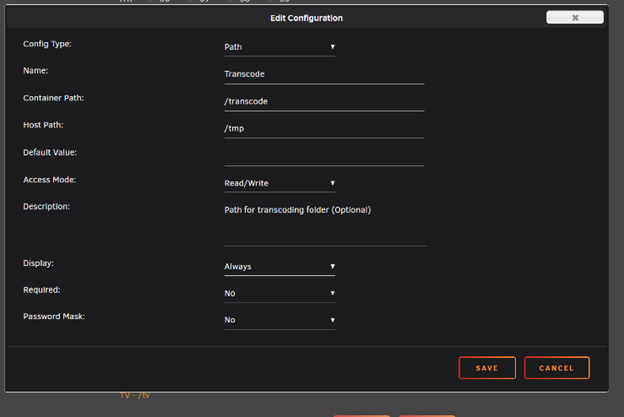

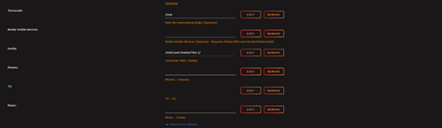

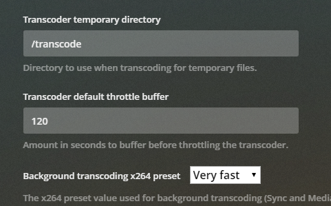

Good evening all i am back and have re-setup my plex docker, i am interested in ram transcoding and there seems to be several methods out there i just want to make sure i have done this right by sharing screenshots here.
Edited by Sinister

Hi Guys,
I'm a little bit on the fence of where to post this.
So lately, my plex has been acting up. It seems nvidia transcoding is broken somehow... When I start a stream, direct play works fine. However, when i'm trying to transcode (on multiple devices), it some times fails, some times doesn't fail.
Jan 23, 2022 12:01:39.138 [0x147113c6bb38] Debug — Request came in with unrecognized domain / IP '87.210.69.115' in header Host; treating as non-local
Jan 23, 2022 12:01:39.139 [0x147111e9cb38] Debug — Request: [192.168.1.1:1560 (Allowed Network (WAN))] GET /video/:/transcode/universal/start?hasMDE=1&path=%2Flibrary%2Fmetadata%2F31691&mediaIndex=0&partIndex=0&protocol=http&fastSeek=1&directPlay=0&directStream=0&subtitleSize=100&audioBoost=100&location=wan&maxVideoBitrate=20000&directStreamAudio=0&session=g93r5ria7a67nsgbkeu8ksk7&offset=10&subtitles=auto&copyts=1&Accept-Language=en (18 live) TLS Signed-in Token () (range: bytes=0-)
Jan 23, 2022 12:01:39.139 [0x147111e9cb38] Debug — [Transcode] Found session GUID of g93r5ria7a67nsgbkeu8ksk7 in session start.
Jan 23, 2022 12:01:39.140 [0x147111e9cb38] Debug — [Transcode] TranscodeUniversalRequest: using profile Plex Desktop

Jan 23, 2022 12:01:39.173 [0x147111e9cb38] Warning — [Transcode] Denying access due to session lacking permission to transcode key /library/metadata/31691
Jan 23, 2022 12:01:39.173 [0x147113c8eb38] Debug — Completed: [192.168.1.1:1560] 400 GET /video/:/transcode/universal/start?hasMDE=1&path=%2Flibrary%2Fmetadata%2F31691&mediaIndex=0&partIndex=0&protocol=http&fastSeek=1&directPlay=0&directStream=0&subtitleSize=100&audioBoost=100&location=wan&maxVideoBitrate=20000&directStreamAudio=0&session=g93r5ria7a67nsgbkeu8ksk7&offset=10&subtitles=auto&copyts=1&Accept-Language=en (18 live) TLS 34ms 265 bytes (range: bytes=0-)
The error tells me there's permissions issues. But the weird thing is, if I turn off hardware transcoding, all is well.
things i've done:
 - remade the transcode folder, switched it to a folder on the cache, switched it onto the ram. no dice
 - spun up another plex container, no dice
 - spun up a jellyfin container, this works, but i think jellyfin handles the transcodes differently.
I'm at a loss, especially because it sometimes works, but most of the times it doesn't.
Any help would be really appreciated
