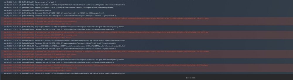

**edit**

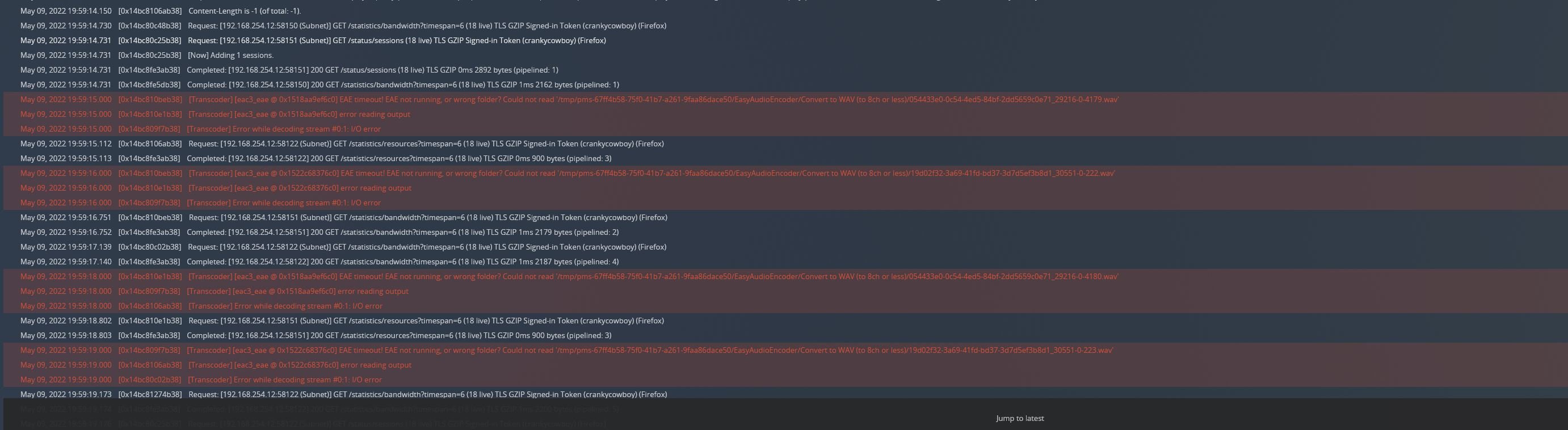

I may have found something related. I went into the plex console and am seeing the attached error.
I also found this post where it states that it could be related to my transcode folder (which I didn't specify in the plex container settings as I thought I read it was no longer needed). It also mentions deleting the codecs folder in the Plex appdata folder. Does any of that make sense? Here is the discussion I found:

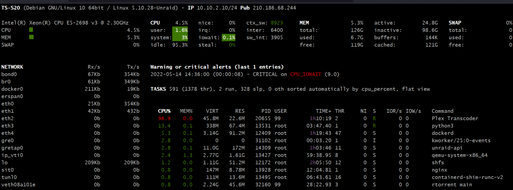

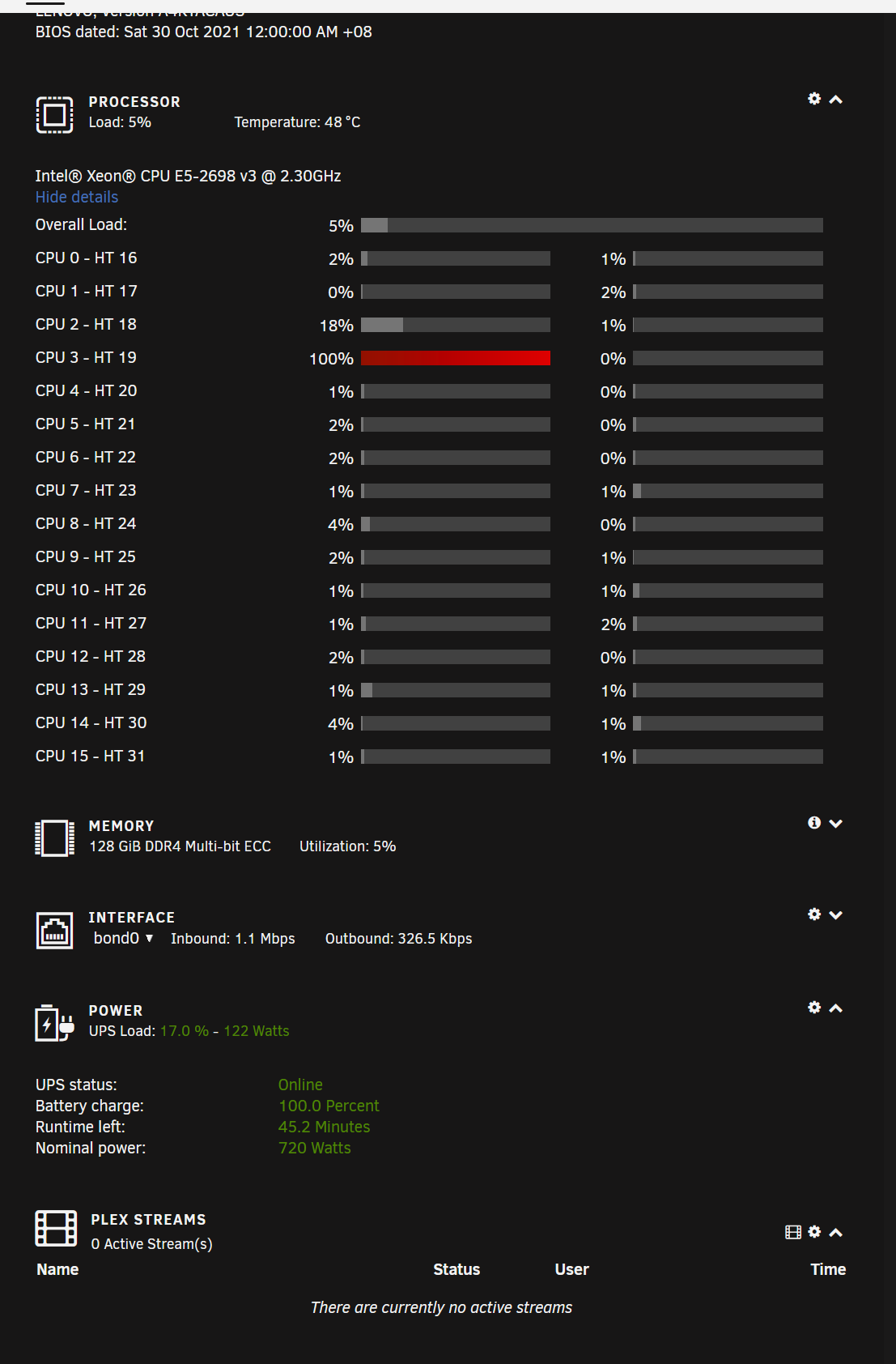

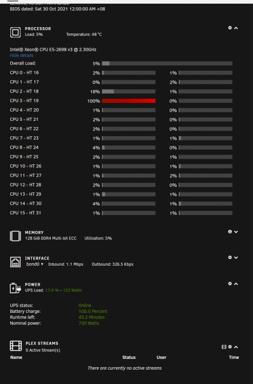

Need some help.
Recently i notice that my CPU had been spiking from time to time and i notice that my Server are drawing over 50W of power during idle.
Ive check what application is using my processor on Glances and notice that Plex Transcoder are there but i notice that plex are not streaming anything i've even open plex server and notice there is no task running on plex dashboard.
What's might be wrong with Plex here anyone could help please.
image.thumb.png.d4c72ee716c1acc4f45907986fb501eb.pngimage.thumb.png.3bcb42239b7169984aa6d80ef4489228.png

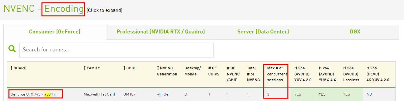

Guys,
I have a GTX750ti that is about to be replaced.  Thrown into an i7-2600 unraid/plex server, would it help with plex transcoding, particularly taking 1080 streams and transcoding to 720 for remote users at 2-4mbps?
Thanks.
if you talk about using the igpu from the i7 instead, its a pretty old cpu when i see correctly, sandy bridge, it can decode/encode AVC (x264) only, so when your source media is AVC only, yes, should be ok, hevc will not work in hardware on this igpu.
same for your GTX750ti ...

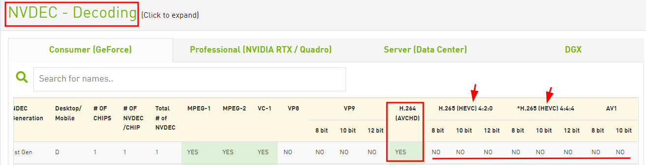

only you know in which format your media's are at home, if they are AVC (x264, h264, ..) then yes, both of your pointed devices (GTX750ti and you iGPU from sandy bridge) would be capable todo this ... while the Nvidia Card (NVENC) is limited to 3 simultan streams (been 2 before, but meanwhile its 3)
Nvidia Matrix ...
here the encodings for your card
while HEVC (modern Format) is not even decode supported (hardware accel reading ...) so lets say all 4k's will be a pain ...
