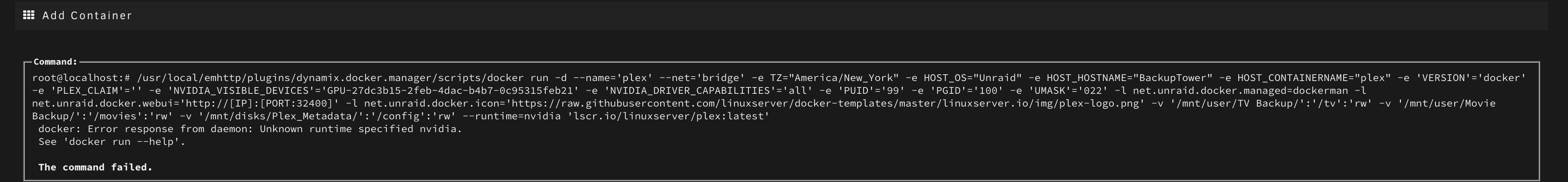

For some reason my Plex docker will not start now, this is the output whenI try to start it.
 Not sure why it is saying unknown paramater 'Nvidia' I've had a p2000 card in my server working with Plex just fine for ages.
I managed to get Plex running by removing the Nvidia parameters and am currently using Quicksync, just not sure what happened to the Nvidia plugin or driver?
Any help would be appreciated.
Managed to get the Nvidia driver reinstalled and everything is back to norma, was just spooked as this has never happened to me in using unRAID for 6 years and at least four with this P2000.
I had the same thing happen when I went from 6.10.1 to 6.10.3 - The nvidia plugin had to be deleted and re-installed. once that was done, I would get this error. An extra reboot (likely so the NVidia driver can load properly) fixed it and I was able to re-add the Plex docker container from the old template.
