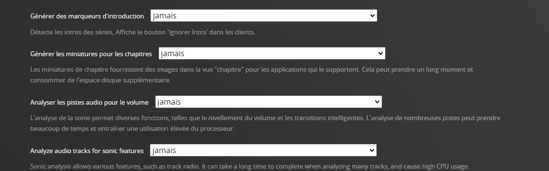

Man I had the same and been spending a week on it, but found the solution for my situation yesterday.
Turns out it will do this when you hit the api limit/download quota on your Google drive mount which you use for your Plex.
I was rebuilding libraries, so it can happen, but this was too often for me.
Turned out Plex Server had the task under Settings > Libraries  for chapter previews enabled on both when adding files and during maintenance. This will make Plex go through every video and create chapter thumbnails.
Once I disabled that the problem was solved  and Plex became responsive again.
Mmm interessting
So i put mine on never it was all on planified task
I will check to see if it helps
But the fact you're telling me about the api /Ban make sense also
thx

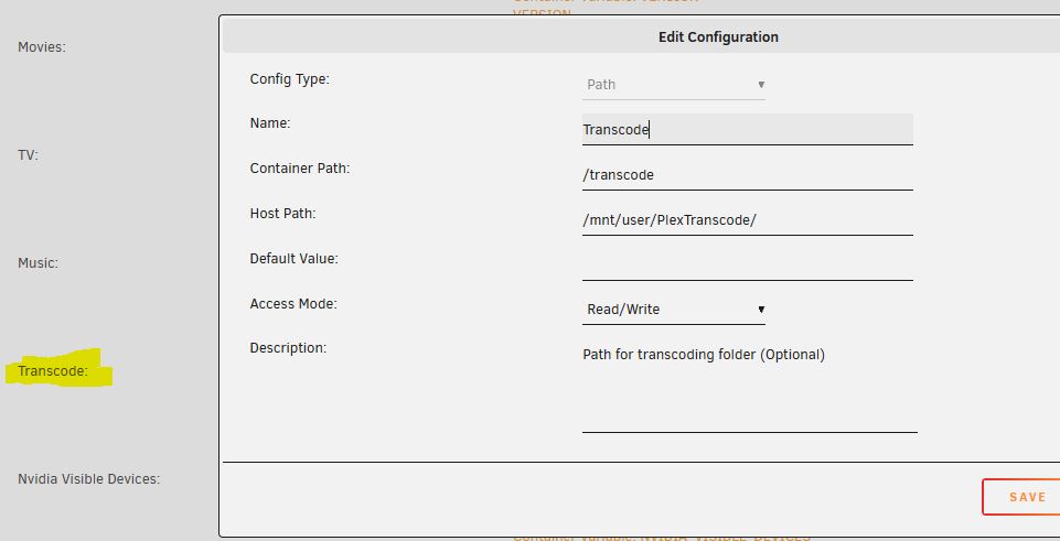

In my plex docker template, there is no path mapping for the transcode folder.
Hardware transcoding works, and if I open a docker console, the folder "/transcode" exists and contains session data.
My question is to know where is this /transcode folder: on RAM ? on disk ?
Thanks
i would say you answered your question yourself ...
its in your docker image (path) whatever you use there but surely not in RAM, if your intention is todo so, follow the guides you find here already ... there are several ways, /dev/shm ... /tmp ... create a tmp ramdisk ... whatever you wish you ll find it ;)
Interesting.  There is one in my linuxserver.io Plex template.  In mine, I have it mapped to a share that exists on an old, waiting to die SSD.  It would be just sitting in a drawer if I didn't find a use for it.
In Plex, the Transcoder temporary directory is set to /transcode.

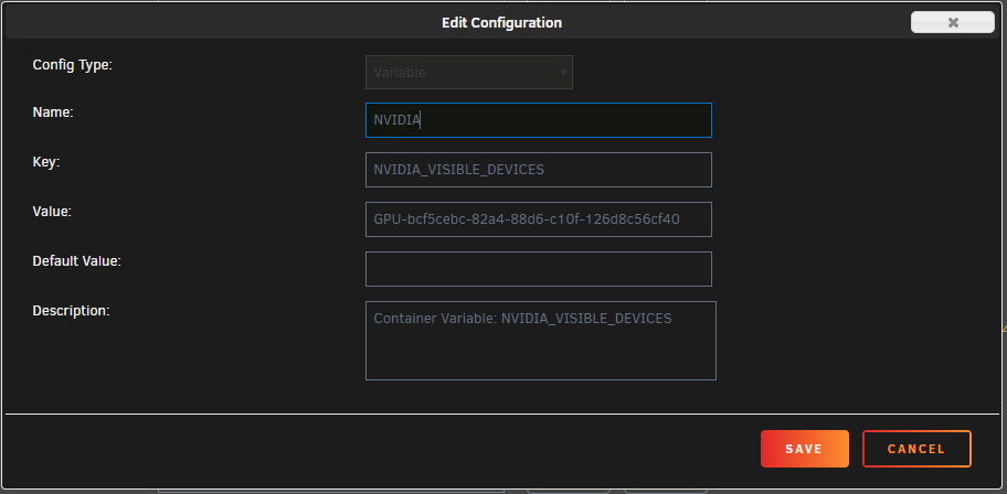

On 9/7/2022 at 3:52 AM, Addy said:
The NVIDIA visible devices has gone from the template? or am I missing something? My container failed during updating.. maybe because this option doesn't exist, but I'm not sure.
Manually adding the variable worked for me, but figured I should report it..
I'm having this same issue. I tried manually adding the variable but it didn't work. Can you post a screenshot of your variable settings?
@Addy thanks for your reply. I was able to make it work after rebooting my server. I had the variable set correctly but it wouldn't work until after the reboot for some reason.
